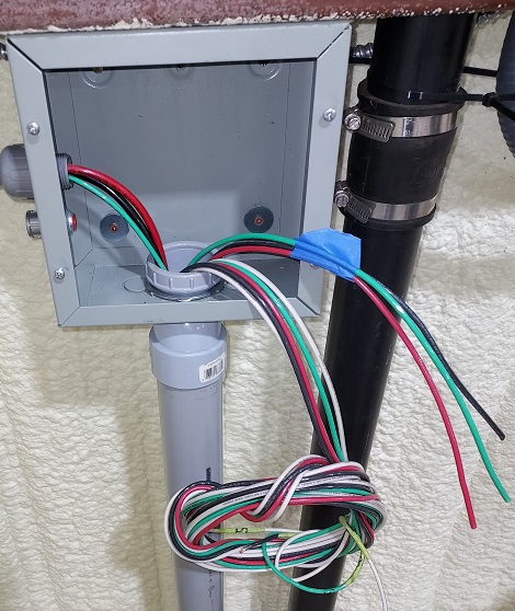

wire pulling

wire pull

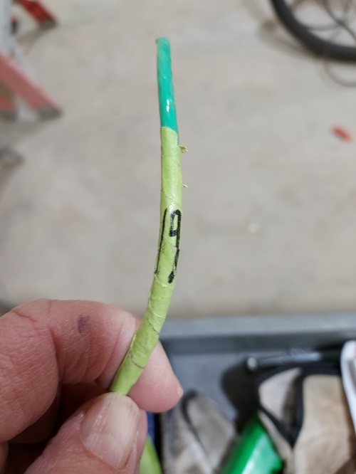

They say never mark your wires because they will be all gone when ya get to the other end after the pull. Catching on fitting edges etc. And just figure it out after the pull. I labeled them and they all survived but one ground. Here is number 19. Easy fix to figure which ground it was on the other end. D

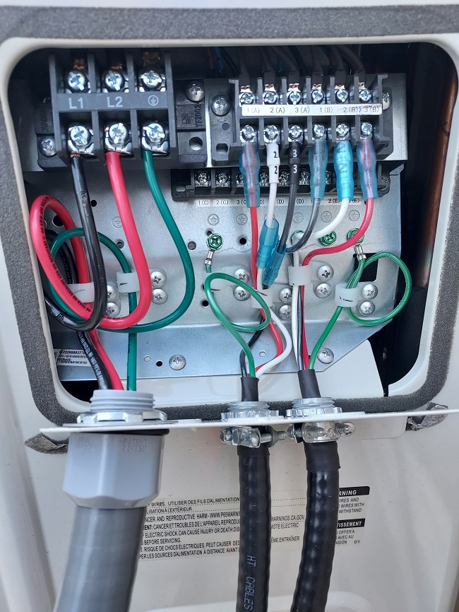

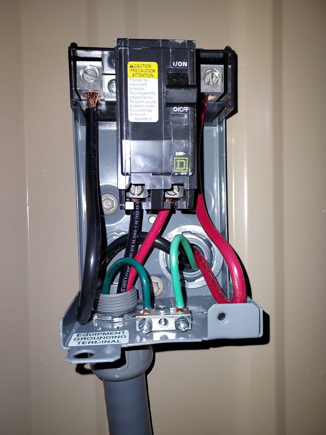

Tied in all the line sets and tested for leaks. Wired the air handlers into the double stacked condenser unit. Pulled the wires outside into the disconnect box and wired it. Ran the pigtail to the condenser. Turned on all the power and test ran both air handlers. All good to go!

Had to order an extra 50-foot line set and a coupler kit. So I have one unit on each end at 9 feet high. Air Handlers come with 25 footers. Aldo got a 75-foot control cable. I need to insulate all the line set joints. Maybe next week. Going to be in the single digits the next 3 or 4 days. Then I will finish zip tieing all the control cable etc. nice and sano. Now I can have heat in the shop while I finish some wiring and get ready to start moving things in. Can't wait for the picture of the 2 4-post lifts set-up and everything in place. Danny
