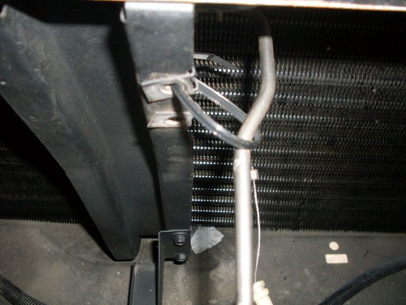

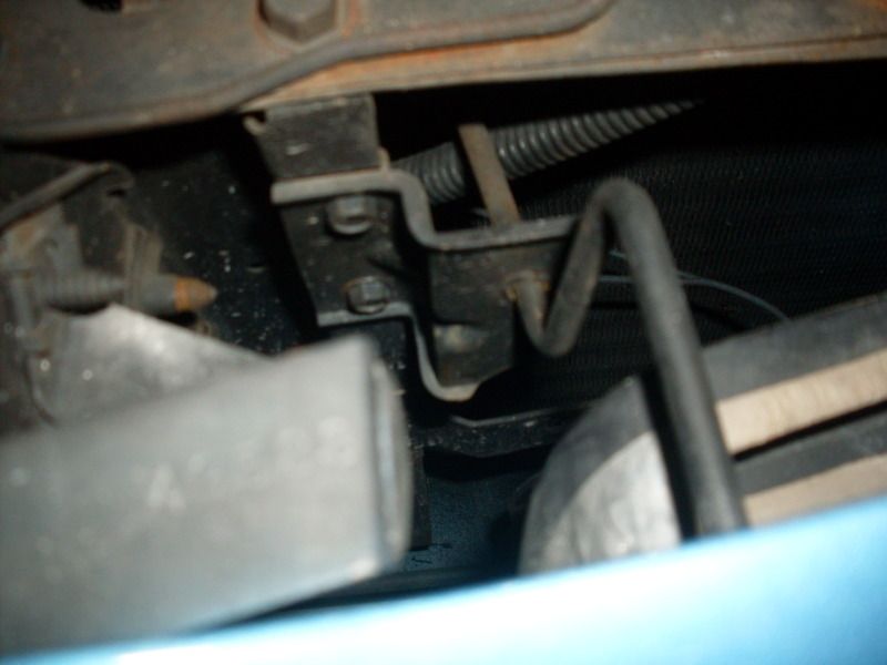

Found some more stuff I need:
1) The little bracket/tab/guide plate that holds the hood release pull bar in position.
Here is the shot of what is on my Gramma's 75 Firebird:
http://i599.photobucket.com/albums/t...c/SDC11343.jpg
And the spot where one should be on my 72 (I removed the bracket he had installed for the inside hood release as it doesnt line up with the original location for the metal pull bar).
http://i599.photobucket.com/albums/t...c/SDC11342.jpg

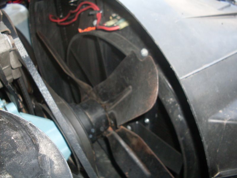

2) I also need a clutch fan blade for the 72 since the prior owner had installed an electric fan and a solid mounted fan blade on the engine.
http://i599.photobucket.com/albums/t...c/SDC11344.jpg

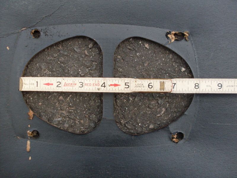

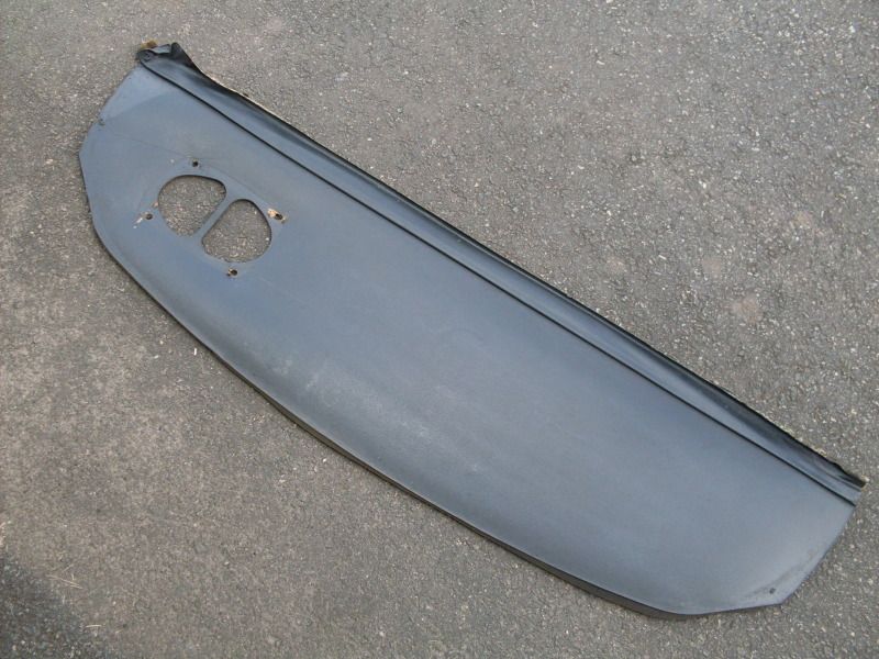

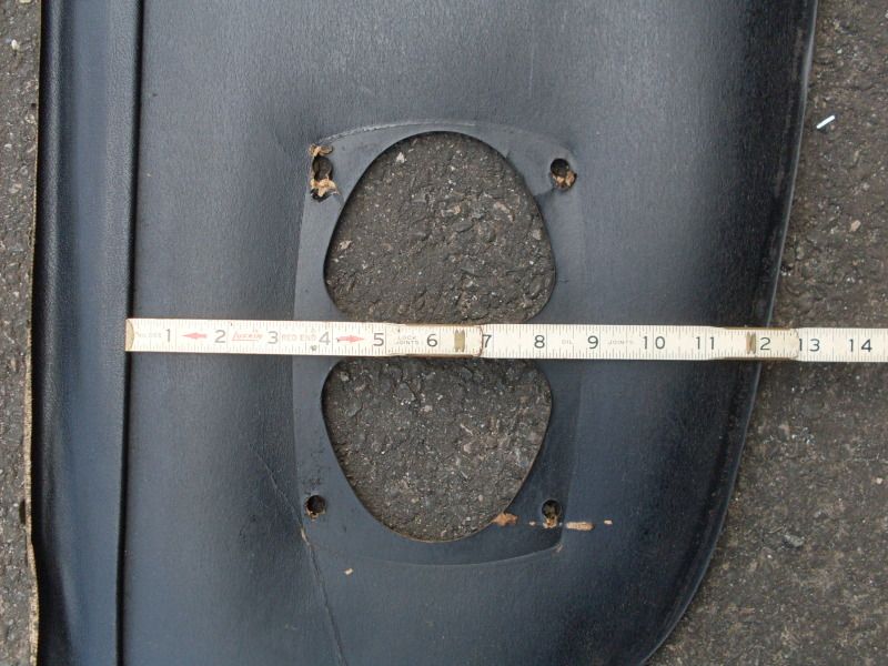

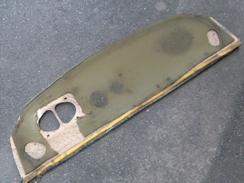

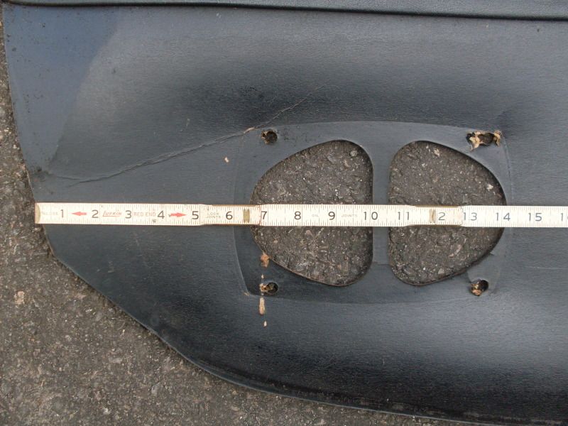

And here is something for the archives: an original rear package tray. Looks like I was the first person to ever remove this thing from the car. Very interesting cutout for the single rear speaker with the center bar between the cutouts. The other funny thing is that the factory punched speaker mounting holes were all 1/2&quot; too narrow. The factory speaker grill studs had to slot out the carboard holes 1/2&quot; farther than the outer holes in order to line up with the factory stamped holes in the rear deck.

----So the question is; Do you do the new package tray the same way???......Bill S
njsteve 06-08-2012 01:01 PM
Re: The New Project: Part Deux!
Yup. I placed them on top of each other and traced the outline of the opening and the mounting holes with a pencil. I also placed the new package tray on the rear deck and traced the outline of the stamped holes in the rear deck. They all lined up nicely.
Interestingly enough, the four factory stamped stud holes in the rear deck are a circular stamp with a slot that lines up with the slots in the cardboard package tray. Looks like a little lack of communication from the engineers and the manufacturers back in the day. [img]<<GRAEMLIN_URL>>/grin.gif[/img]

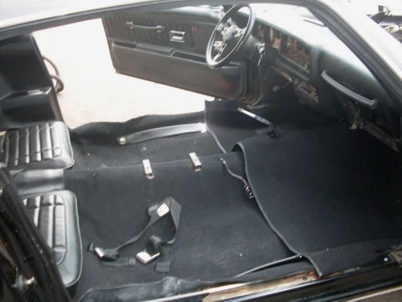

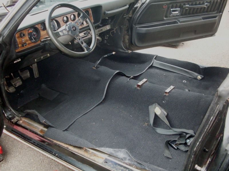

njsteve 06-10-2012 02:18 AM

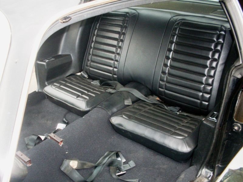

Started putting the interior back in the car today. Lots of tugging and maneauvering to get the new carpet in the right spot and locked down in place. Running from one side to the other constantly to make sure I didn't pull too far and have the other side short of the sill plates (one bitten, twice shy). I tossed out the old carpet because it reeked of the ziebart/cosmoline rust proofing goo that was all over the floorboards and trunk. Now the car no longer smells like a refinery inside. [img]<<GRAEMLIN_URL>>/sick.gif[/img]

Here is the current progress:
http://i599.photobucket.com/albums/t...c/SDC11365.jpg
http://i599.photobucket.com/albums/t...c/SDC11367.jpg
http://i599.photobucket.com/albums/t...c/SDC11366.jpg
