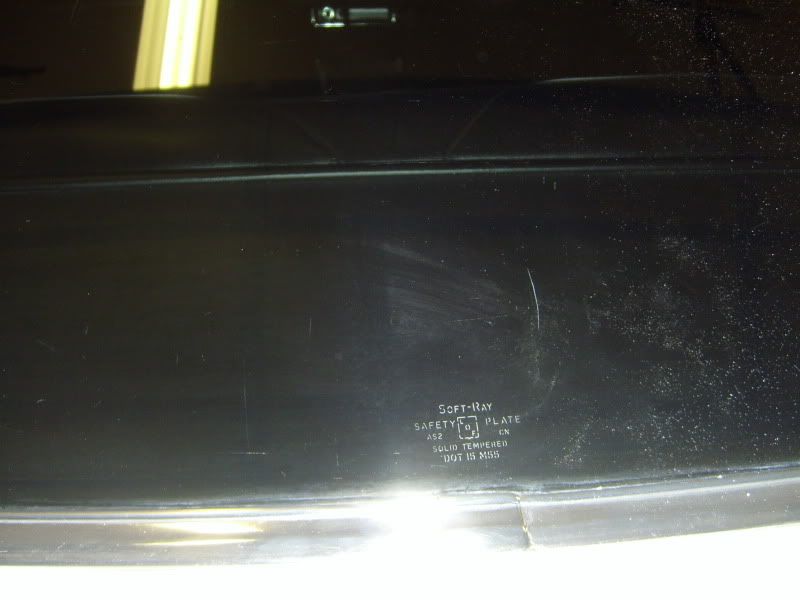

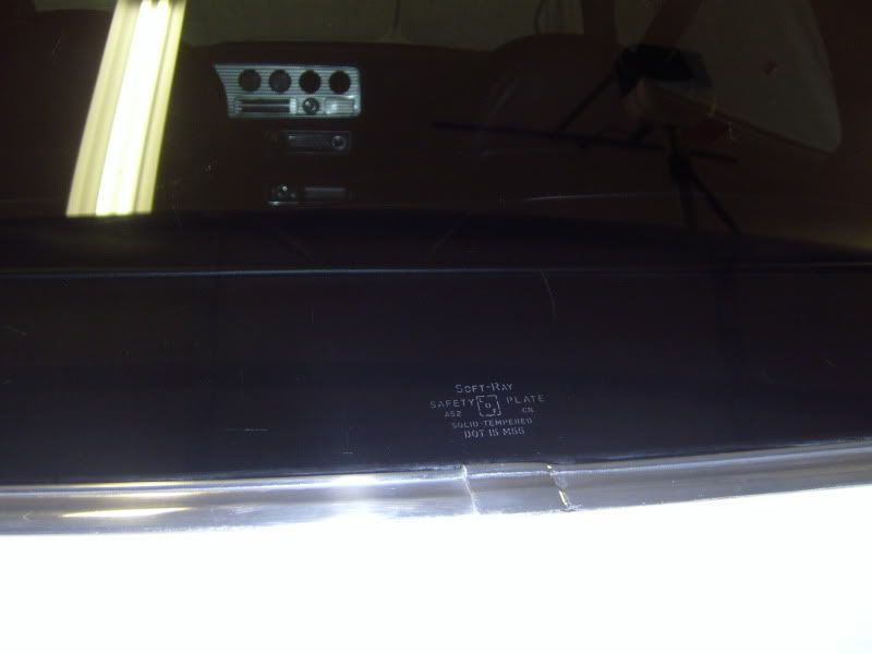

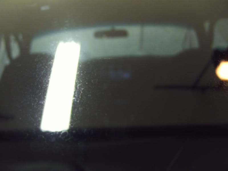

Here's the acid rain waterspots that up til were impervious to everything I tried: clay, rubbing compound, 0000 steel wool, 80 grit on a DA sander...
http://i599.photobucket.com/albums/t...aterspots1.jpg
http://i599.photobucket.com/albums/t...waterspots.jpg

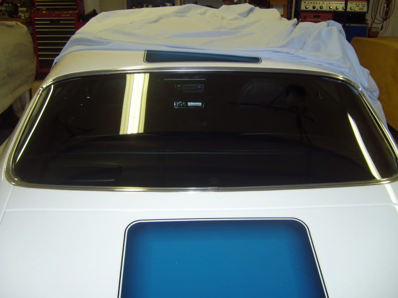

And the final result after about thirty minutes of effort:
http://i599.photobucket.com/albums/t...68c/after2.jpg
http://i599.photobucket.com/albums/t...268c/after.jpg
The stuff actually works great. After the glass cleaning, I did then have to re-polish the aluminum window trim with a quick application of Simichrome but that was no big deal.
