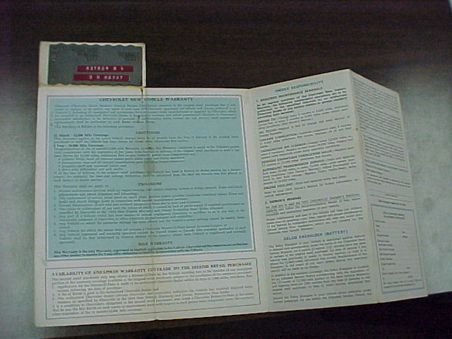

This is the reply I got form the seller.
"HERE ARE PICTURES OF THE PROTECTO PLATE. I HAVE A COMPUTER PERSON THAT DOES MY EBAY LISTINFS FOR ME. THE BUILDSHEET IS A REPLICA. HE LOOKED AT IT THINKING IT WAS THE ACTUAL ONE, NOT KNOWING THE DIFFERANCE FROM AN ORIGINAL AND A REPLICA. LET ME KNOW IF YOU NEED ANYTHING ELSE. THANKS. JIM"
1970ChevelleSS 05-19-2005 06:46 PM
Re: What do you guys think of this chevelle?
1 Attachment(s)
He also sent me a picture of the pop but I do not know how to post it.
Mr. T 05-19-2005 06:48 PM
Email it to me Carmen, I'll post it for you.
Mr70 05-19-2005 06:53 PM
Ask him to ZOOM in on the metal plate portion.
These can be easily made today.
https://www.yenko.net/attachments/139808-MVC-063F.JPG
1970ChevelleSS 05-19-2005 07:12 PM
Is the pop supposed to have red tape isn't it supposed to be the gm tape?
