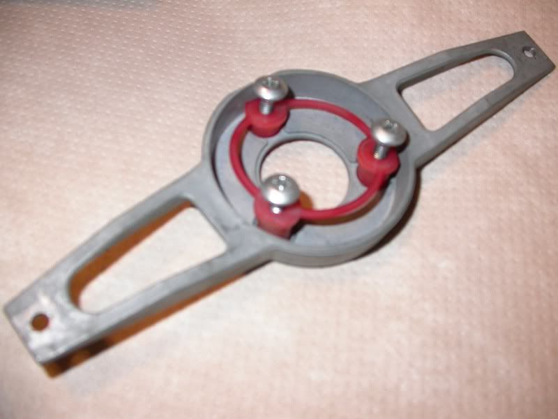

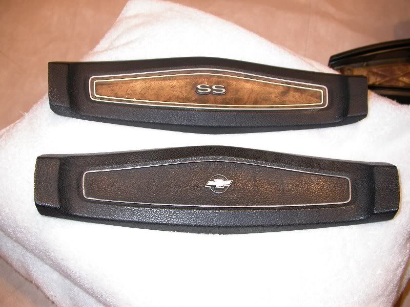

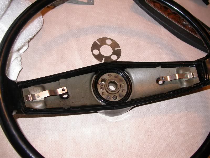

Pulled the old steering wheel off, and got the new one ready to go back on - I think these are all 1970 Camaro only parts -
http://img.photobucket.com/albums/v3...heelspring.jpg
http://img.photobucket.com/albums/v3...tersection.jpg
http://img.photobucket.com/albums/v3...eelshrouds.jpg

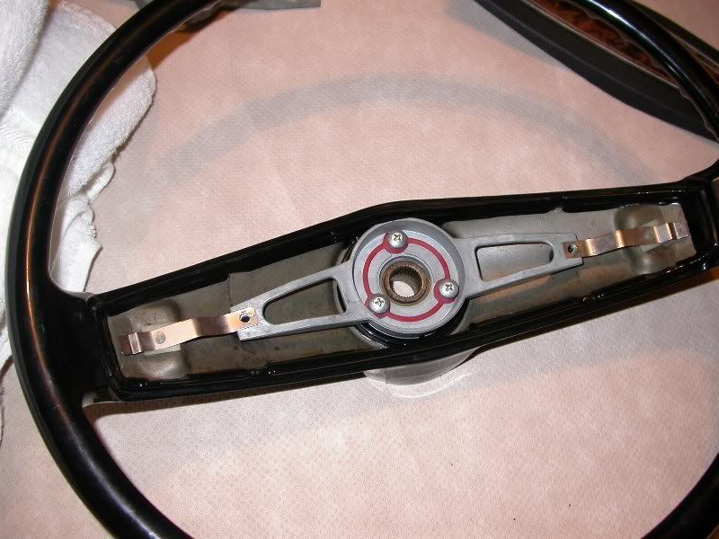

Here is the wheel all ready to be installed -
http://img.photobucket.com/albums/v3...ytoinstall.jpg
And here's the tilt column, only one thing is missing..
http://img.photobucket.com/albums/v3...olumnfor70.jpg
At 10:00 on the hub, you can see a plastic sleeve that carries a spring-loaded contactor which brings voltage from the column, through the wheel, and to the pot metal horn bar in the top picture, which is isolated by the red rubber washers.
Before I can install the wheel, I need to find one of these contactors - does anyone know what it is called or where I can get one?

TDW 02-27-2006 02:43 PM
Re: 1970 L78 Camaro Progress
http://cgi.ebay.com/ebaymotors/67-68-69-...617049117QQrdZ1
I think this is still available from www.gmparts direct.com.
Seattle Sam 02-28-2006 03:03 AM
Thanks Tony! GM parts direct has them for $1.70!
