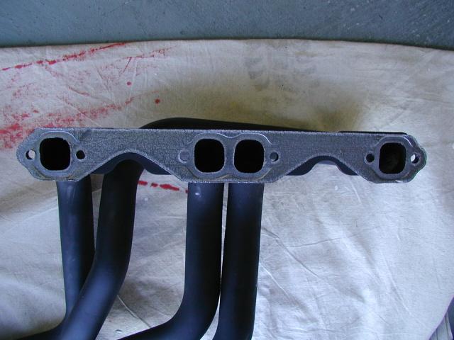

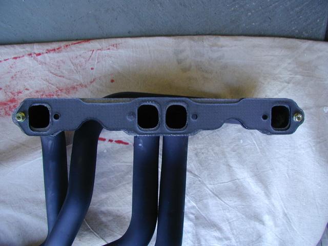

For those who may foolishly wish to make their own (for a 1st gen Camaro), here's what I did. Since this was an experiment, I wanted to use some fairly generic and inexpensive long tube headers as my starting point.
Short story: Hedman street headers, #65003.
Long version below (in case someone is considering buying a set of these Hedman headers):
Originally I wanted 1 5/8“ primary tubes with 3” collectors for my car, but ended up choosing 1.75” primary tubes instead. Not sure why I did that, but I wouldn’t go that direction again (at least not for my modification project).
Depending on whose ad you are reading, the Hedman cylinder head ports are described as square, round, oval or SAP (same as port). None of those are really accurate. The header ports are basically rectangles with rounded corners, and do not match the stock head ports. The gaskets supplied with the headers match the headers exactly and would give you only a fraction of an inch of gasket material at the top and bottom of each cylinder - perfect for blowing out. I chose to use some deluxe gaskets that matched the oem ports, which provided gasket sealing surfaces that matched the head ports and covered the header ports nicely as well. So far, so good.

Squished areas indicate stock ports.
https://www.yenko.net/ubbthreads/pics...hed_gasket.jpg
Hedman gasket laying over other gasket. You can see where the thin areas would be a problem.
https://www.yenko.net/ubbthreads/pics...man_gasket.jpg
