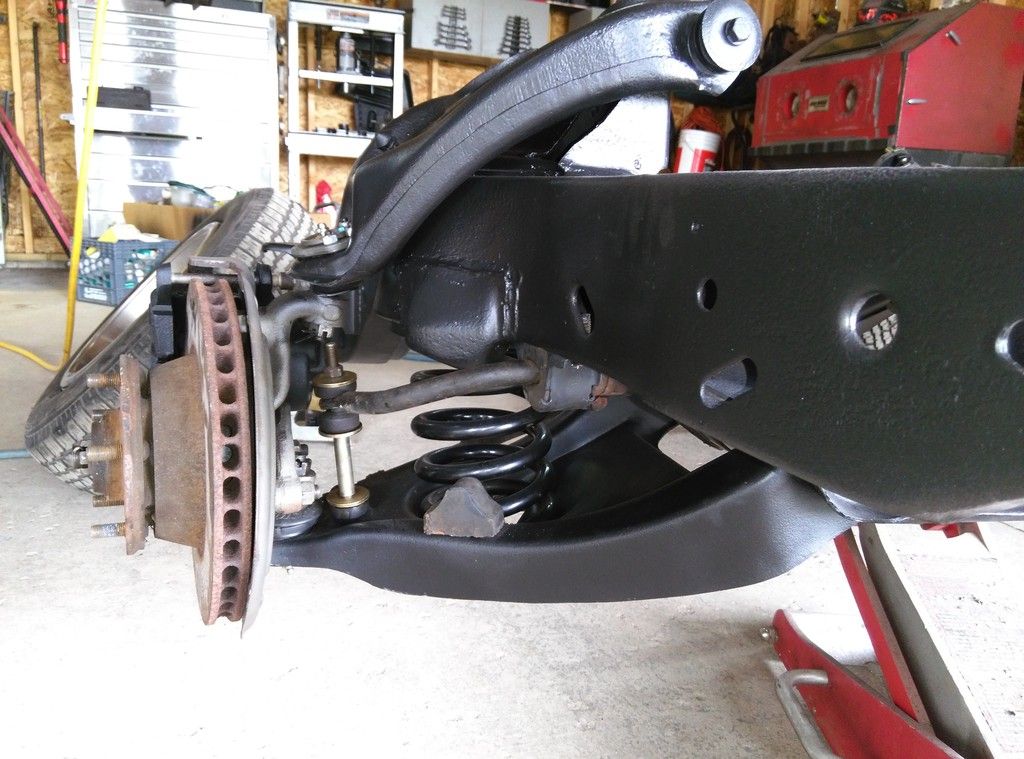

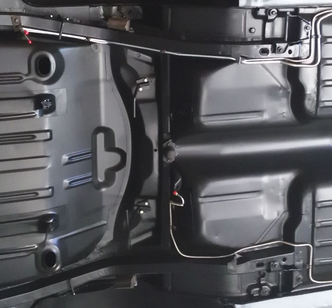

I ended up using SEM Trim black on my floor pan and sub-frame. I used it over PPG epoxy primer in gray. I couldn't be happier with the results. Here's how it came out.
http://i1164.photobucket.com/albums/...0_170343_1.jpg
http://i1164.photobucket.com/albums/...525_093906.jpg
http://i1164.photobucket.com/albums/...712_142204.jpg
