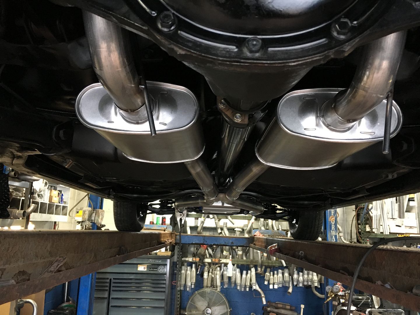

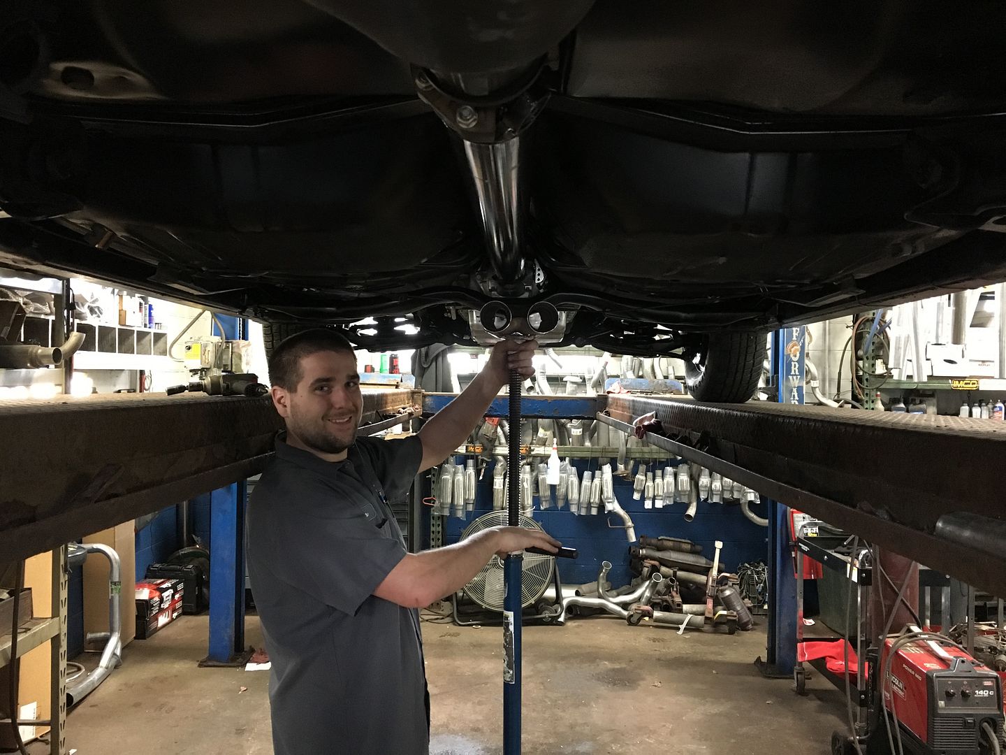

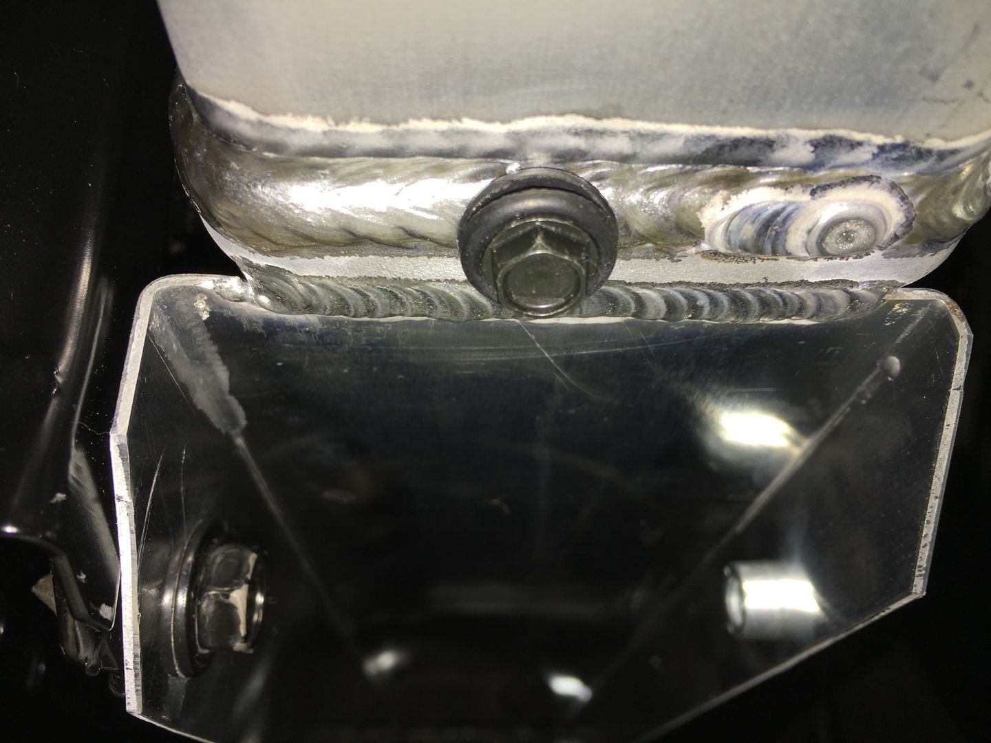

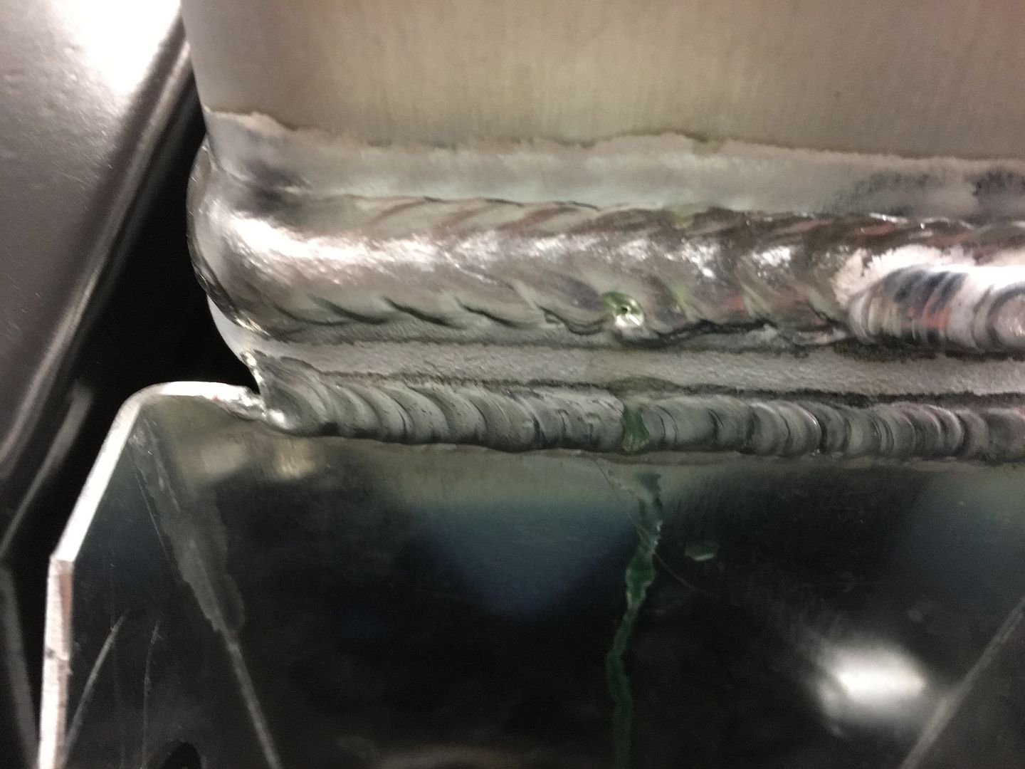

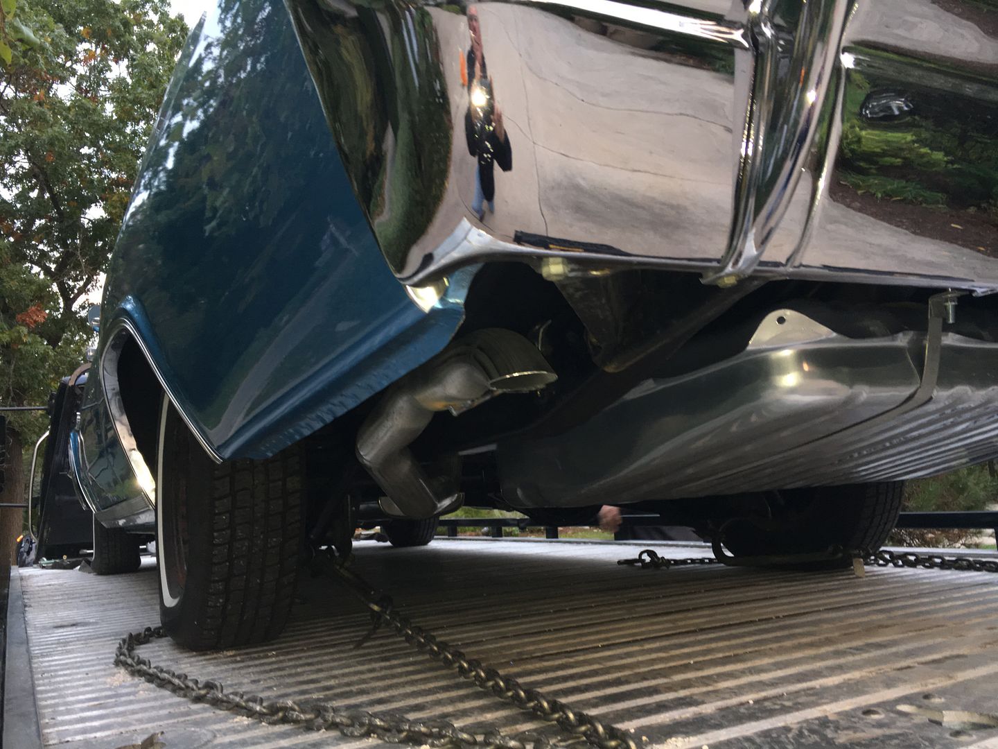

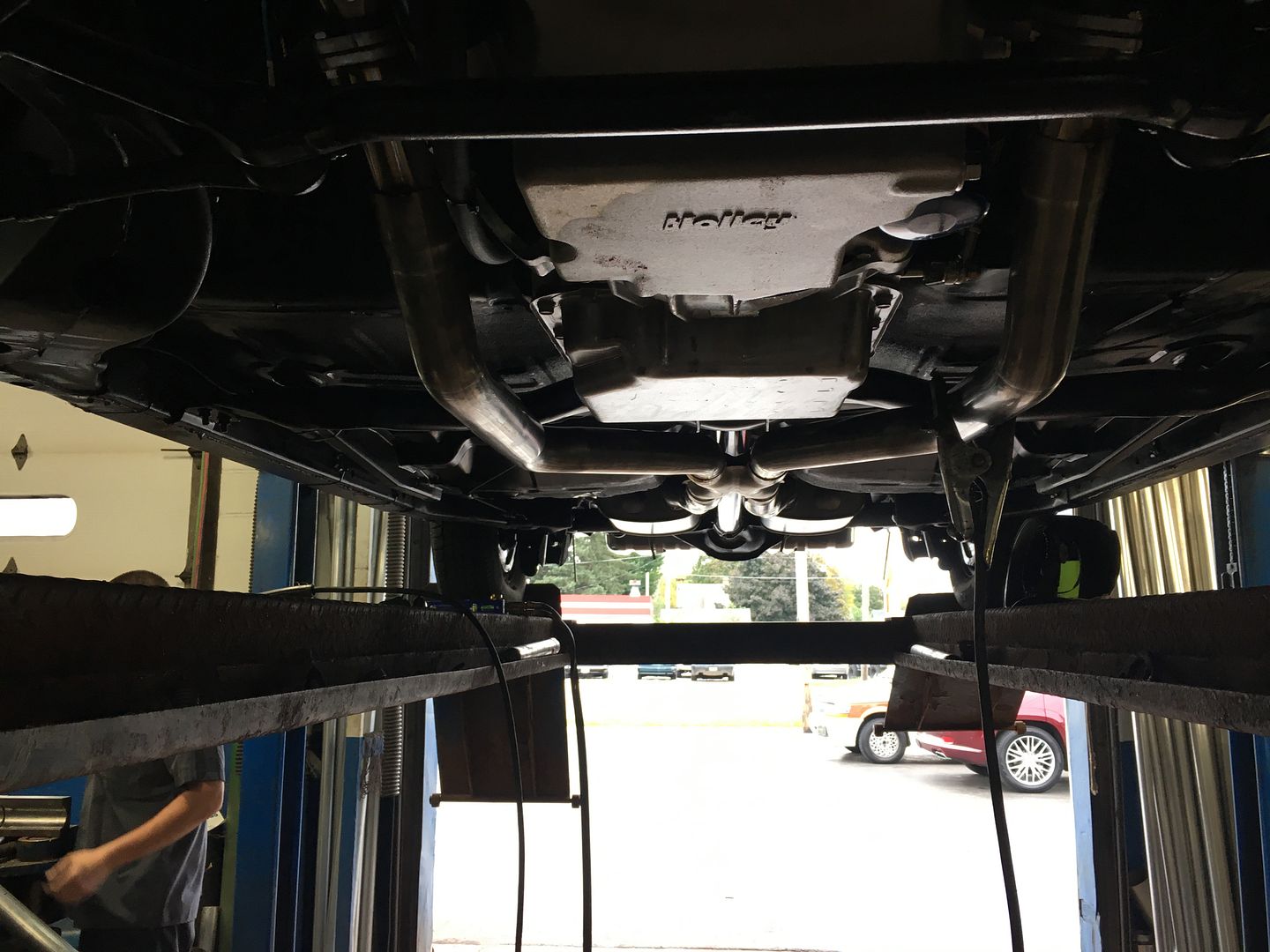

Exhaust is in and the car is back........Another great job by Dave's Mufflers in Kenosha.......James works his magic again
http://i13.photobucket.com/albums/a2...2956940BE2.jpg
http://i13.photobucket.com/albums/a2...C341C43008.jpg
http://i13.photobucket.com/albums/a2...6C462AC9E5.jpg
http://i13.photobucket.com/albums/a2...FEE5F30C8C.jpg
http://i13.photobucket.com/albums/a2...42BAFFE41A.jpg
http://i13.photobucket.com/albums/a2...51661D5CC6.jpg

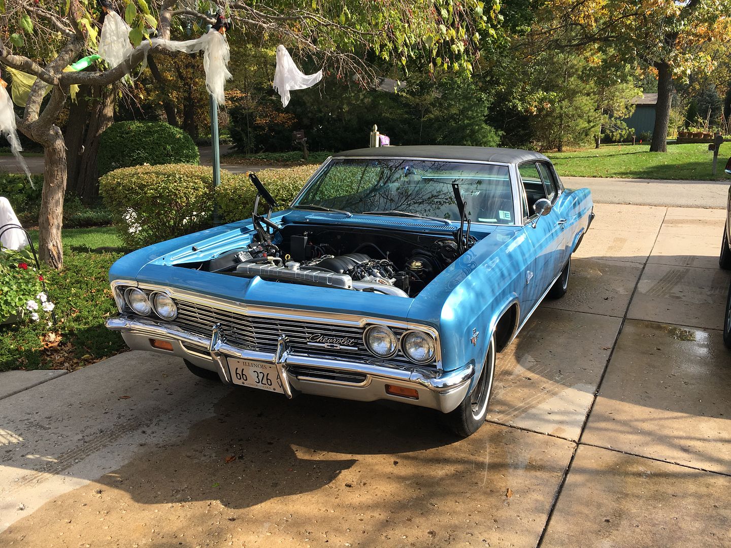

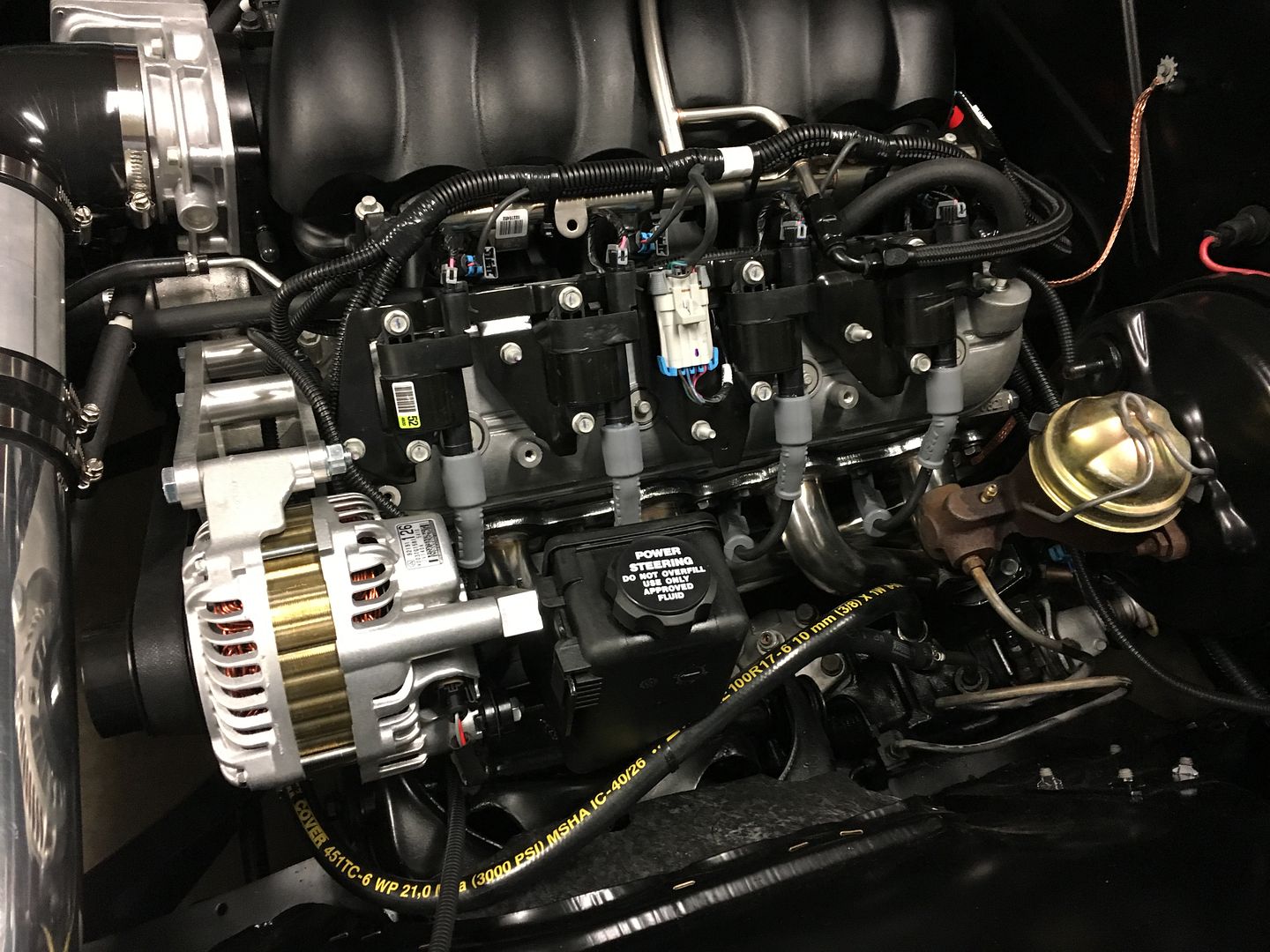

Got pretty much all the under hood wiring completed today......went to spin the engine over and found out the neutral safety switch is toast......Andy ordered a new one and that will be his winter project to install it.......LOL....Then we had a major disaster.......added coolant to the Radiator to top it off and come out the next morning and a puddle of coolant under the car......Humm !!!!.......Ended up being a pin hole in the Radiator weld seam..........Sheesh !!!!.......First we had Keith's car dropping dirt all over the place, now we have Andy's &quot;Leakasourus&quot; dumping coolant all over the place.........Time to call the Hazmat team again ............Time to get this &quot;Beater&quot; out of the garage......Andy is coming to drive it home next Saturday...........Put a self tapping screw with a rubber grommet thru the Radiator hole and tightened the screw squishing the rubber grommet to seal the leak till the new Radiator shows up and Andy can replace it at his place.......LOL
http://i13.photobucket.com/albums/a2...17BD51C87B.jpg
http://i13.photobucket.com/albums/a2...FF69C07999.jpg
http://i13.photobucket.com/albums/a2...EA4763C2E5.jpg
http://i13.photobucket.com/albums/a2...40B6D8A2BB.jpg
http://i13.photobucket.com/albums/a2...6D6853EE98.jpg
http://i13.photobucket.com/albums/a2...A7B716E7F4.jpg
Need to hook up the Vacuum line to the Brake Booster and everything else left to do is get all the Dakota Digital gauges and modules installed....Almost done.....Then off to SEMA to Relax.......

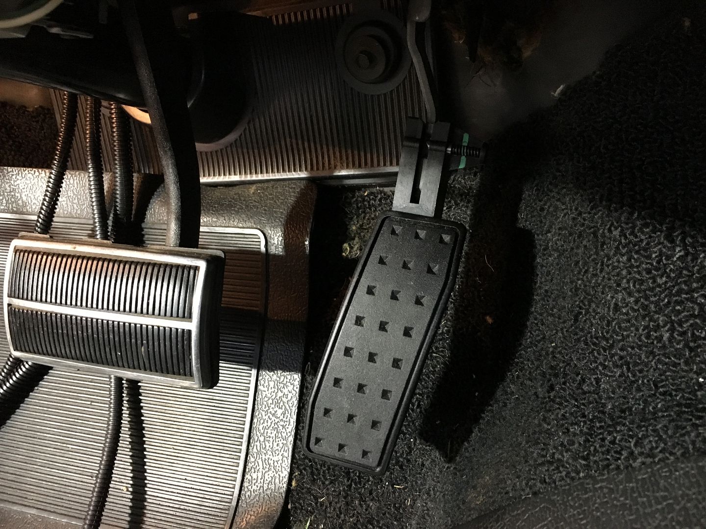

Getting started on the &quot;Inside&quot; car stuff this morning.........Got the Gas pedal installed and plugged in.....also took the Dash out to get the Dakota Digital install going......Again.....Look at the Dust on the dash assy.........Sheesh !!!......at least the dust fell inside the car and not on the floor.......
http://i13.photobucket.com/albums/a2...4129835C4B.jpg
http://i13.photobucket.com/albums/a2...3910C6BE92.jpg
http://i13.photobucket.com/albums/a2...528D516B9D.jpg
http://i13.photobucket.com/albums/a2...57CF91E6E9.jpg

427TJ 10-27-2016 08:04 PM
Re: Andy's 66 Caprice LS Conversion Upgrade
<div class="ubbcode-block"><div class="ubbcode-header">Originally Posted By: kwhizz</div><div class="ubbcode-body">
</div></div>
Love turn-downs like that, tucked up almost out of sight. Very sanitary.

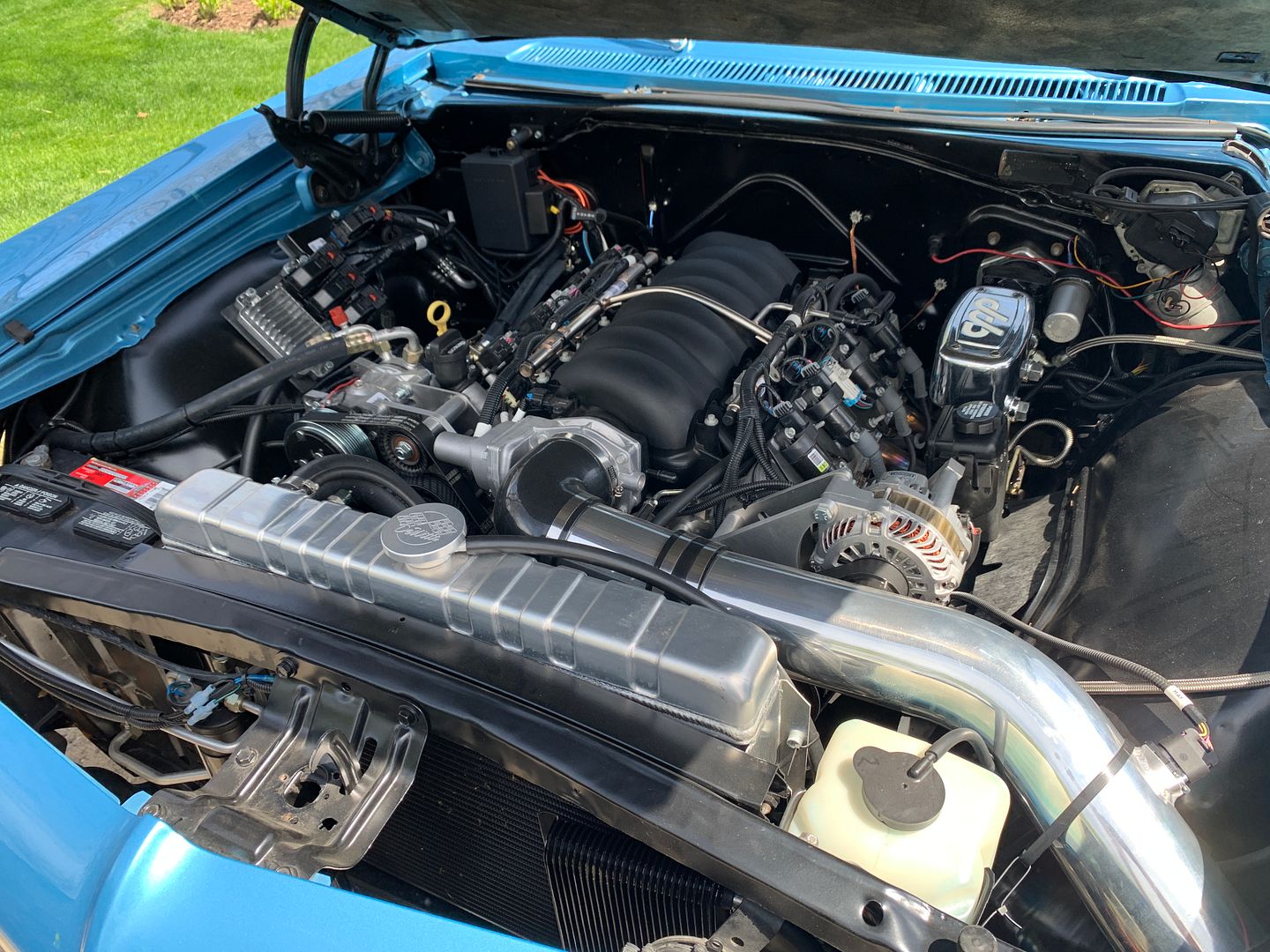

kwhizz 05-03-2020 07:05 PM
It is a beautiful spring day today..... Look who stopped by for a visit..... Andy !!!!!...….. All I can say is WOW!!!!...... Talk about finishing the car to the perfection Level..... A car guy that really gets it........ Here are some Pic's
https://i13.photobucket.com/albums/a...68B43DB081.jpg
https://i13.photobucket.com/albums/a...CCDEF14416.jpg
https://i13.photobucket.com/albums/a...94CEF1A375.jpg
