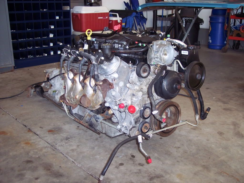

Hey, I appreciate the lead! I had gotten quite a bit cleaned up today in the engine compartment, installed the new trans crossmember, the new engine stands (frame to mount),removed the wiring harness,and installed the conversion mounts of the LS1. With some luck, perhaps I will have a chance to do the first trial of setting the engine in this week. I've got another slug of pictures for you guys that I will try to get posted tomorrow.

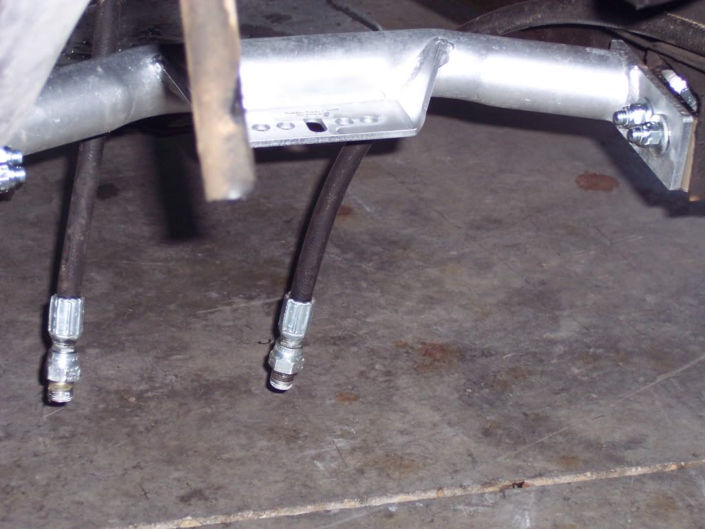

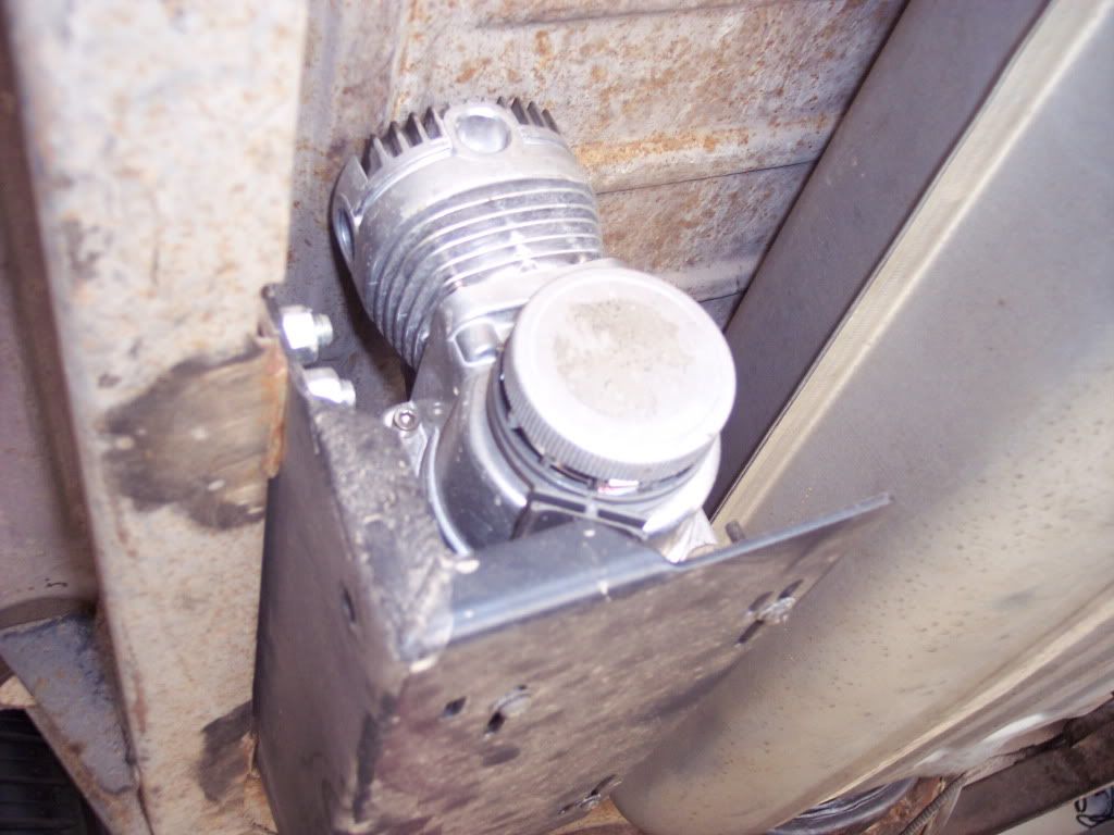

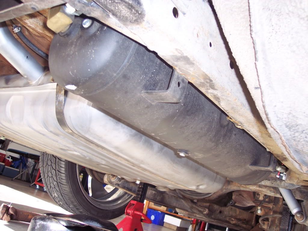

The Air Ride is in!. The tank and compressor are mounted underneath on each side of the fuel tank. This all was installed by the previous owner. He plumbed it with hydraulic hose rather than nylon for durability. I'll take some close up photos tonight or tomorrow. </div></div>
Here are the photos as promised on the Air Ride components.
http://i1043.photobucket.com/albums/...8/100_1719.jpg
http://i1043.photobucket.com/albums/...8/100_1720.jpg

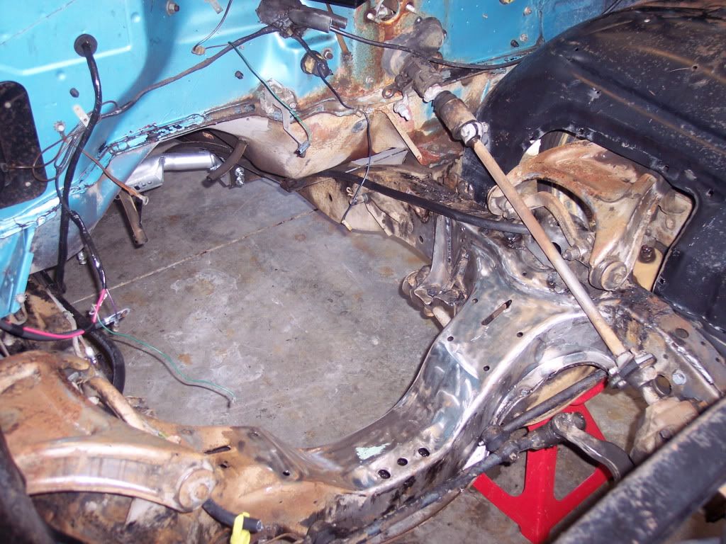

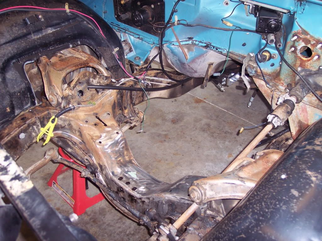

I posted a couple of pictures of the engine compartment. Would you guys leave it or refinish it? My buddy from Rad Rides was all over me to refinish it. Of course in the next breath he mentions an Art Morrison chassis to me! [img]<<GRAEMLIN_URL>>/sick.gif[/img] Hopefully tomorrow or Tuesday, I am going to set the engine and trans in to see how this all will work with the accessories, manifolds, ECM etc. I can make some decisions from there.
http://i1043.photobucket.com/albums/...8/100_1717.jpg
http://i1043.photobucket.com/albums/...100_1716-1.jpg
http://i1043.photobucket.com/albums/...8/100_1718.jpg
http://i1043.photobucket.com/albums/...8/100_1722.jpg
http://i1043.photobucket.com/albums/...8/100_1723.jpg
427TJ 11-01-2010 01:31 AM
Re: 1959 Bel Air Winter Project
I like the idea of a modern driveline and 50-year patina everywhere else. Put the LS in and then later if you decide to refinish the engine compartment you can.

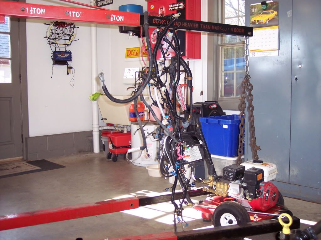

Man .......That car has lived a very protected life........As rust free as they come.......Now!!........Pack all those wires hanging from the hoist and ship them to Speartech.....If you need any help with anything, just let me know....

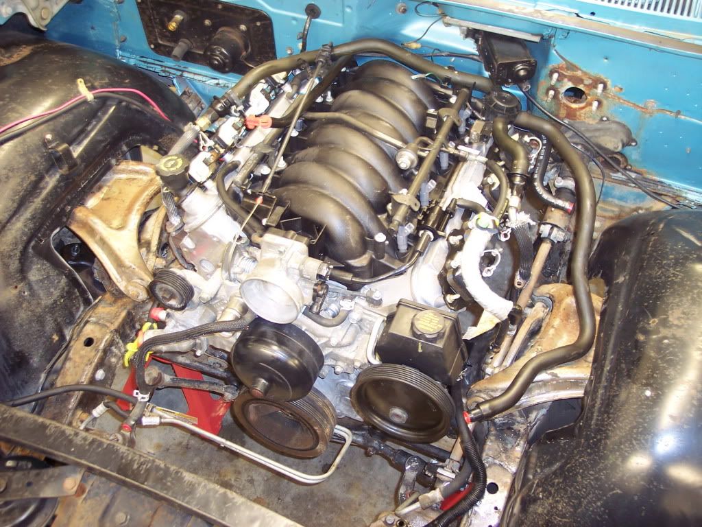

napa68 11-03-2010 03:43 AM

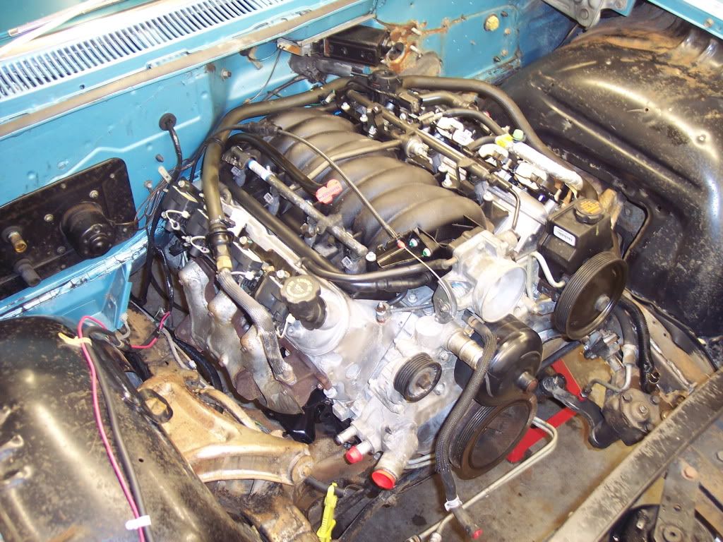

For tonight's work, I dropped the motor in to see how everything fits. While you would think it should be a slam dunk, I did run into a few items that can be taken care of.
http://i1043.photobucket.com/albums/...8/100_1737.jpg
http://i1043.photobucket.com/albums/...8/100_1734.jpg
The right side manifold is a litte tight, but will work
http://i1043.photobucket.com/albums/...8/100_1739.jpg

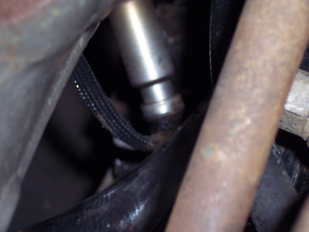

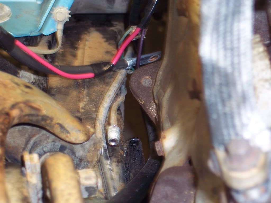

The left side though, the O2 interferes with the frame and the casting is real close to the mount for the lower control arm. I should be able to use the manifold, I will just have to move the O2 into the pipe.

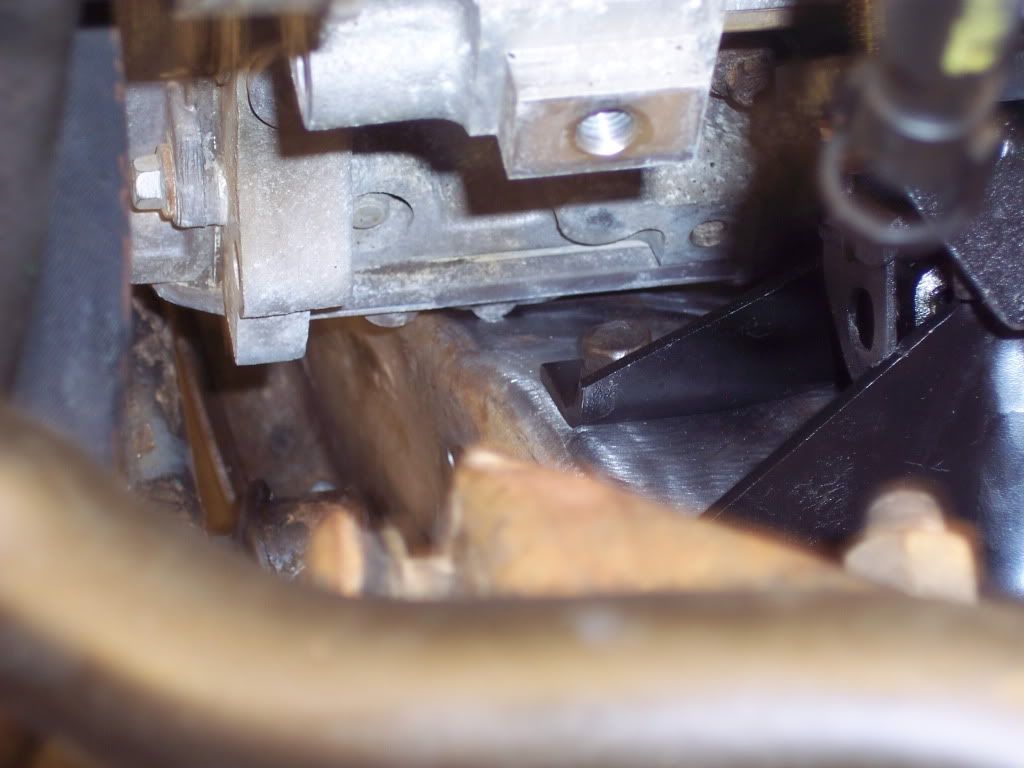

http://i1043.photobucket.com/albums/...8/100_1742.jpg
The oil pan hit just a little on the left side right on top of the crossmember. The spacing behind the crossmember is pretty much spot on.
http://i1043.photobucket.com/albums/...8/100_1732.jpg
http://i1043.photobucket.com/albums/...8/100_1746.jpg
Nice amount of room behind the engine although the brake booster is going to be a little tight.
http://i1043.photobucket.com/albums/...8/100_1733.jpg
The spacing for both the engine mounts and the trans crossmember were spot on!
http://i1043.photobucket.com/albums/...8/100_1745.jpg
Looks like I will have to use an aftermarket accessory drive. I am doubtful how much O.E. accessory equipment I can use. I do like how compact the units from Vintage Air and Billet Specialties are packaged. Just a little more than I wanted to spend.
Thats all for tonight!
Tim
