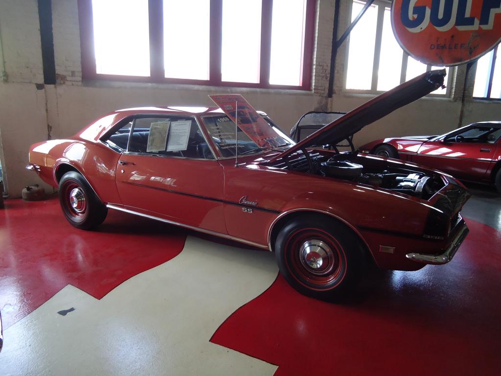

Great find on a bronze 68 Z! This Corvette Bronze car is here at a Corvette shop in North Kansas City...

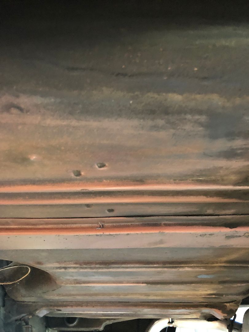

Update on my 68 Camaro,I have now had it 4 years and have enjoyed some nice summer cruizing. Over the past three years I acquired a correct date coded BV rear end ,same for an M21 Trans and a March 68 MO block. All components have been rebuilt and are ready to go in the car.
Step one was to remove the 69 Code BV and get it to the new owner,springs came out and a cleanup started on the underside.
Remember this car spent its entire life in the Willamette Valley of Oregon where they produce great Pinot Noirs and preserve 68 Camaros.
The underside is amazing, after alight cleaning with Zep 505,scrubbing and a drying evidence of factory over spray and undercoating in the wheel wells are evident .
I am not doing any restoration of the underside and just going to clean and preserve whats there. The car was drag raced extensively and had a roll bar. I will only fill the holes with plugs as I dont want to do any welding or re painting.

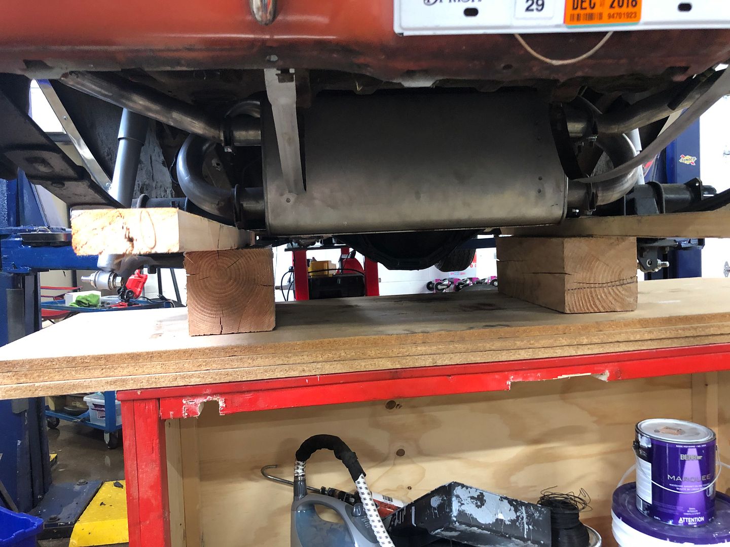

Rear end coming out:
https://i285.photobucket.com/albums/...sl6ogf9lv.jpeg

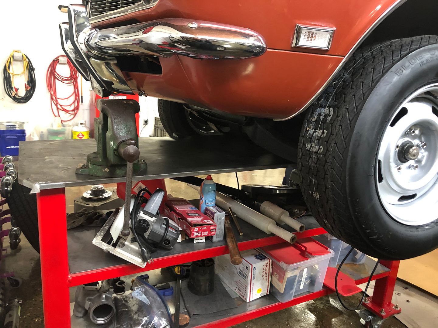

Used our big steel table to support front end in case of weight transfer,trunk had about 200 lbs of heads and cranks as counter weight,safety first.

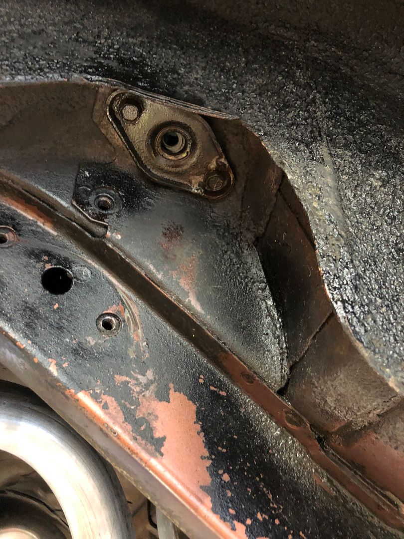

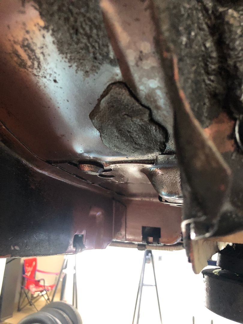

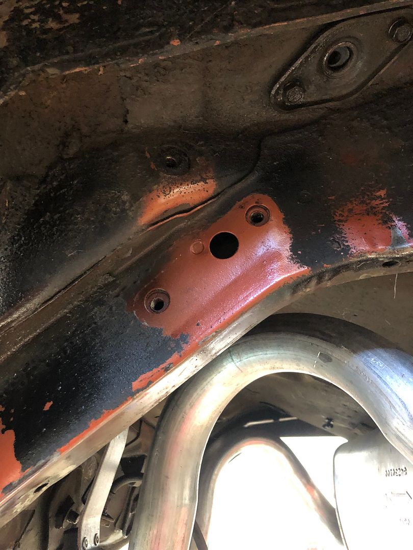

Got gas tank out and made room to remove springs, which will be cleaned up and all new bushings.
Next came the cleanup, happy with results from first pass, exhaust will be dropped to make more room.
http://i285.photobucket.com/albums/l...sa221zqas.jpeg
http://i285.photobucket.com/albums/l...sfl2xeqdl.jpeg
http://i285.photobucket.com/albums/l...s4opfmvlk.jpeg
http://i285.photobucket.com/albums/l...saqglznxm.jpeg

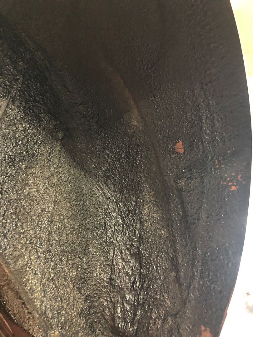

Can anyone chime in here and comment on the wheel well undercoating, it does not appear to be a dealer application as it is only in the wheel wells sand some over spray. This is a Van Nuys built car.

Canuck 03-29-2019 04:55 PM
Camaro
Originally Posted by m22mike (Post 1441593)
Has that car ever even been wet :worship:
Mike
The original owner traded the car in in 1972 It has always been in the Willamette valley, a very moderate climate. The second owner drag raced the car and I doubt he did drive it in any wet weather. I saw early photos with it on a trailer. Dont know how it accumulated 79,000 miles.
