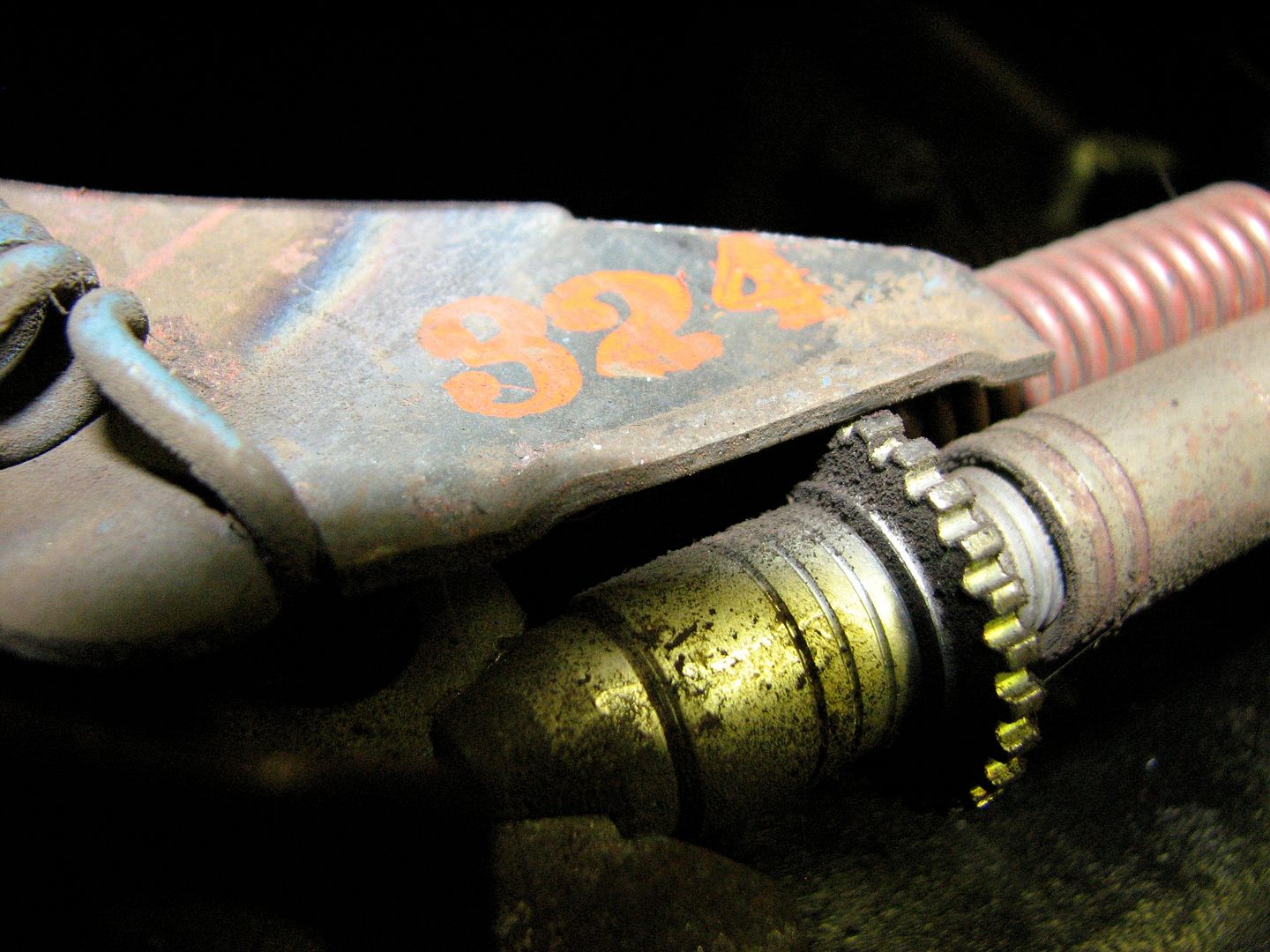

James is correct. It is a Julian Calender dating system.
Rich
Jonesy 05-04-2011 06:33 PM
Re: My '69 Z28 Find
295th (Oct 22) and 296th (Oct23) day of the year. That matches the timeframe of your car. The rotors are also stamped with ink just like that in yellow.

Don Stowers forwarded this photo of his 01B '69 Yenko Camaro. Date on the self-adjuster is consistent with the build date of the car. What a wonderful original car Don. Best of luck with the sale at Mecum!

Awesome! And I also see the original blue spring intact too, as my car has as well. Thanks for the help guys!

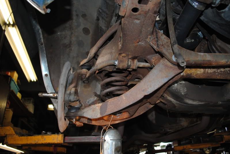

Front end is just about done! New lower ball joints, lower control arm bushings, idler arm, pitman arm, offset shafts, and some hardware were all replaced. The original 2 piece rotors were being cut as I was leaving (the one completed looked great) and new wheel bearings (inner and outer) were being inspected. The oil pan was hot tanked and the dents removed - slug too(!) and the gasket replaced. The flywheel was about to be cut, and the new Ram clutch will be installed shortly too. Delco front shocks should be in today...

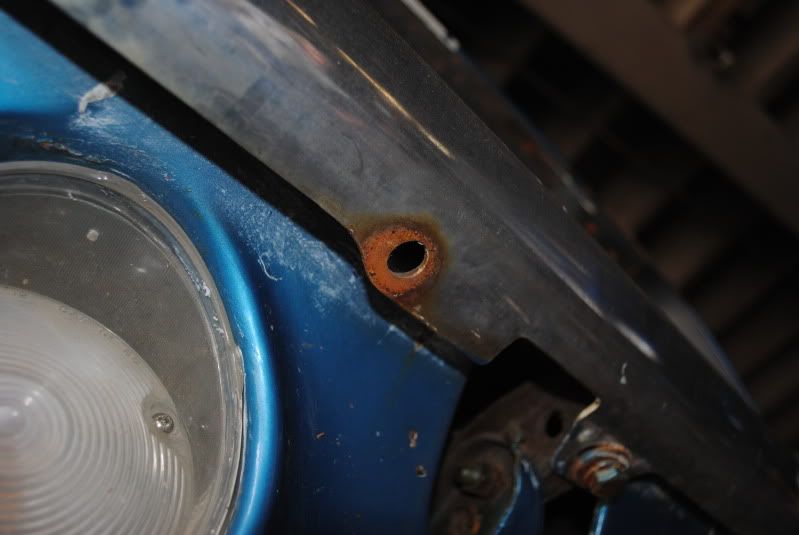

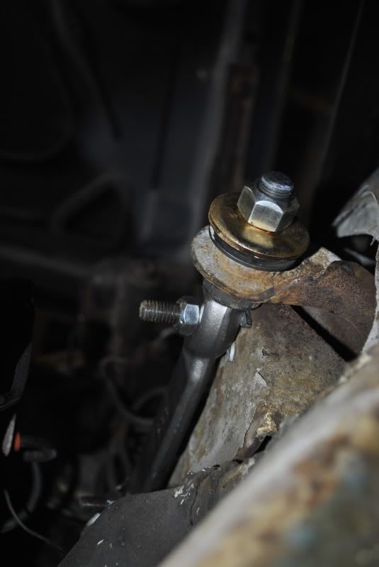

Evidence of an original front bumper guard car...
http://img.photobucket.com/albums/v4...6/DSC_0014.jpg

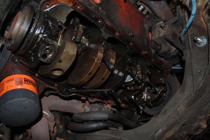

clean internals
http://img.photobucket.com/albums/v4...6/DSC_0012.jpg

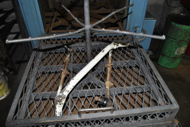

tanked drag link and tie rods (both original)

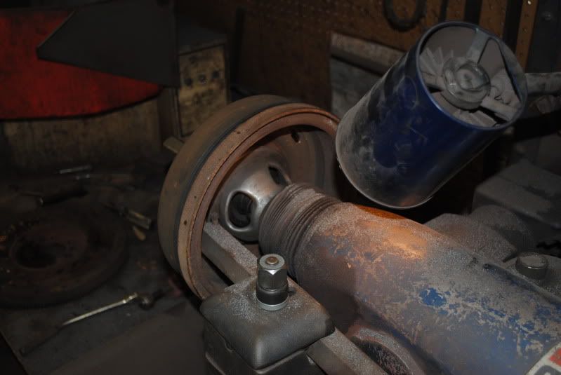

rear drums getting cut
http://img.photobucket.com/albums/v4...DSC_0019-1.jpg

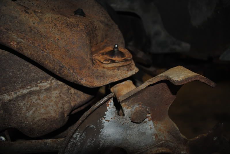

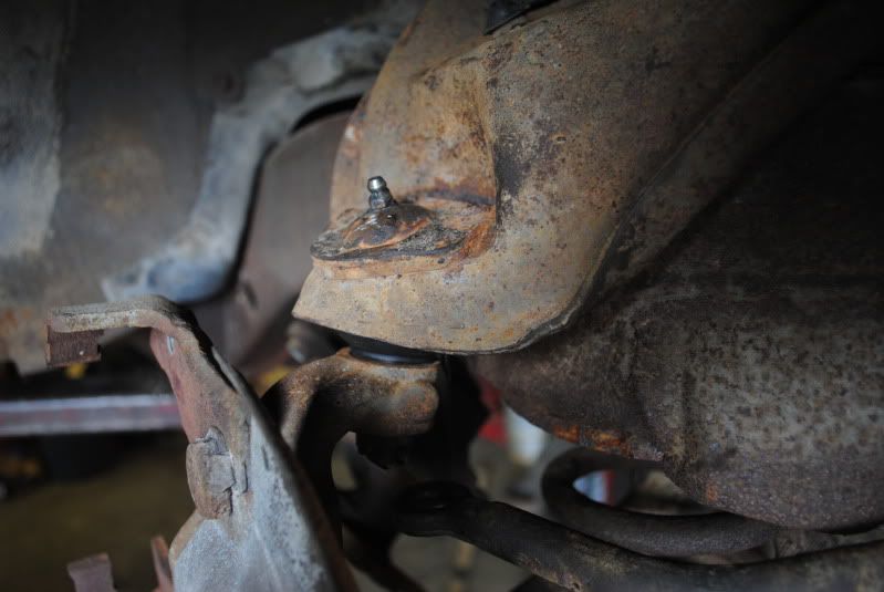

original upper ball joints
http://img.photobucket.com/albums/v4...DSC_0018-2.jpg

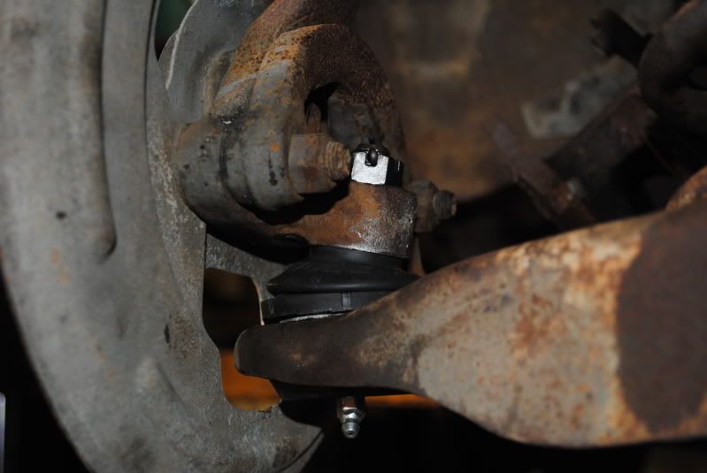

http://img.photobucket.com/albums/v4...DSC_0017-1.jpg

i think the bumpers were dipped from those holes during the chroming process. if the car had front bumper guards, there would be holes in the lower valance. i couldnt see any from the pic.
buddy
njsteve 05-21-2011 02:16 AM
Re: My '69 Z28 Find
I concur on the non-chromed holes in the lower part of the bumper. Camaro bumper guards bolt on using specific clamps, not the holes pictured in your photo.
al8apex 05-22-2011 01:03 AM
Re: My '69 Z28 Find
x 3, that is where they plated them from ...
