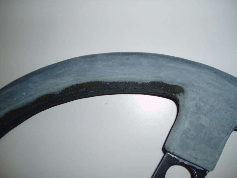

These wheels originaly had a smooth outer coating that eventually wore away after years of use and exposure to the sun, leaving the underlying rough, cracked, crumbly foam material exposed. Here is a close up of what they end up turning into:
http://i68.photobucket.com/albums/i30/nk15268a/a.jpg

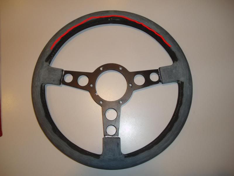

One of the main problems with my wheel (and most older wheels) was that the foam had seperated from the internal steel core at the 10:00 position and could be rotated on the core like a motorcycle throttle. If left unaddressed, this defect would prove fatal to any attempt at a cosmetic restoration as the foam would turn and crack the outer surface.
What I ended up doing was performing surgury on the wheel. I used a razor and sliced through the foam on theback side, down to the metal core, and then filled the area with black weatherstrip adhesive. Once filled, I wrapped the repaired area tightly in masking tape and left it overnight to cure. The repair worked perfectly: no more turning foam.
(The in-progress photo didn't come out so here is a later photo with the incision marked in red)
http://i68.photobucket.com/albums/i3.../P8250007a.jpg

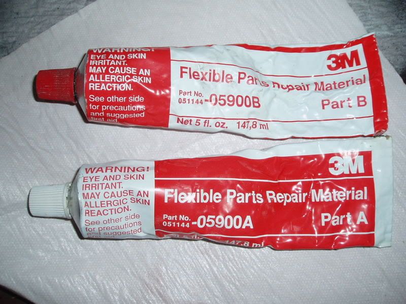

The biggest problem with these wheels is the lack of a similar material for repair. Some people use bondo (too rigid) or silicone (too soft), but until now there was no real alternative.
Scratching me head, I was digging around in the lab and found two 10 year old tubes of 3M rubber bumper repair epoxy. This is the stuff used for filling and repairing the elastomeric/endura bumpers on Camaros, GTOs, Trans Ams, Cudas and the like. Mixed in equal parts, it cures fast, is extremely flexible, sands easy and can be painted. Since I had nothing to lose, I used it: I ended up stumbling onto the perfect repair material.
http://i68.photobucket.com/albums/i3...a/P8250002.jpg

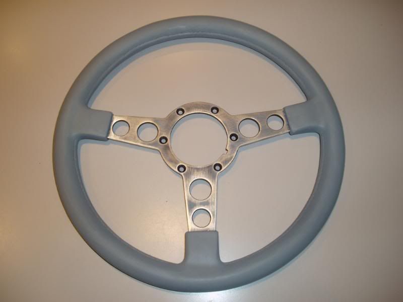

This is after about three days of reapplication, and resanding with 120 grit. I then sprayed it with several coats of flexible urethane primer and sanded some more with a mini-orbital sander and primed it some more. I also sanded the incorrect black paint off the spokes. This area should be anodized a gunmetal color, not painted (more on that later).
http://i68.photobucket.com/albums/i3...a/P8260010.jpg
http://i68.photobucket.com/albums/i3...a/P8260005.jpg

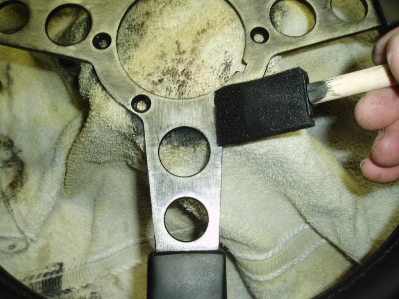

The big trick was trying to duplicate the original gunmetal anodized finish on the spokes. Since there is no way to reanodize the metal on the wheel I harkened back to my military modeling days as a kid when I used to build WWII armor dioramas for a local hobby shop and would "weather" the tanks and gear to make them look realistically "battle weary."
I used one of the old tricks of the trade, which is to do a light paint wash of the area. I sprayed a two second burst of flat black into a cup and then added a little enamel reducer. (Be very careful: as this stuff dripped on the foam wheel will ruin the finish). I used a foam brush and lightly washed the blackened reducer over the metal areas. As it dried I would daub it with a crumpled paper towel to get rid of any brush marks. I did this about 20 times. You have to be patient as each application removes about half of the previous application as the enamel reducer dissolves the earlier paint. This process worked very well as it brought out the original brushed finish in the metal.
http://i68.photobucket.com/albums/i3...a/P8290003.jpg
http://i68.photobucket.com/albums/i3...a/P8290006.jpg

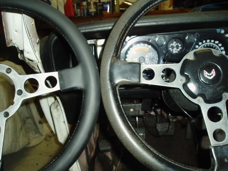

Here are the "McGyver-dized" spokes next to another original wheel for color comparison purposes. Perfect match:
http://i68.photobucket.com/albums/i3.../aP8290003.jpg
