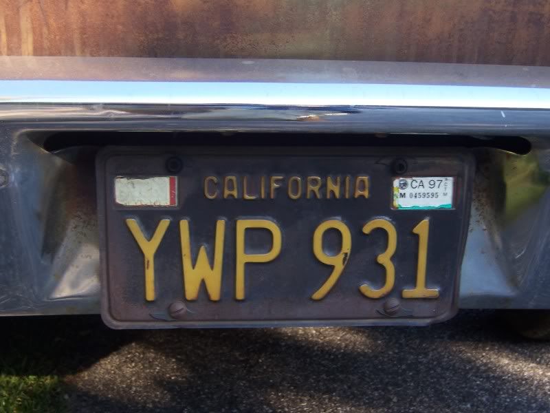

427TJ 05-01-2010 06:38 PM
Re: 72 TA : New Project
FYI Steve, I don't think CA went to the month decals (DEC) until the '80s. I think you want just the '72 decal and nothing on the other side if you want it to look as-delivered/new plates. Perhaps another CA veteran like Charley or ? can elaborate.
njsteve 05-01-2010 08:20 PM
Anyone with California knowledge feel free to comment. I have seen some vintage photos of cars with the month sticker on the left side. Either way it covers the later &quot;73&quot; sticker that someone stuck there.
jbsides 05-01-2010 08:56 PM
I can tell you for certain that the indetation for the month sticker has been on the plates since '63, and every original black plate I have had has had a month tag afixed to it. Not sure about the pre '63 yellow plates.
Did this car really come from Roseville up by Charley? I stay in Marysville all the time, and just had dinner in downtown Roseville a couple weeks ago, and I did not see or recall any GM dealer there. I wonder if it is still there.
You're car is flippin' awesome, BTW.

x Baldwin Motion 05-02-2010 03:50 AM
<div class="ubbcode-block"><div class="ubbcode-header">Originally Posted By: 427TJ</div><div class="ubbcode-body">FYI Steve, I don't think CA went to the month decals (DEC) until the '80s. I think you want just the '72 decal and nothing on the other side if you want it to look as-delivered/new plates. Perhaps another CA veteran like Charley or ? can elaborate. </div></div>
This is the original plate on my son's Nova. I guess not registered since 97. Can't make out the sticker in the photo, I'll take a closer look in the morning.
http://i134.photobucket.com/albums/q...3/100_9983.jpg
