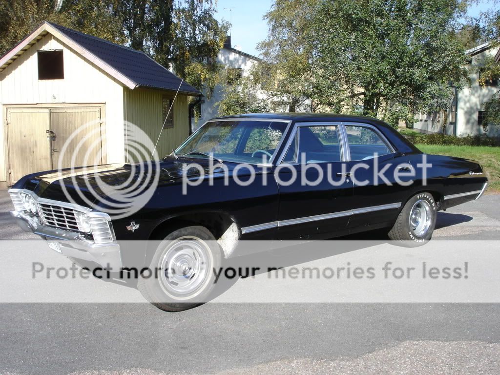

COPO_Anders 10-24-2009 09:47 PM
Re: Odd option on LS6 Chevelle
It´s another story but I had a 1967 Impala with a 275 hp 327 that was built in Canada. It was supposed to have a 10-bolt rearend with a 3.08 posi in it. It actually had a 12-bolt with a 3.07 posi in it, and it was date-correct for the car. I´m thinking it was a glitch at the factory that made this happen. Maybe they ran out of 10-bolts and installed the standard Taxi-car 12-bolt instead ? We will never know.
https://www.yenko.net/ubbthreads/imag...lins/dunno.gif
Schonyenko2 10-24-2009 09:59 PM
Yep, that's it.

COPO_Anders 10-26-2009 02:34 AM
Keith, my Impala had the F40 option. But George Z. said it should have been built with a 10-bolt.

COPO_Anders 10-28-2009 12:12 AM
First of all I want to apologize for highjacking the thread. I didn´t mean to do that.
George, when I asked you about the 12-bolt rearend on the car you told me to read through the material you had sent me. After doing so I was convinced that it should have been built with a 10-bolt, just like you said. I therefore thought that the 12-bolt was put under the car at the factory by mistake.
But when Keith wrote: "There seems to be some evidence that any car ordered with the F40 option also got the 12 bolt. True??" I started to think that it maybe wasn´t by mistake.
So did F40 cars get 12-bolt rearends ?
Kurt, it has a powerglide as you can see in the document.
http://i436.photobucket.com/albums/q...pala-67007.jpg
http://i436.photobucket.com/albums/q...7Impala002.jpg
