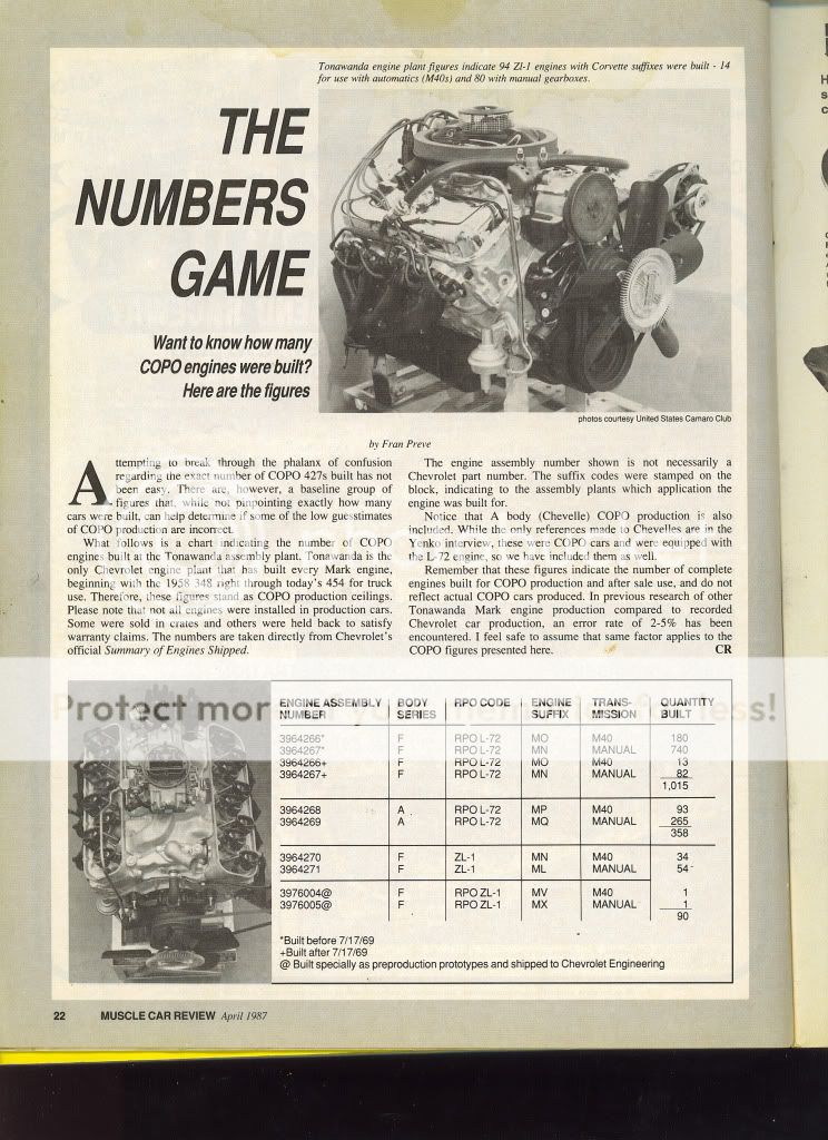

COPO_Anders 02-08-2011 08:50 PM
Re: 1 of 2 Original 1969 ZL1 Corvette Blocks
Here is some old info.
http://i436.photobucket.com/albums/q...s/ZL1proda.jpg
Born30YrsLate 02-08-2011 11:58 PM
<div class="ubbcode-block"><div class="ubbcode-header">Originally Posted By: COPO_Anders</div><div class="ubbcode-body">Here is some old info.
http://i436.photobucket.com/albums/q...s/ZL1proda.jpg </div></div>
What is the significance of the 7/17/69 build date on the COPO Camaro Engines?...was this when 1969 production year was initially supposed to end?

94 Corvette ZL-1 engines, plus 90 Camaro ZL-1 engines = 184 ZL-1 engines.
052 Can-Am Blocks ?
