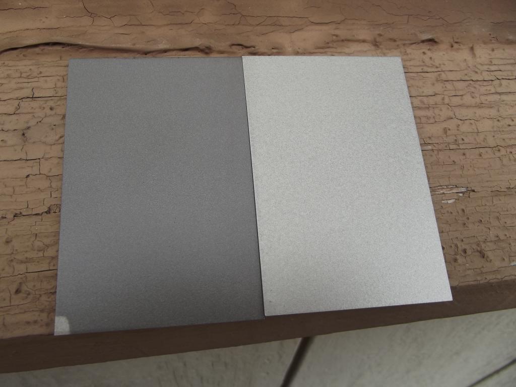

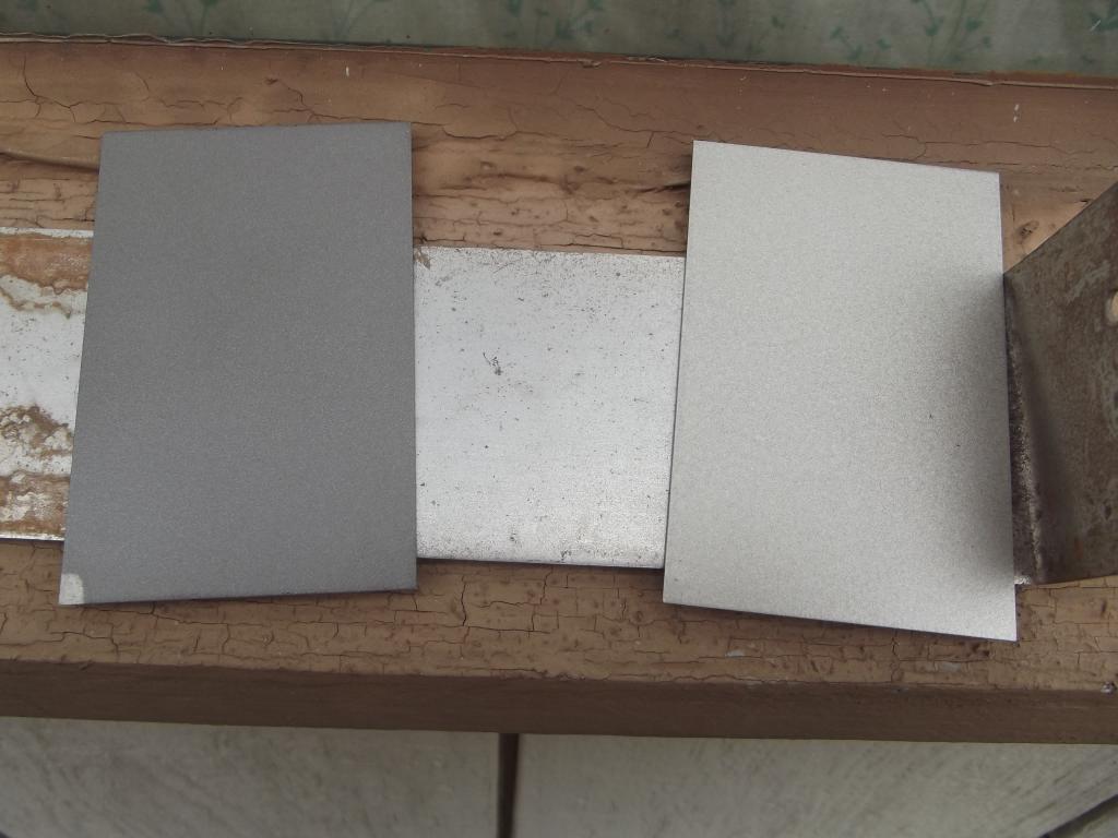

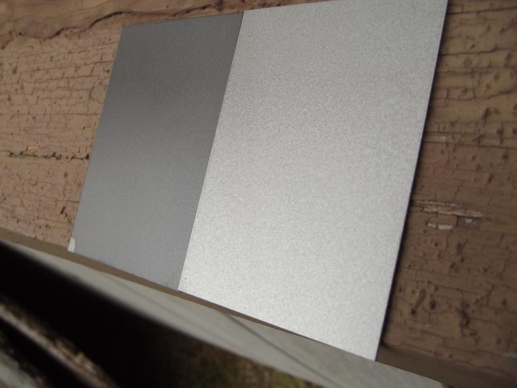

m22mike 09-27-2016 11:59 AM
Re: spraying rattle can bare steel paint
Here are shots of Seymour Cast Blast and Seymour Stainless Steel, with one shot against a piece of bare steel.
https://www.yenko.net/ubbthreads/pics...7-dscf6614.jpg
https://www.yenko.net/ubbthreads/pics...8-dscf6617.jpg
https://www.yenko.net/ubbthreads/pics...9-dscf6616.jpg

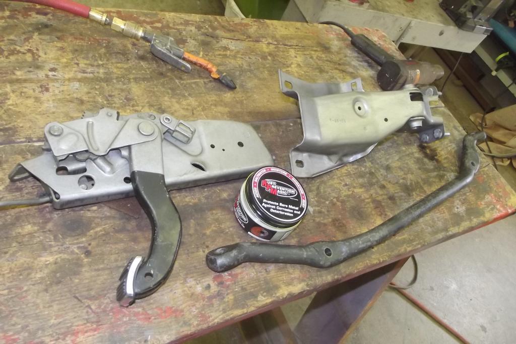

m22mike 09-27-2016 01:10 PM
What parts specifically John ? Sometimes I acid etch with phosphoric acid, blow dry with hot air, then use R.P.M, and after is sets up even some Boeshield.
Mike
https://www.yenko.net/ubbthreads/pics...5-dscf6282.jpg
