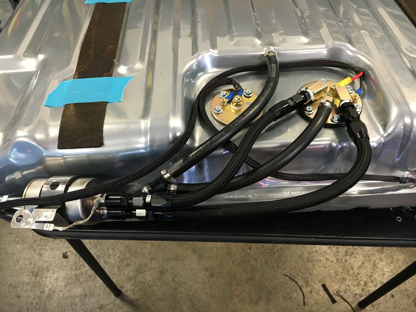

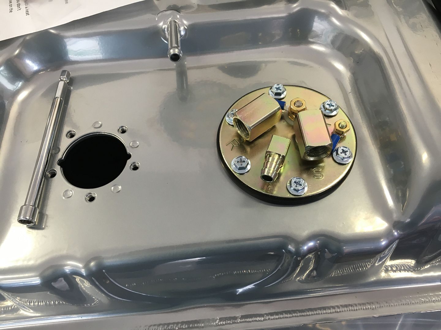

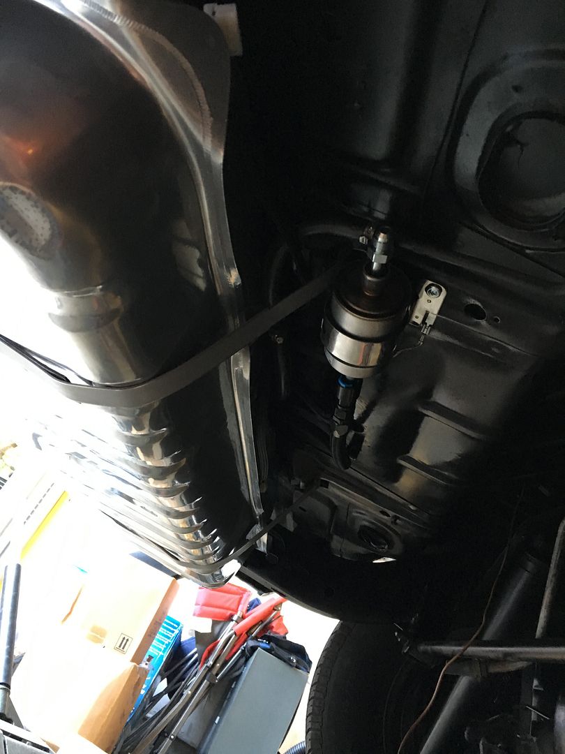

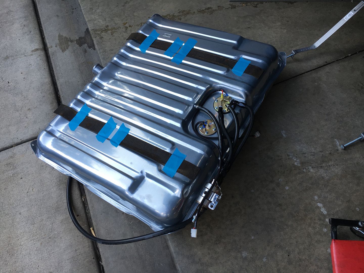

Got the Fuel system pretty much completed today......Fuel Pump fit and installed........Fuel Level Sender fit and installed........Filter Regulator installed and lines made........Then got the Tank installed.........Wiring for the Pump and the Dakota Digital fuel gauge installed also........Moving along..........
http://i13.photobucket.com/albums/a2...ed5509a610.jpg
http://i13.photobucket.com/albums/a2...f04436a0cd.jpg
http://i13.photobucket.com/albums/a2...B87DE4142E.jpg
http://i13.photobucket.com/albums/a2...F2BC2D9F34.jpg
http://i13.photobucket.com/albums/a2...4E282D4A28.jpg

Zman1969 10-06-2016 04:53 PM
Re: Andy's 66 Caprice LS Conversion Upgrade
Whizz, was wondering about the fuel hose your using. I looked at that before deciding to use plastic heard so much about hoses deteriorating after years due to alcohol? in fuel
I bought this kit and tried a couple fittings on the lines and simple ehough and since like OE should be durable
http://static.dormanproducts.com/ima...009657-009.JPG
Dorman 800-300 Nylon Fuel Line Repair Kit, 104 Piece under $200 on amazon dont get me wrong that stuff your looking is sexy! I was worried about longevity an old Firebird of mine was having issues with stainless braded leaking and its was pretty old and didnt want to do it twice- thoughts?
Great work as usual I've seen a few of your swaps!
I believe Ken is using a &quot;lined&quot; hose, that is ethanol compatible. Its what I used on my 59 when I installed the LS1.
Tim
earntaz 10-07-2016 12:36 AM
<div class="ubbcode-block"><div class="ubbcode-header">Originally Posted By: napa68</div><div class="ubbcode-body">I believe Ken is using a &quot;lined&quot; hose, that is ethanol compatible. Its what I used on my 59 when I installed the LS1.
Tim</div></div>
Teflon lining?

napa68 10-07-2016 10:51 PM
<div class="ubbcode-block"><div class="ubbcode-header">Originally Posted By: earntaz</div><div class="ubbcode-body"><div class="ubbcode-block"><div class="ubbcode-header">Originally Posted By: napa68</div><div class="ubbcode-body">I believe Ken is using a &quot;lined&quot; hose, that is ethanol compatible. Its what I used on my 59 when I installed the LS1.
Tim</div></div>
Teflon lining? </div></div>
Its actually referred to as PTFE.
For instance......
https://www.pegasusautoracing.com/pr...p?Product=3480
earntaz 10-07-2016 11:25 PM
<div class="ubbcode-block"><div class="ubbcode-header">Originally Posted By: napa68</div><div class="ubbcode-body"><div class="ubbcode-block"><div class="ubbcode-header">Originally Posted By: earntaz</div><div class="ubbcode-body"><div class="ubbcode-block"><div class="ubbcode-header">Originally Posted By: napa68</div><div class="ubbcode-body">I believe Ken is using a &quot;lined&quot; hose, that is ethanol compatible. Its what I used on my 59 when I installed the LS1.
Tim</div></div>
For instance......
https://www.pegasusautoracing.com/pr...p?Product=3480</div></div>
Polytetrafluoroethylene (PTFE) -- synthetic fluoropolymer of tetrafluoroethylene. Brand name of PTFE-based formulas is Teflon -- thanks to DuPont which discovered the compound in 1938.
