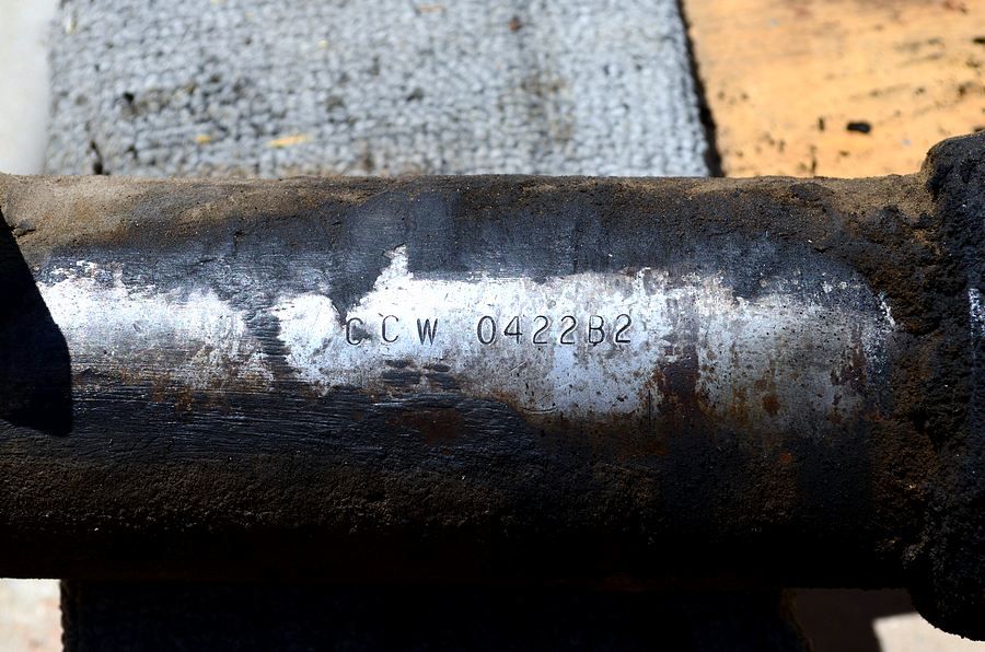

Xplantdad 11-09-2022 08:44 PM
1 Attachment(s)
Here's the CCW stamp on the rear that we found for the red Chevelle here in AZ.
Attachment 227721

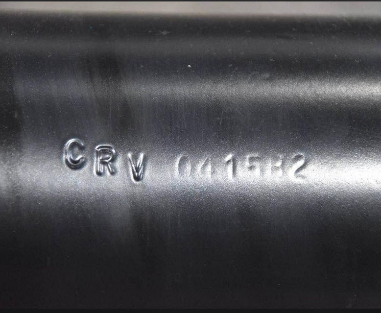

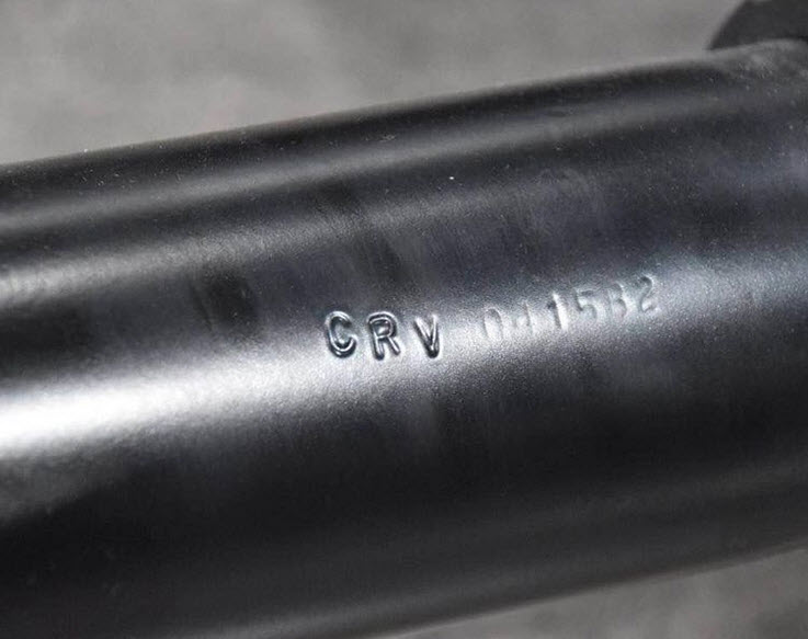

Xplantdad 11-09-2022 08:47 PM
2 Attachment(s)
And here are two pics of the Facebook rear in question....

DougA 11-09-2022 10:40 PM
Thanks for that pic. Not an expert, but that sure does look fishy.
Esp.for 4 k.
