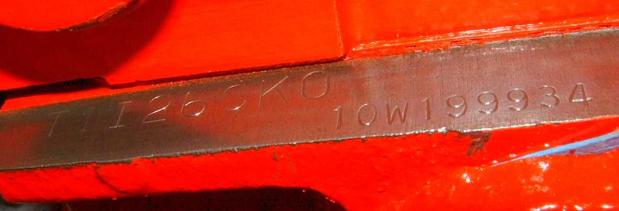

I'm looking at buying a 70 L-78 Camaro from a friend who has had the car for 10 -20 years. It has been in his garage ever since he bought it and he calls it in rough condition. I've seen much worse in fact my 70 Z started in worse condition before the resto.
I've gone through all the numbers and date codes match (M-21 trans with vin, dist, alt, heads, rear, exhaust manifolds, intake, water pump, intake and starter. It even has the COPO 3 peice spoiler.
My question is the engine block has a CKO code. From what I've researched so far the L-78's with a manual trans were coded with a CJH. I see that CKO is for a 396 with mt but doesn't specify a L-78. Would they have used the CKO block for a L-78? I haven't been able to find the vin on the block yet.
He is pulling all the documentation that he has for the car and he states that he has the POP but no build sheet. I hope to see the documentation soon and see what is there.
Also, any recommendations on what esle I should look for?
Mr70 10-27-2005 06:13 AM
Re: 1970 L-78 Camaro CKO block
CKO is the correct code for the 402/375HP Man. Trans. L-78.
What's the Prefix & date stamp on the Pass. side Rearend axle tube?
Please share pix of every single possible piece of documentaion with us,as well as the Cowl tag info.
We are here to help.

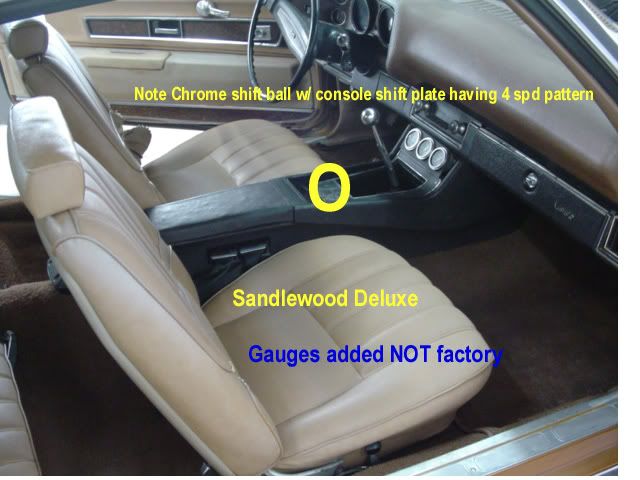

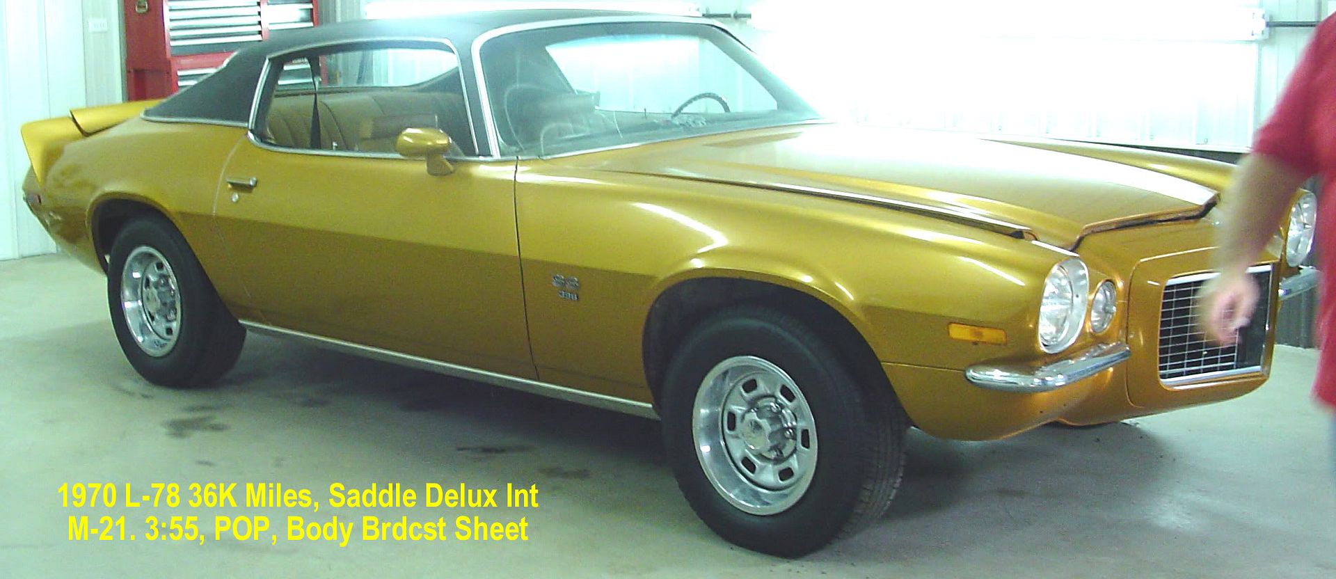

nrjulin 10-27-2005 06:21 AM
1 Attachment(s)
Here are the pics I have so far. I don't have a pic of the cowl tag yet but here is the info.
ST 70 12487 NOR270003BDY
TR 723 45 G PNT
04C L78
Yes, it is triple green.
Thanks for the help.

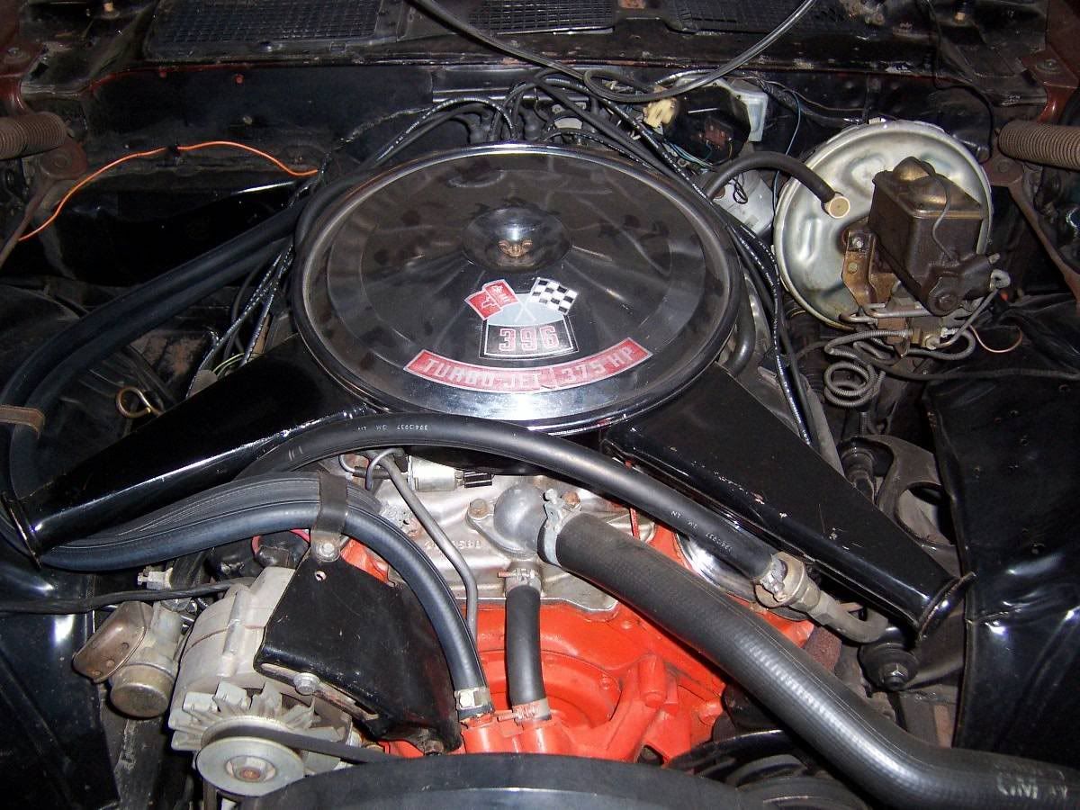

nrjulin 10-27-2005 06:25 AM
1 Attachment(s)
and the engine. The original exhaust manifolds come with the car.
Mr70 10-27-2005 06:26 AM

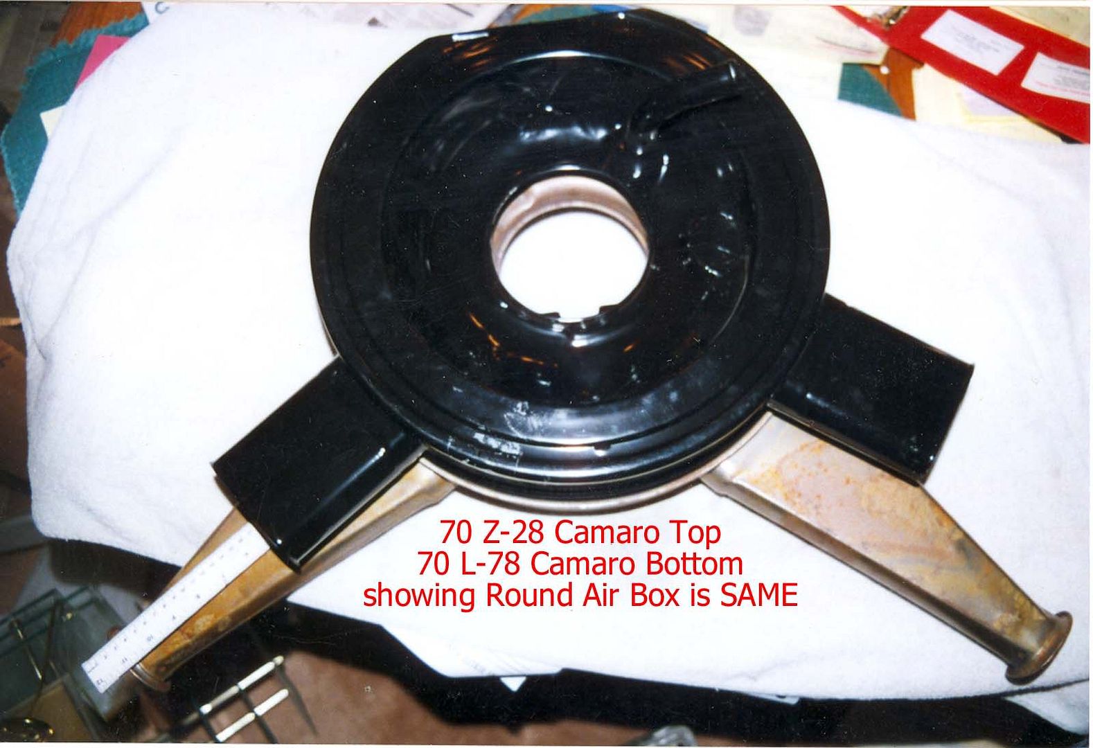

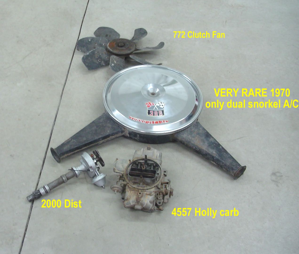

Does he have the Dual Snorkle Air Cleaner for it?
Make sure the Ex.Manifolds have A.I.R. provisions.

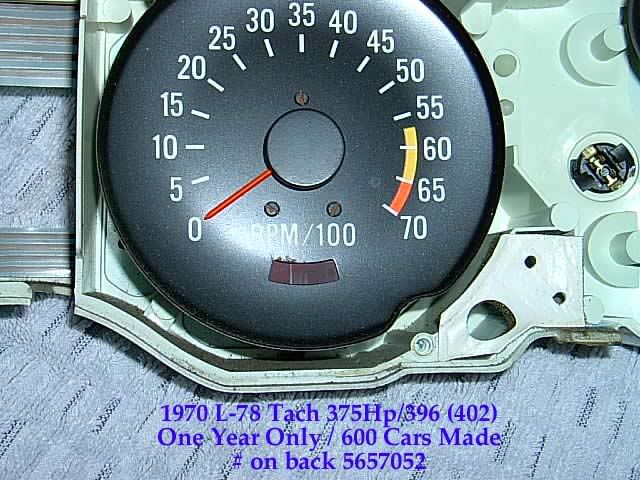

What red Line is the Tach,if so equipped?
NICE CAR!

Mr70 10-27-2005 06:39 AM
That's the proper rear.
Can you find out the casting date & casting no. of that CKO block please.
nrjulin 10-27-2005 06:45 AM
The block casting is 3969854 and the date is J-18-9. The date seems early so that was going to be my next question.
Thanks again.
Mr70 10-27-2005 07:13 AM
That is early,but not impossible as these cars were built very late,and most likely the blocks were just sitting waiting for the cars awhile.

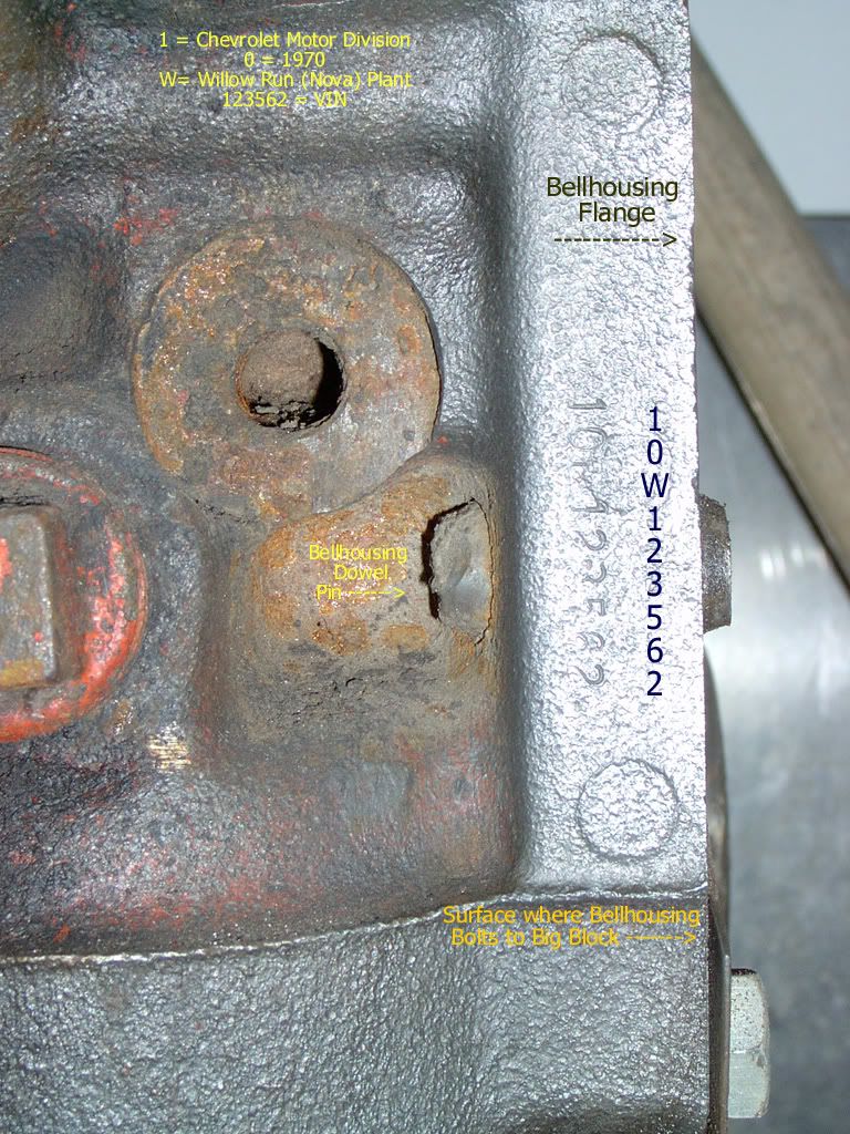

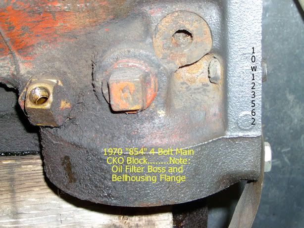

What's the Tonawanda build date before the CKO code on the Pad behind the Alternator?
Is the VIN# stamped there,or is it down by the Oil filter?
Do you see an external Oil cooler provision above the Oil filter Mount to indicate a 4-bolt block?

http://img.photobucket.com/albums/v4...0Misc/pad3.jpg
http://img.photobucket.com/albums/v4...0Misc/Tach.jpg
http://img.photobucket.com/albums/v4...0Misc/Vin1.jpg
http://img.photobucket.com/albums/v4...0Misc/Vin2.jpg

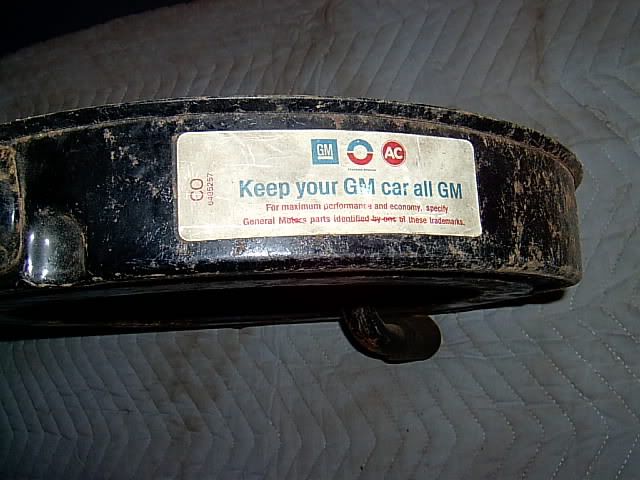

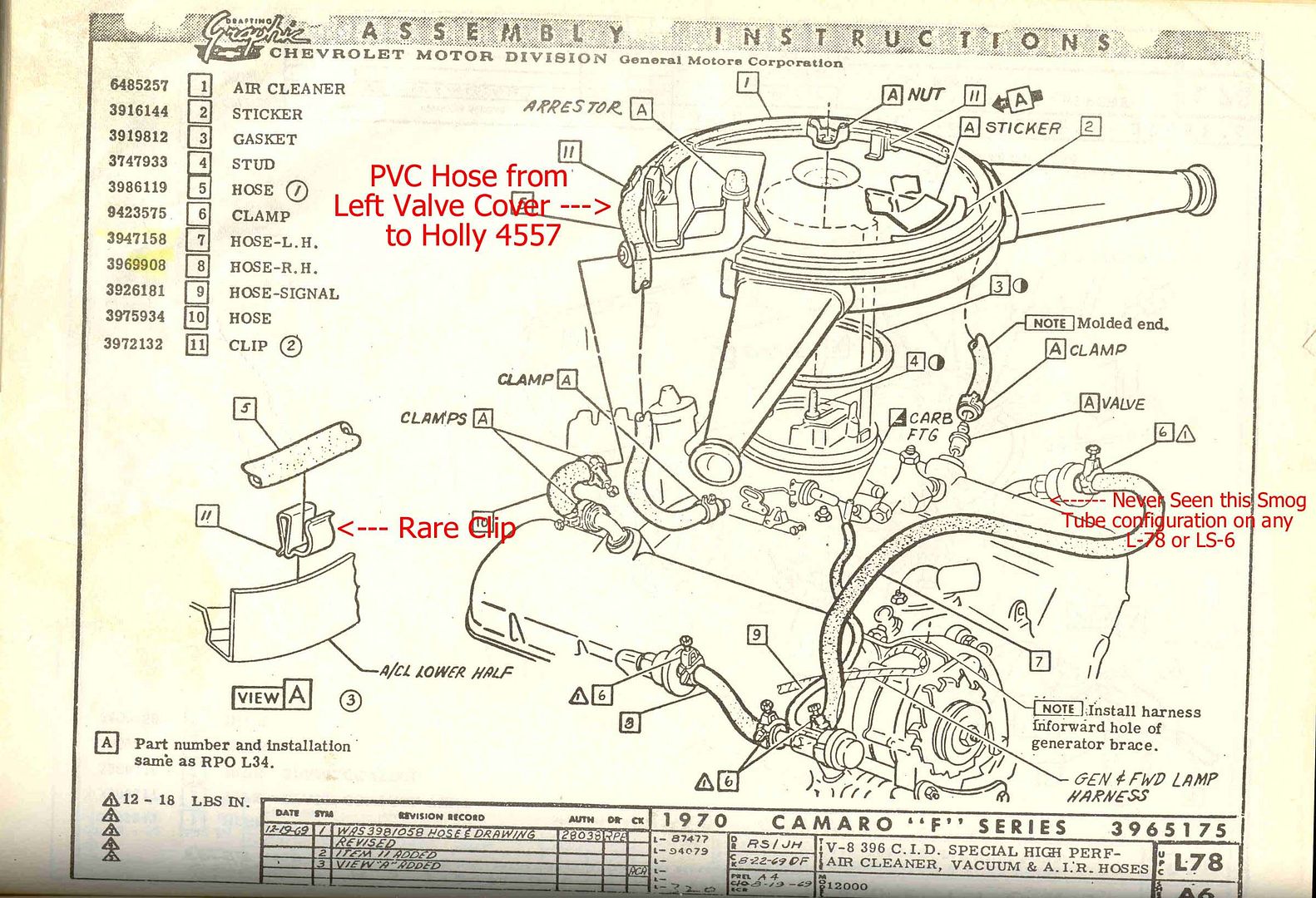

CamarosRus 10-27-2005 11:02 AM

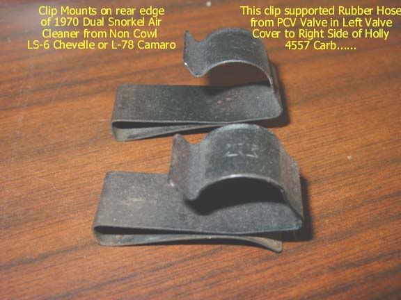

http://img.photobucket.com/albums/v4...0Misc/Air1.jpg
http://img.photobucket.com/albums/v4...0Misc/aps3.jpg
http://img.photobucket.com/albums/v4...Carlisle2j.jpg
http://img.photobucket.com/albums/v4...arlisle2jb.jpg
http://img.photobucket.com/albums/v4...c/Cleaner2.jpg
http://img.photobucket.com/albums/v4...Misc/Clip1.jpg
http://img.photobucket.com/albums/v4...c/IM000122.jpg
My Current L-78 (NOT pictured, also Classic Copper) will be using above style air cleaner........
Chuck
Man, I am wondering how that L-78 402 can breathe through those tiny snorkels. An open element air cleaner could free up a lot of power on these engines.
At least the LT-1 350 has larger openings to draw air from. Anyone have any performance specs or road test data from the 70 L-78 Camaro. With the low rise intake and restrictive air cleaner, I would think it would be slower than the LT-1 powered Z-28.

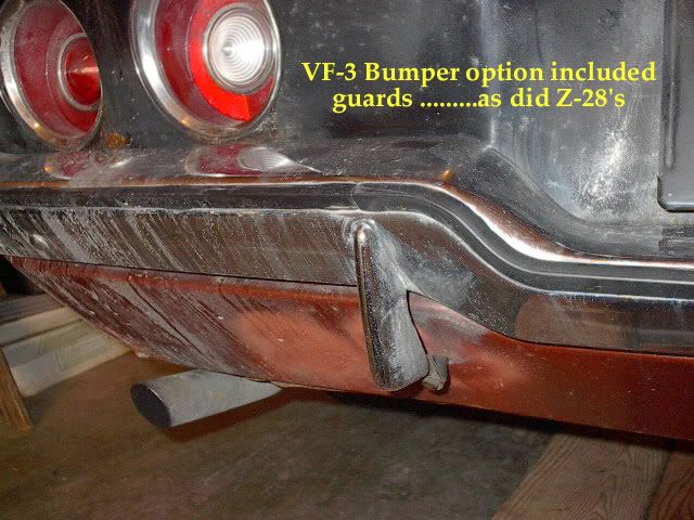

CamarosRus 10-27-2005 10:36 PM
Rear picture appears to show bumper guards W/O VF-3 Rubber Strips. If this is PLAIN chrome bumper with guards, that would be wrong, UNLESS we have uncovered another detail on COPO spoilers (Phil B please respond) I also see what appear to be RARE Original Chrome tip tailpipes, which were on all SS cars.
Can anybody else SEE what appears to be a quite SHINY Black Taillight panel.....which helps to demonstrate how most people have this detail TOO flat........
Chuck S
CamarosRus 10-27-2005 10:37 PM
http://img.photobucket.com/albums/v4...panelBlack.jpg
http://img.photobucket.com/albums/v4...VF-3Bumper.jpg
Fhakya 10-28-2005 04:35 PM
I think that a better phrase would be 'tangs' or 'fangs' as the early VF-3 seem to me to be urethane "guards".
The post above the pics kind of lost me a bit.
I the initial pics posted (granted I didn't blow them up at all) of nrjulin, I didn't see any real tell-tale signs of the early VF-3 option. The "tangs", "fangs" are there but can you really see the tell-tale signs of the 'early' VF-3 guards there? I trust you 1st and foremost Chuck https://www.yenko.net/ubbthreads/imag...ns/worship.gif but I'm not seeing it...so far from the pics.
Why would the VF-3 guards be wrong if it were after the rubber bumper guards were discontinued? I've been a 2nd gen "hound" since I was a kid but only recently has the VF-3 option caught my radar...weird.
Also..I've been thinking for the last few months about putting together a web based '70 Camaro L-78 registry (just because I have a passion for them, the server space and the time...and 600 cars can't be that much work right? https://www.yenko.net/ubbthreads/imag...mlins/wink.gif
-Mark H.
canadian_ssl78 10-29-2005 10:40 AM
Mark, I think the only way to get rear bumper guards was to order a Z28 (standard equipment) or order the VF3 option on any camaro. The VF3 option included the rear guards.
Chuck, are the rear bumper pics shown above your car?
John
70CitrusZ 10-30-2005 01:33 AM
Fhakya,
rpo VF3 is the rubber strips AND the guards.
Regular guards only (rear)(with no rubber) are not VF3, and are apparently "only" a part of rpo Z-28, with no separate rpo.
So if you ordered rpo VF3 you got the guards along with the rubber strips.
If you ordered rpo Z-28 you got the guards but no strips.
If you ordered rpo Z-28 AND VF3 you got the guards and the strips.
The ONLY (apparently) other way a non Z-28 and non VF3 car could have these guards were as a dealer installed part.
A lot of people confuse VF3 with standard Z-28 guards.
standard Z-28 bumper guards are not rpo VF3.
Mark.
nrjulin 10-30-2005 02:33 AM
I blew up the original picture (much higher resolution) that I have and I can see the urethane strip. I plan on going to pick the car up next weekend since the owner is out of town this weekend. If all goes well, I'll be the proud owner of this 70 L-78.
Again, thanks to everybody's (Rick and Chuick espacially) help and input in verifying this 70 L-78 Camaro. I know thier help will be incredilbly valuable when I start the restoration.
Once I have the car in my possesion, I will be happy to share any information gathered from it.

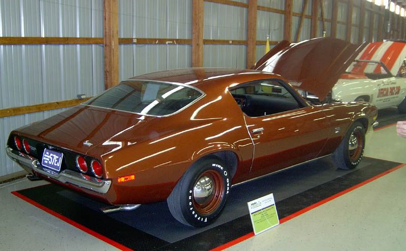

nrjulin 12-04-2005 08:33 PM
Well it has been a while since I updated this post but the good news it I finally have the car in my possession.
It is remarkably complete. It only has 22,810 miles on it and has all the original and correctly date coded parts that one could ask for: CKO Engine with VIN, M-21 with VIN, 3:55 COX rear, L-78 Tach, dist, alt, heads, rear, exhaust manifolds, smog system, intake, water pump, intake and starter. Even the original exhaust is still there. Also, The interior looks very good other than being very dirty and a ripped drivers seat. All the sheet metal is very solid but there has been some surface rust in the usual areas that was preped and primed and original vinyl top was ripped off and primed.
To correct an earlier post, this was not a 3 piece spoiler car originally. That was added by the second owner but I was given the original one peice spoiler with the original dealer name plate still attached. It was sold out of John Smith Chevrolet in Atlanta GA.
To my surprise the POP, original sales invoice, warranty transfer paperwork and receipt to the second owner all came with the car. I will be the fourth owner. The First owner only owned the car for about 8 months, Second owner until 1988 when the last owner bought it and parked in in his garage. Also, I was given a ton of NOS parts the last owner collected in the 80's when he planned on restoring the car. I still have alot of boxes to go through but I did find the original L-78 air cleaner and a NOS L-78 air cleaner still in the original parts box.
Now for the fun of restoring the car.
Thanks again to everyone who helped me verify the info for this car.
One more thing, He still has a few more incredible cars that he is considering selling. 1970 Chevelle LS-6, 1970 Buick GS and 2 442 W-30's. He collected these in the 80's with the hope of restoring them but has not yet. He did collect alot of NOS parts to get ready for the restorations but...
