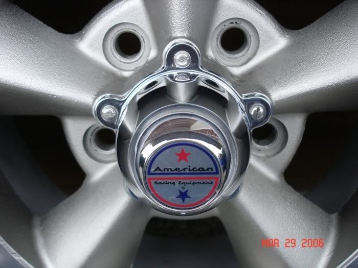

I use Simple Green on all my wheels. Just a light spray and work it with a soft bristle brush if needed. I use Nevr-Dull wadding in a can to keep the polished area bright. For the caps I use stainless 8-32 straight slot screws with stainless flat washers on the center caps and only tight enough to hold the caps. Don't want to crack a cap ear or strip out a hole.
http://i12.photobucket.com/albums/a2...heels006-1.jpg

427TJ, did you paint the center section on your wheels? Thanks, Bill D
427TJ 04-08-2006 09:30 PM
Re: Vintage Wheels
Bill, I sent you a PM. Yes, spokes were painted silver during restoration.

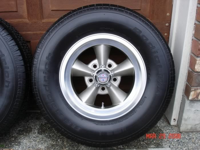

427TJ, What silver did you use on the wheel centers? Is that Rally Wheel silver? They really look good!
The shop that restored that particular set painted the spokes in their "special blend" silver. Here's what the wheels look like. (14x6 with a 225-70 T/A.) One of the great wheel designs of all time!
http://i12.photobucket.com/albums/a2...heels003-1.jpg

Thanks 427TJ. I agree, those wheels are the best! I wish American Racing would reproduce the correct version of that wheel.
