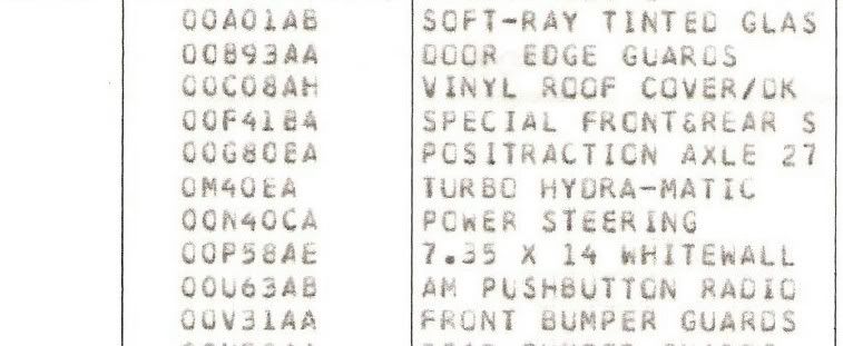

superstocker 08-27-2006 04:40 AM
Re: 1970 nova suspension option?
Here is a 70 non SS car with F41 suspension.
http://i32.photobucket.com/albums/d4...ainvoice32.jpg
69LM1 08-27-2006 05:48 PM
Does that show a posi and a turbo 400? https://www.yenko.net/ubbthreads/imag...ns/naughty.gif

superstocker 08-28-2006 04:25 AM
Its a invoice,not a window sticker. I seen the F41 and thought it was for a 70 but its a 69. How could it have F41 if it did not come out until spring of 1970. The car sold for $3028.50 and its not an SS.
http://i32.photobucket.com/albums/d4...vainvoice3.jpg
Mr70 08-28-2006 04:40 PM
RPO F-41 came out in Spring of 1969.
