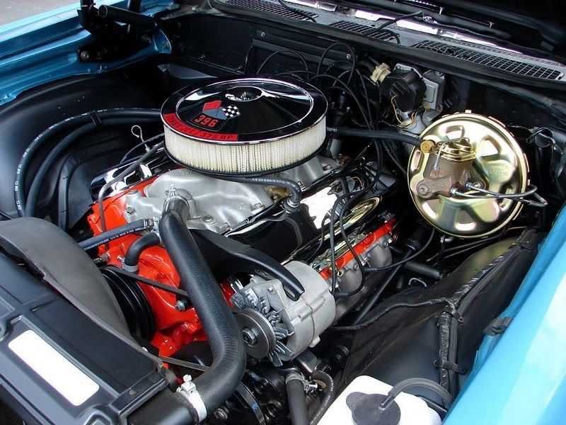

I just can't believe that the engine still has it's original paint after looking at the photos.

There is NO WAY that this Chevelle has the original engine paint on it as stated in the ad. It looks way too clean and good for being 39 years old!! I also find it hard to believe that someone would be selling a low mileage, all original, numbers matching, L78 68 Chevelle for $48,000. HEY, I WAS BORN AT NIGHT BUT NOT LAST NIGHT!!! Cut the BS already!!

I see several things that are definately not orginal to the car in my opinion: #1 the brake booster is clearly a repop as is the chrome oil dipstick.I also agree with the others that the paint on the engine is just too nice to be the orginal paint. #2 and I'll need some help here from one of you Chevelle experts ( Mr. Vasic, are you reading this thread ) I don't believe that this style of dog dish cap was available until 1969 and was it even available on a Chevelle? If I'm wrong, someone please correct me because I just don't know for sure. These are all very minor things, but Dr. Dave claims the car is ALL completely original except for the exhaust and the battery. With all that being said, I still think this is a beautiful car and I would most definately love to own it!

These dog dish hubcaps were available on 68 Chevelles. My buddy has them on his 68 and I also have an old 1968 edition of Hot Rod Magazine where they feature a 1/4 mile track test on a new 68 Chevelle SS 396 car and these hubcaps are on the car...
Thanks Rich.... I've seen many muscle cars durring the course of my life but I've never seen these caps on anything but Camaros and Novas. That's the beauty of this site, people willing to share a wealth of information and knowledge, I think I learn something new just about every time I log on. Thanks again for the info! https://www.yenko.net/ubbthreads/imag...iggthumpup.gif
