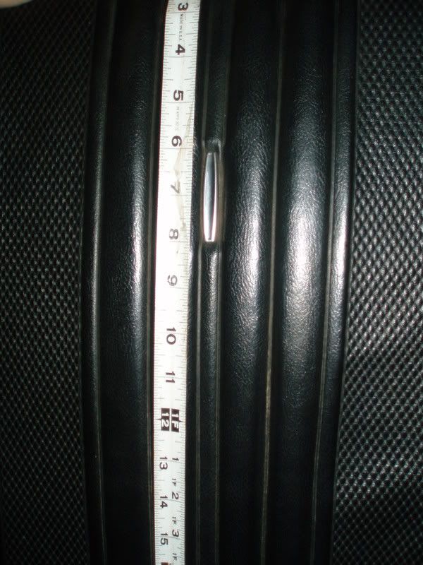

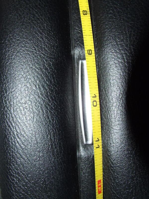

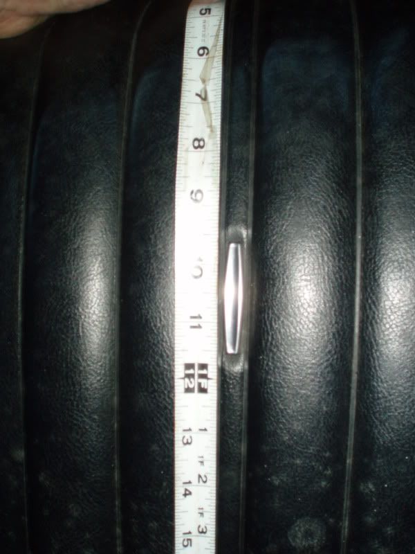

Front seat medallion is approx. 6" down from upper bead as in pic. I butted the end of the tape measure to the upper bead for this pic.
The rear is approx. 10" down from the rear edge of seat top. I hooked the tape measure on the edge for the pic.
http://i36.photobucket.com/albums/e4...allions005.jpg
http://i36.photobucket.com/albums/e4...allions006.jpg

Rick,
What speedy service.....Thanks so much. Photo`s are great!
Have these seats been recovered at some point? Or are they original?

Dan,
The front seats were recovered, but I transferred the medallions to the same spot they came from.
The rear seat is original.

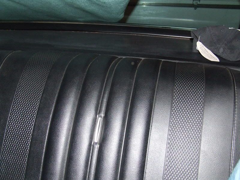

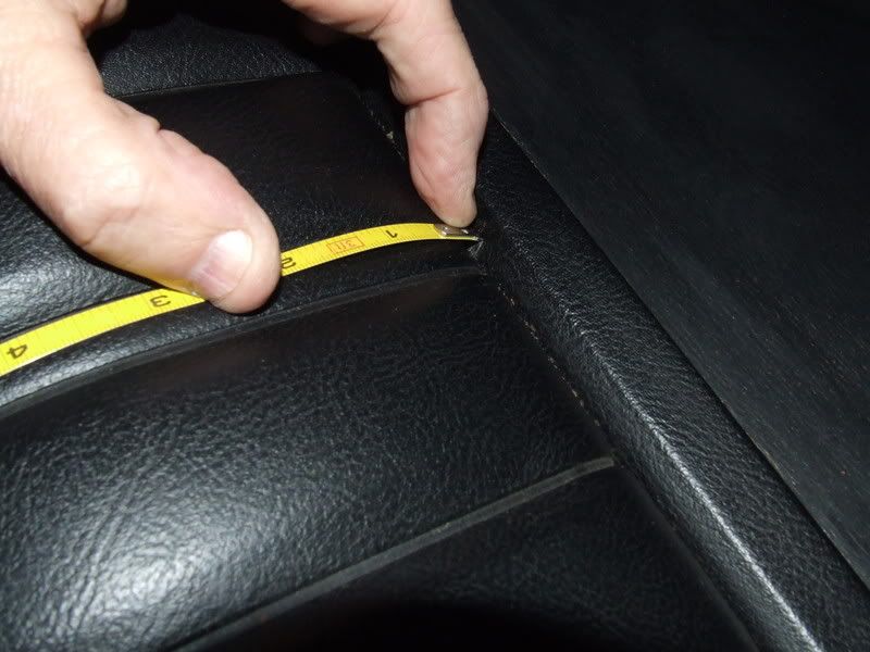

Maybe I measured from a different spot than Rick but here's what I got for the rear seat. Can't be much help with front buckets; I chose the cheap seats! https://www.yenko.net/ubbthreads/imag...mlins/wink.gif
Straight on shot.
http://i101.photobucket.com/albums/m...y/DSCF0597.jpg
Measuring from here...........
http://i101.photobucket.com/albums/m...y/DSCF0601.jpg

Well I guess GM varied in their placement of the medallions. https://www.yenko.net/ubbthreads/imag...mlins/hmmm.gif I measured from the same place you did Dennis, and this for sure is the original back seat.
Wonder if anyone else has another measurement for their back seat medallions? https://www.yenko.net/ubbthreads/imag...lins/dunno.gif
