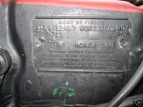

Look at the trim tag being advertised with this 69 Camaro -- good laugh

I think a guy on TC answered the riddle.
That could be the color the car is painted now, and that label was for future reference. Makes sense if 38M is a valid 1981 Honda paint code.
Seller says he has since removed the stickers.
Donutblue 10-30-2008 07:56 AM
Re: Trim tag -- good laugh
It may make sense for the little dab of Green below the painted over sticker
G-38M-S Muscat Green Metallic --- Honda Paint Code
RamAirDave 10-30-2008 08:06 AM
R-38M Tudor Red Met. C/C Accord, Prelude, Civic 79-81
http://www.1stgencivic.org/1stgenera...aint_codes.htm
Donutblue 10-30-2008 08:14 AM
Dave, I took it off the Honda Motorcycle codes
http://www.vsource.org/VFR-RVF_files...PaintCodes.htm
RamAirDave 10-30-2008 08:20 AM
I have no idea about Hondas, nor do I have any idea what Tudor Red Metallic looks like, but that would be my guess.
ANDY M 10-30-2008 05:41 PM
Why is the year missing from the top line? The body # is 12467_NOR333002.
Mr70 10-30-2008 07:10 PM
It's not missing,it's just shown differently from the VIN plate,which was typical.
It's only reflected in the beginning as ST 69.
I've yet to see a "real" trim tag from that period showing the model year after the bodystyle number and before the plant abbreviation,as you indicated too.
