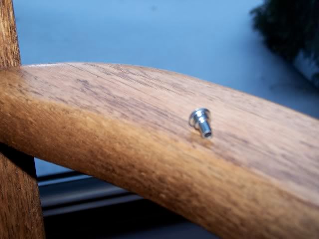

Rivet question
ElCamino vent windows, are held to the frame with a small rivet. This is the rivet that is sold to replace the one I had to drill out to remove the glass/chrome frame. The end is hollow. Does anyone know how to install/crimp this rivet? Special tool? Certainly not any type of rivet, I've used.
http://i533.photobucket.com/albums/e...e/100_2098.jpg
m22mike 12-22-2008 05:01 PM
Re: Rivet question
Bill
Yes they required a special die for the hollow end. Then they were squeezed. Same as a riveted brake shoe.
Sorry I can not help on th tool.
Are the rivets you bought stainless steel or plated steel ?
Mike

firstgenaddict 12-22-2008 06:15 PM
Re: Rivet question
Does anyone have a photo of a crimped one? Then we could figure out what would be required to form the new one...
Probably something with a male die to go into the end of the rivet a short chamfer to roll the rivet...
L78steve 12-22-2008 07:20 PM
Re: Rivet question
Look up (Hanson Rivet) on-line they have the rivets and the tools to crimp them .
Bruce 12-22-2008 08:17 PM
Re: Rivet question
Here's a picture of what they look like, tubular rivet tool
http://i478.photobucket.com/albums/r...ubular_set.gif
Ls6 Ragtop 12-22-2008 10:48 PM
Re: Rivet question
You can also try www.rivetsinstock.com That's the website for jay-cee sales and rivet co. They have just about any rivet you can think of and also stock the tubular set tool shown.

m22mike 12-23-2008 01:28 AM
Re: Rivet question
Bill
These guys have the rivet sets too.
http://www.hansonrivet.com/w83.htm
There made for a rivet squeezer, but for a one time application you might insert the die into a piece of round stock and lightly form the shop head by hand with a hammer.
Mike
Dha....They also have these....
http://www.hansonrivet.com/w78.htm

firstgenaddict 12-23-2008 03:17 AM
Re: Rivet question
That is the precise tool I had imagined in my head... trippy... da ding ding zzz da ding ding zzz....
