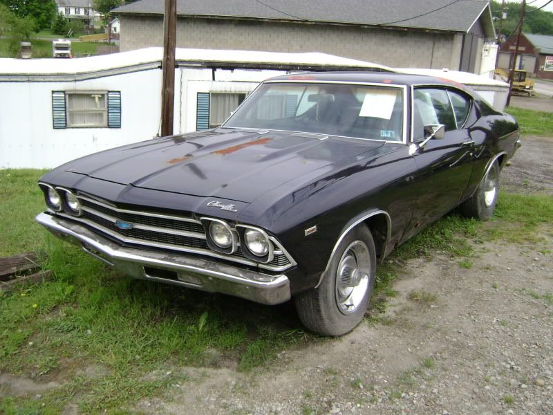

Supercar_Kid 05-29-2009 05:32 AM
Could this be a '69 COPO Chevelle?
Can anyone tell me if this could possibly be a COPO Chevelle by the VIN and trim tag info?
http://i79.photobucket.com/albums/j1...r/DSC06580.jpg
http://i79.photobucket.com/albums/j1...r/DSC06579.jpg
427king 05-29-2009 05:33 AM
Re: Could this be a '69 COPO Chevelle?
Not a copo
ssl78 05-29-2009 06:07 AM
Most all copo Chevelles were built in Baltimore only one was built in CAL. There are no known copos built in Kansas. That doesnt even look to be a SS I do not see a L on that trim tag
Supercar_Kid 05-29-2009 07:57 AM
Thanks guys, so much for me finding a diamond in the rough...sure looked like one at a glance wouldn't you say?

firstgenaddict 05-29-2009 10:43 AM
I'd check the rear code for the heck of it...

Keith Tedford 05-29-2009 07:22 PM
The COPO rearend code would be KQ.

Supercar_Kid 05-31-2009 06:04 PM
The car is in the Pittsburgh area. It's definitely no COPO though...as it has drum brakes and A/C...just a rusty Malibu. https://www.yenko.net/ubbthreads/imag...s/confused.gif
