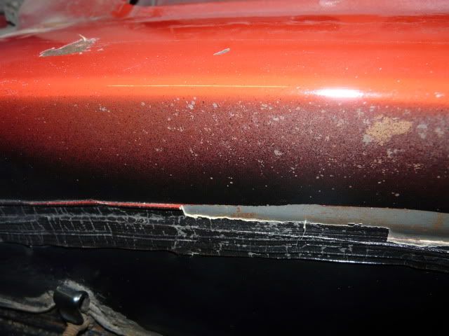

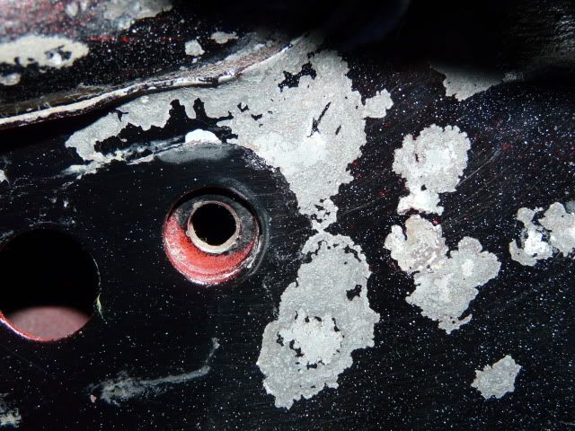

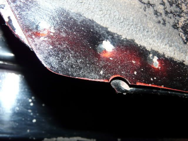

beater68427 06-22-2009 04:51 PM
Re: First Gen Underbody
My 68 shows 13K miles and I believe them to be true, the Body was painted red first then the bottom and firewall were painted black then last undercoating was sprayed in rear wheel wells. It does not appear to have any primer on the bottom side.
http://i226.photobucket.com/albums/d.../beater024.jpg
http://i226.photobucket.com/albums/d.../beater013.jpg
http://i226.photobucket.com/albums/d.../beater005.jpg
