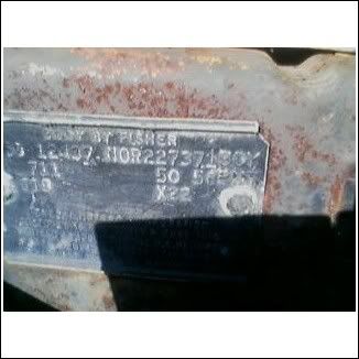

JK98SS 07-14-2009 03:20 AM
69 Camaro trim tag info (sitting in a field)
x22, SS396 car?
http://i30.photobucket.com/albums/c305/JK1066/3-1.jpg
http://i30.photobucket.com/albums/c305/JK1066/2-1.jpg
Charley Lillard 07-14-2009 04:36 AM
Re: 69 Camaro trim tag info (sitting in a field)
SS 396 with Style Trim...Alot of the time RS SS..White
Cool find.
JK98SS 07-14-2009 06:19 AM
The car is rough. Missing the engine and trans. 10 bolt under it, auto console in it. How can I find out which version 396 it came with.
JK98SS 07-14-2009 06:22 AM
The crazy thing is, it is less than two miles from my house.
RamAirDave 07-14-2009 08:16 AM
Fuel lines and tach (if equipped) if original are two good clues.
jannes_z-28 07-14-2009 09:55 AM
If X22 it should have a 12-bolt and multileafs. Discbrakes.
Jan
Kurt S 07-14-2009 07:34 PM
1 or 2 fuel lines? You can see them under the hood on the passenger side, attached to the subframe.
