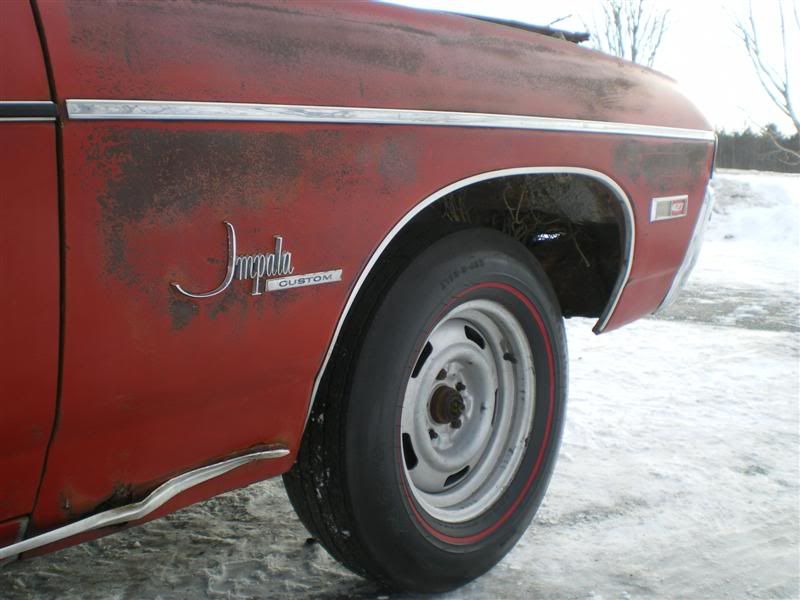

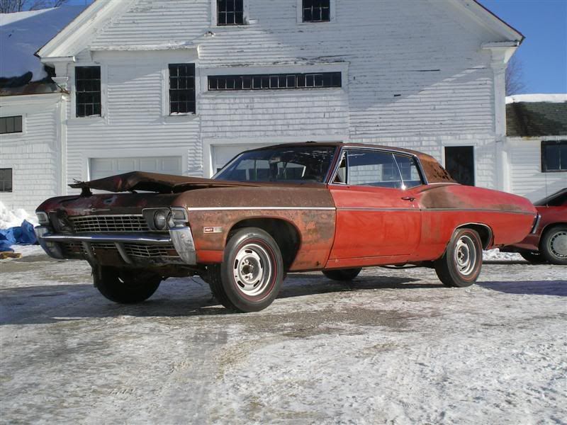

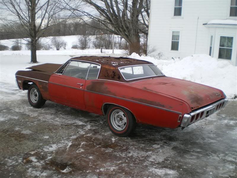

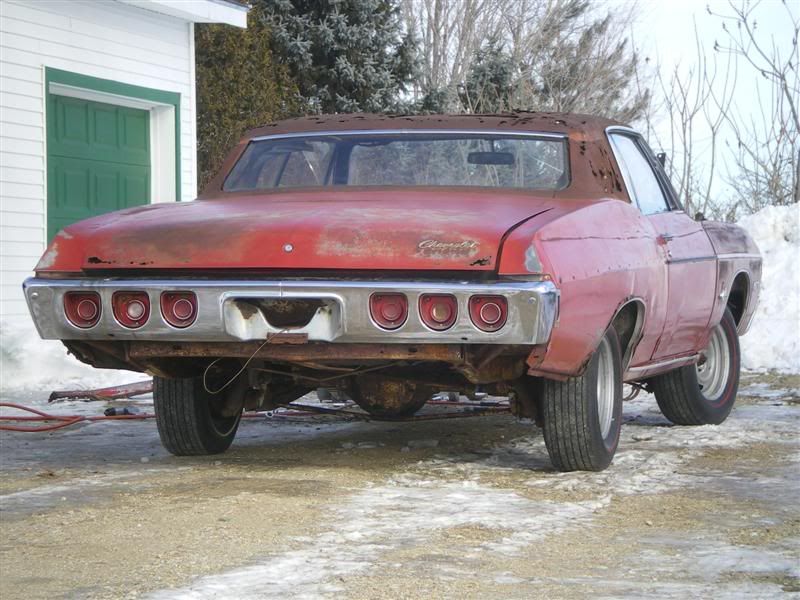

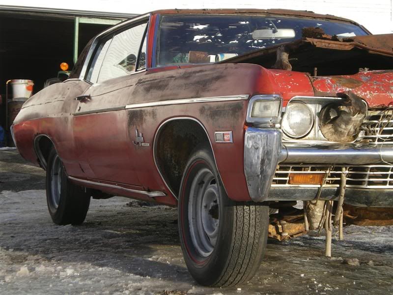

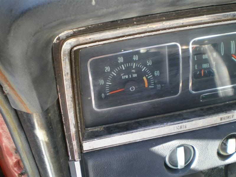

I thought I would share my latest project with everybody on here. It ‘s a Matador red 68 Impala Custom coupe L72 M21 3:73 posi. I’ve been in contact with the previous owner since last February and finally got a chance to pick it up after Christmas. The trip was 4272 miles and we had a blast. The car sat in a field in Cameron, TX from about 1973 until 2008 when it was removed and brought to Burleson TX. It has 42000 miles on it. The engine and tranny were pulled for a 69 Camaro drag car in 1973 and the owner of the property passed away shortly after leaving all the cars to sit on the property until a few years ago when his wife started selling things. I am very excited about the car and I thought you all would enjoy seeing it. Other options include U14 special instruments, 806 full vinyl interior, F41 special performance suspension, N40 power steering, and ZJ9 auxiliary lighting package (front fender lights, ashtray, courtesy, underhood). A black vinyl top was added to the car early on, and that is what got the roof so bad. I have no idea what wheels/tires it came with originally, but I plan to go with ZJ7 rallys and redlines.

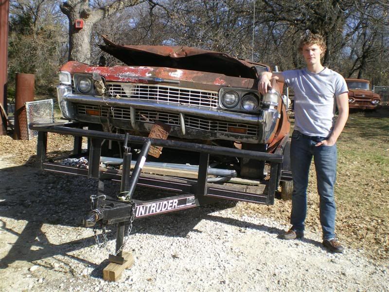

I finally get to see the car! Burleson TX 12/28

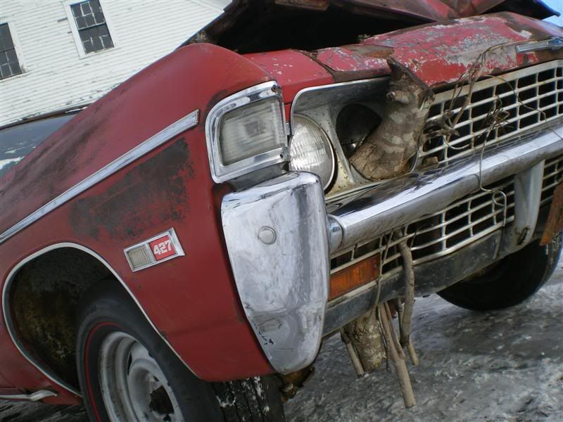

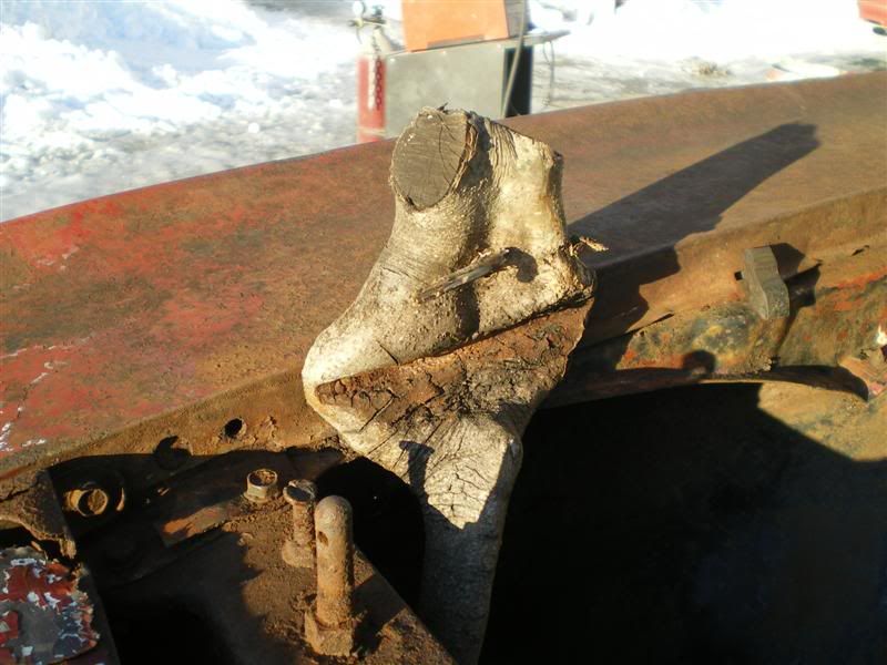

This is one of the branches which had squeezed up through the hood-fender gap..

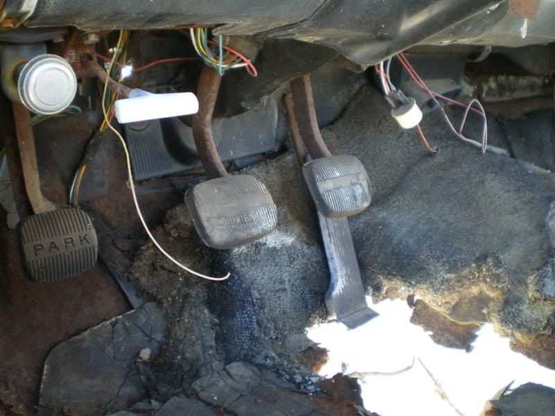

Plain style round pedal pads. The upgrade was square pedal pads with stainless trim.

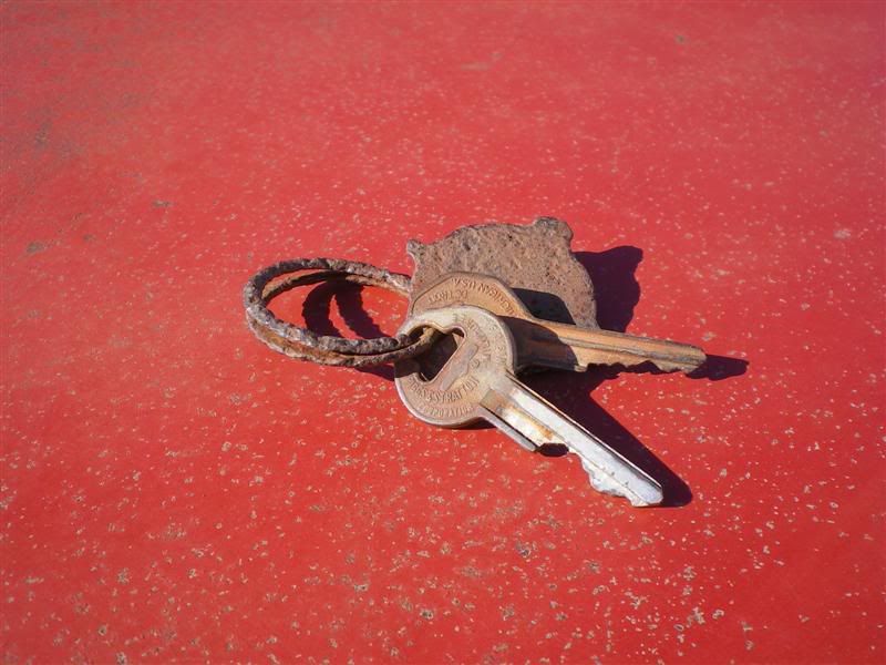

Original keys

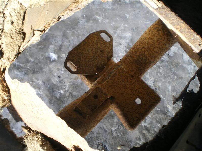

4 speed specific crossmember intact and clean

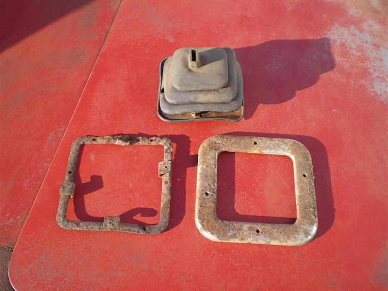

4 speed interior stuff was in the trunk

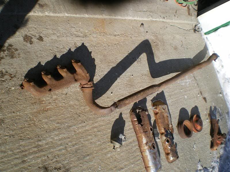

original LH manifold and engine pipe

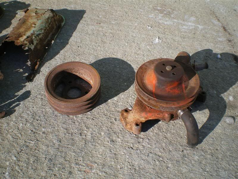

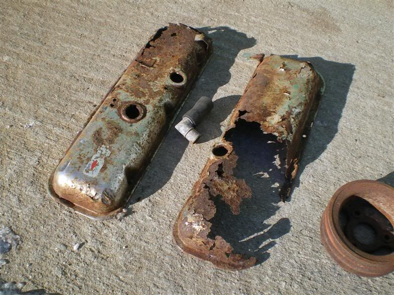

original deep groove crank, waterpump pulleys

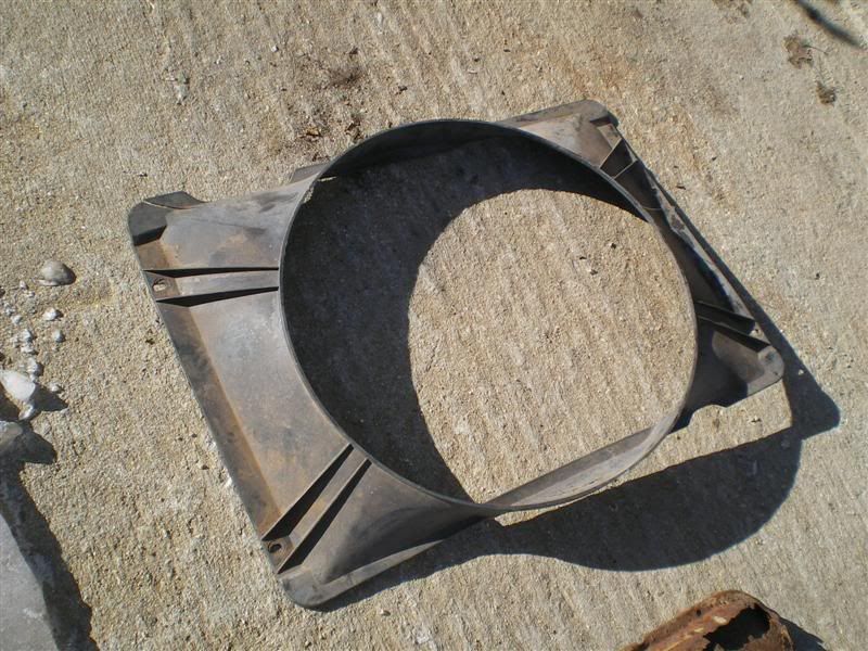

Original BB fan shroud

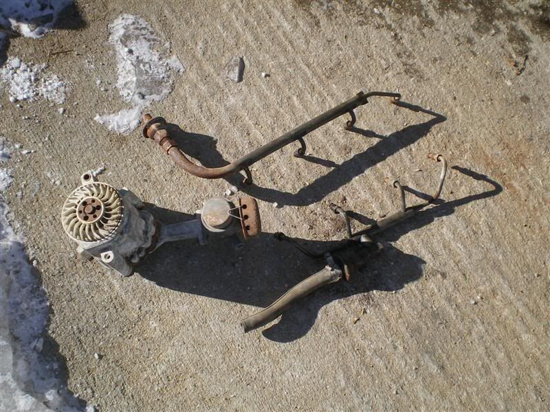

Some 69 smog stuff was in the trunk

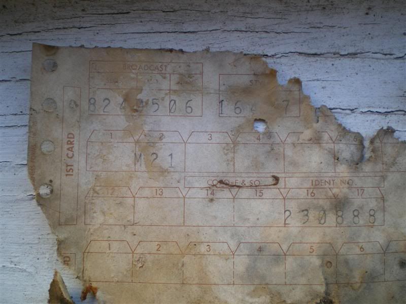

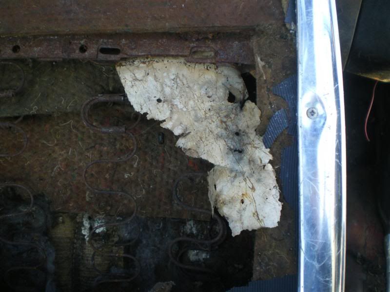

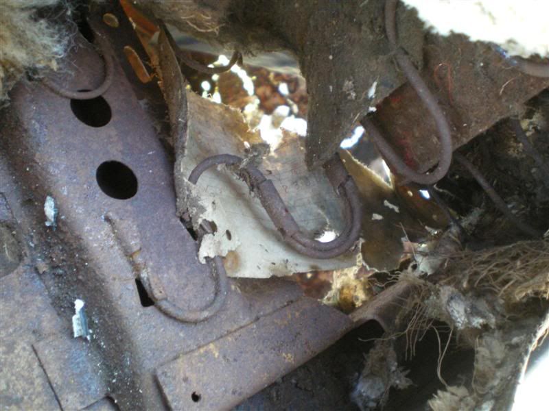

This was a cool surprise! We found the Flint Fisher body broadcast card in the seat the other day! This was done specifically by Flint, and we have found several examples in the same location. During seat assembly, a worker in the soft trim shop would stick this card between the RH front seat back skeleton and spring. They were only concerned about the color cover to install, but as you can see the card also shows the vehicle body number and M21.

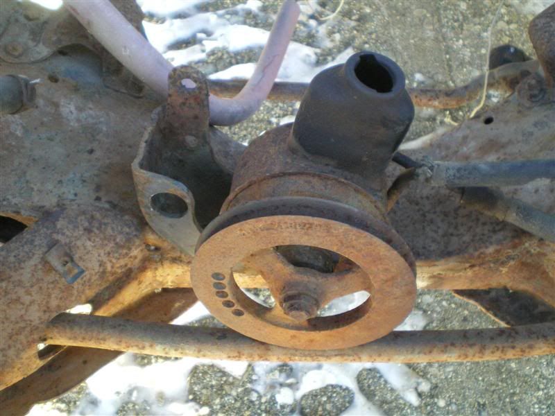

Power steering pump with its original cast iron deep groove pulley. I also found the original dated power steering belt in the trunk.

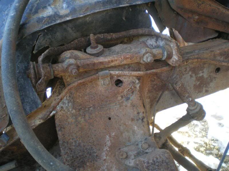

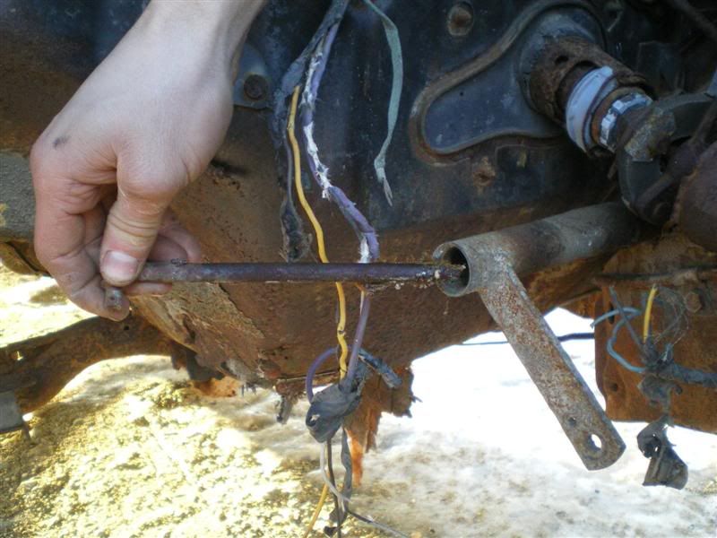

Z bar with clutch fork push rod stuffed inside

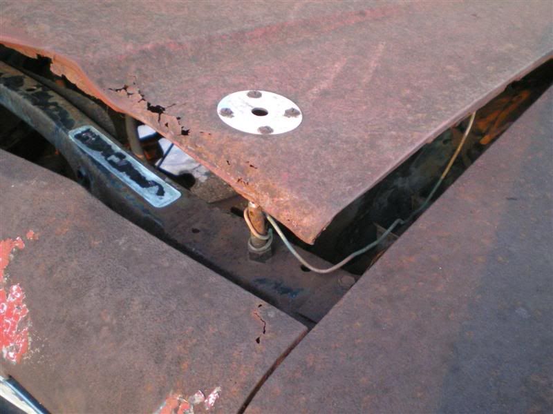

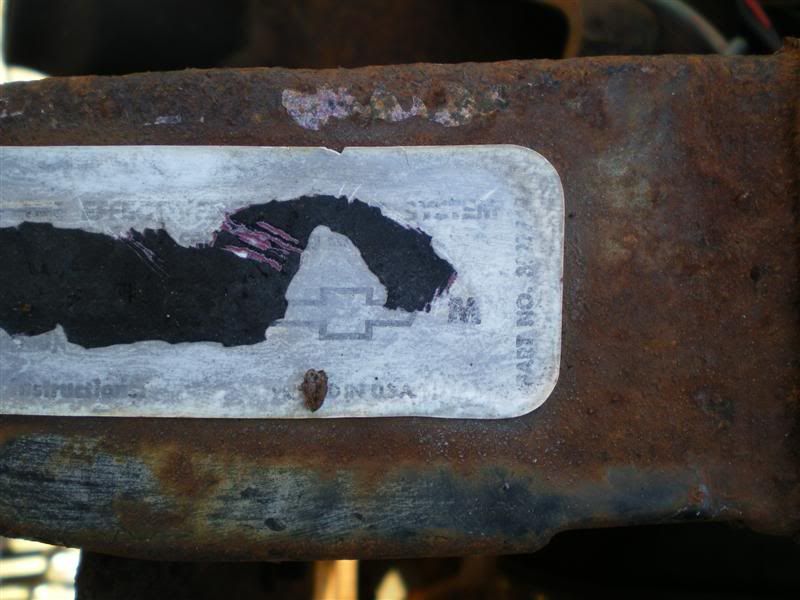

M code (L72) core support emissions sticker

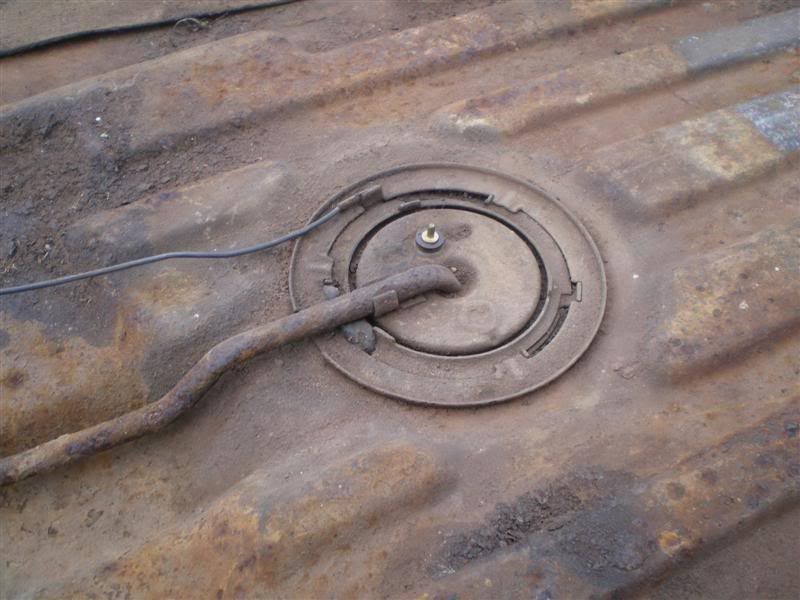

Single 3/8 fuel line

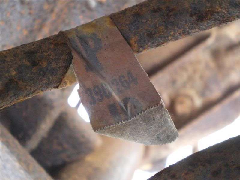

JP code F41 rear spring tag

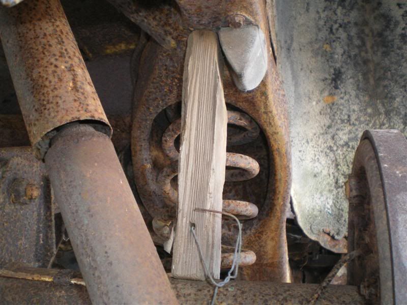

The guy who owned the farm with this car put wood blocks like this under every car in the field.

Cool car, but wow....... I've never seen a roof that bad!

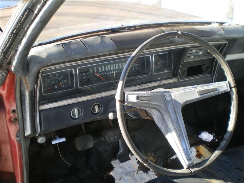

Really nice find, If that resto was left up to me there would be condo's in those fields before I was done lol. -- I see that's a true "radio delete".
