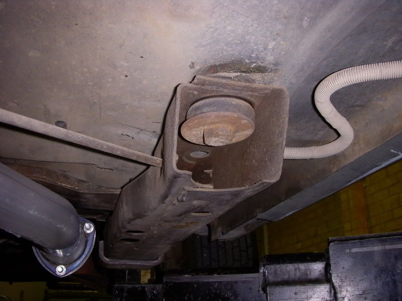

One my orig 69Z, there is a paper type insulator/sleeve between the floor and the top of the rear subframe bushing.
2 questions:
1. What is this for and should this be replaced as part of the restoration process?
2. Is there a source for these?
Thanks in advance for the advise.
firstgenaddict 02-08-2010 04:15 AM
Re: Rear Subframe Bushing - paper type insulator?
Ed,
The "paper" is the tape that was applied over the two rear subframe bolt holes while the body was being tested for water leaks on the Fisher side. The tape was never removed after the tests and the subframe bolts pierced it during assembly on the Chevrolet side.
I believe it is a 2" black or dark masking tape.
I have some photos of some survivor ones.
James

m22mike 02-08-2010 05:56 PM
Here is one Rick
http://i18.photobucket.com/albums/b1...DSCN2840-1.jpg

SS427 02-08-2010 07:43 PM
Thanks Mike. I found something very similar to that on the 68 Yenko and was pretty sure that was what it was. Thanks for posting to pic.

CamarosRus 02-08-2010 08:15 PM
Thought I'd seen pics somewhere showing how top rubber bushing was taped to subframe, prior to body being bolted on.
Now I read where tape was on floor of body for a water test ??????
