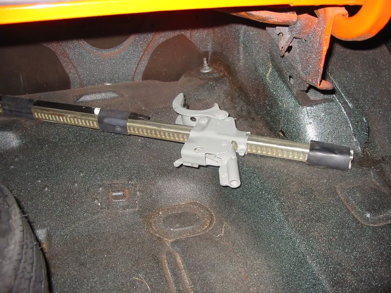

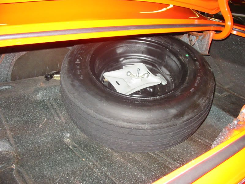

place ment of jack
can someone show me a REAL pic of the wright position of the jack bar.
and does the tire face up or down. thanks

Assembly manual shows the jack under the tire from 10 oclock to 4 oclock with the jacking mechanism 7.5 inches from all the way up, with the upper end of the jack at the 4 oclock position with the hook on the jack and the hook also towards the back seat .Also says to put the valve stem down.Wrench is clipped or banded to the jack on the left end with the socket part pointed toward the left quarter panel.Hope this helps.

i have a L bracket in the middle of the back seat up in the middle of the top near the shocks mybe the one end gos in there??

http://i118.photobucket.com/albums/o...1-5142_IMG.jpg
http://i118.photobucket.com/albums/o...1-5143_IMG.jpg

thanks so much.
