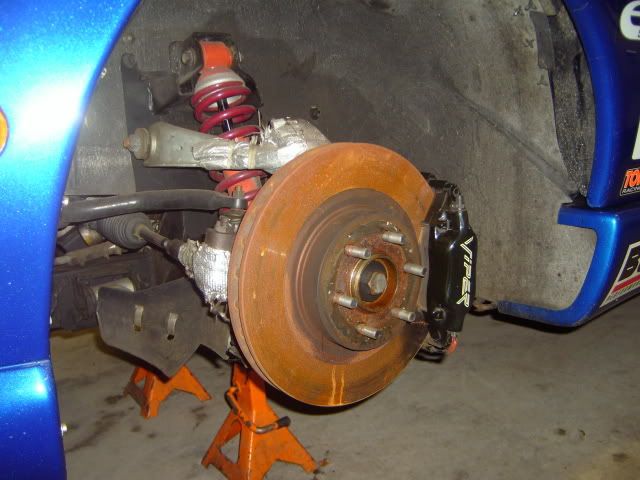

Well, since I'm done with the T/A I decided to get the old Project Pit Viper cleaned up since it has been sitting for 10 years in the garage serving as a work bench/parts storage rack for at least the last 6 years.
http://i599.photobucket.com/albums/t...c/S7005602.jpg

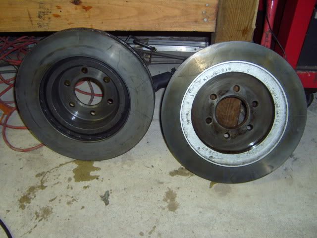

I needed to get the rusty rotors cleaned and didnt want to just drive them to scrape the rust off. So I pulled the wheels and rotors and then soaked the rotors in the safest rust remover liquid. It was amazing. In just over 15 minutes the rust was gone. The key with this stuff is to get an aquarium heater and let it heat up the liquid to 70 or 80 degrees. The rust just dissolves away.
Here are the rotors before:
http://i599.photobucket.com/albums/t...c/S7005607.jpg
http://i599.photobucket.com/albums/t...c/S7005608.jpg
and while soaking:
http://i599.photobucket.com/albums/t...c/S7005609.jpg
And after about an hour:
http://i599.photobucket.com/albums/t...c/S7005613.jpg
http://i599.photobucket.com/albums/t...c/S7005614.jpg
