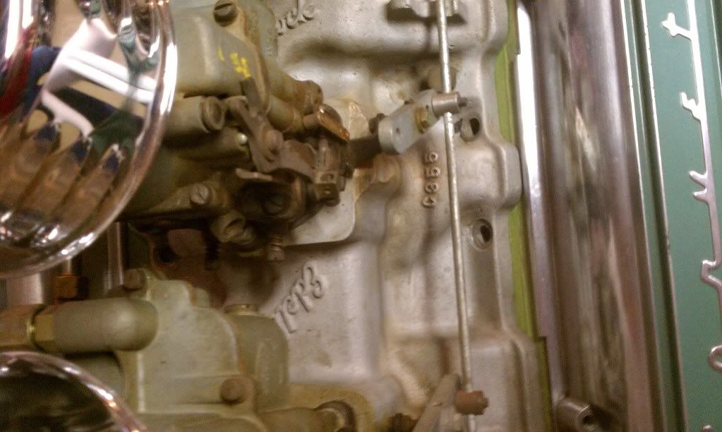

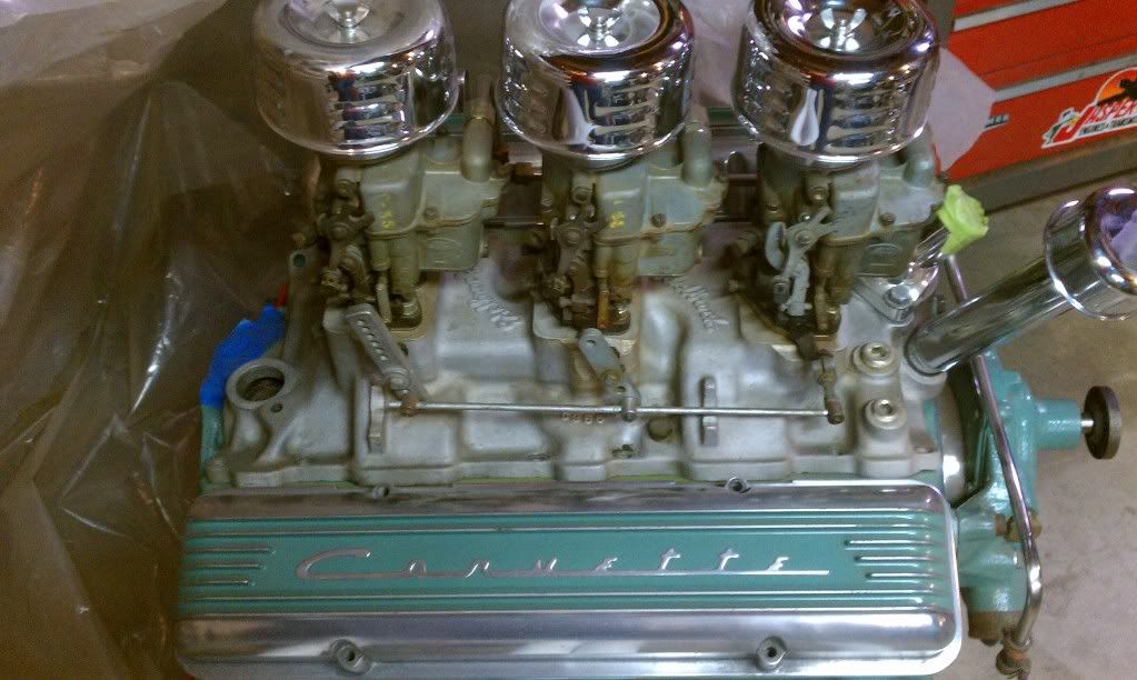

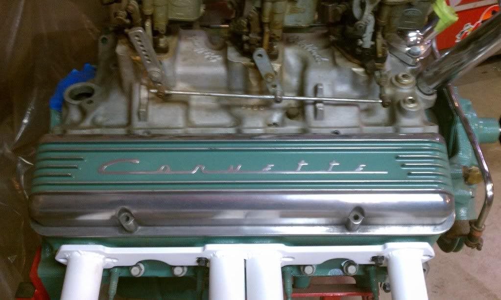

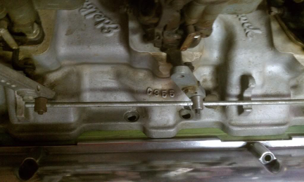

A friend is building a 29 Ford 5 window. He build an old 283 to put in it. He came across some neat stuff. Just looking to pick some brains around here for info on them.
If I recall, The block is from a 61 Corvette and 56 heads, or vice versa. The intake is an old Edelbrock tri power set up with factory rebuilt ford carbs.He was told the casting date is March 55. Which should be early production since the sbc came out in 55.

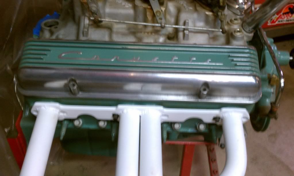

Then the old Corvette covers with the tall, offset bosses.

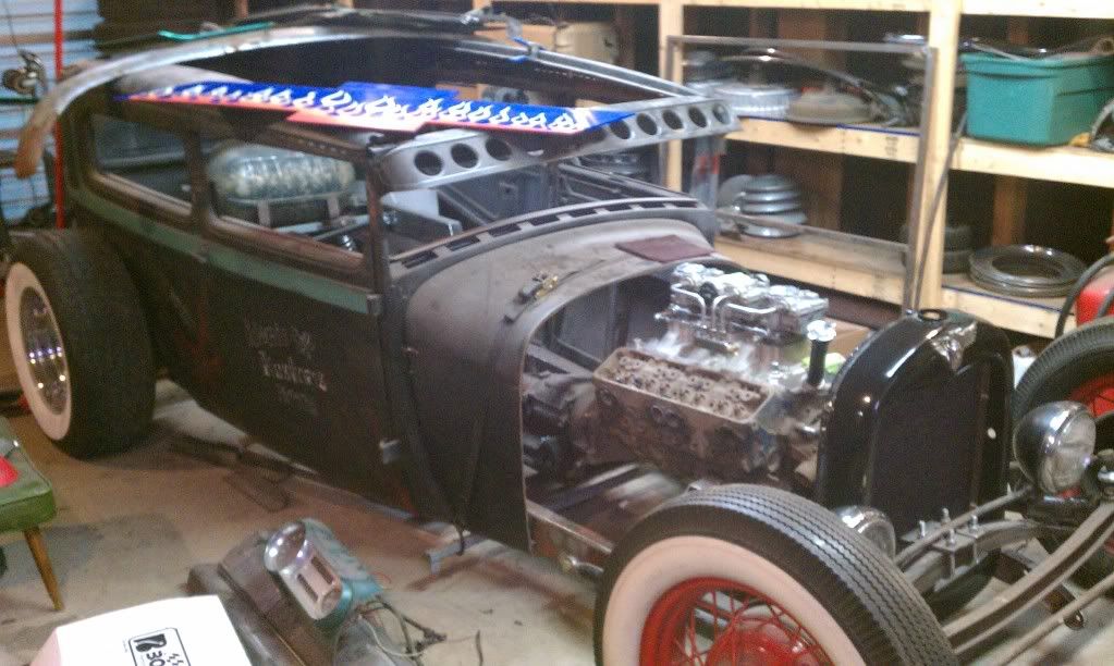

Going in this project. Not bad for a young guy in his early 20's.

Cool ol' sedan. What's happening with the trips that are on the mock-up engine in the car?

Maybe I'm reading it wrong, but if it's a pre early 57, it's probably a 265. 283s didn't start until after 57 production was started. The 57 I had was a 265.
Nothing wrong with that. She ran very well. Seems people forget the 265.

Googling on Edelbrock C355 gives you some info. It is for the early 265 CSB engines. A later model C357 is for the 283.
The 265 have very small ports and the C355 matches them.
Here is some info I found: http://www.jalopyjournal.com/forum/s...d.php?t=405852

I think it is a 61' 283 with 56' heads.
