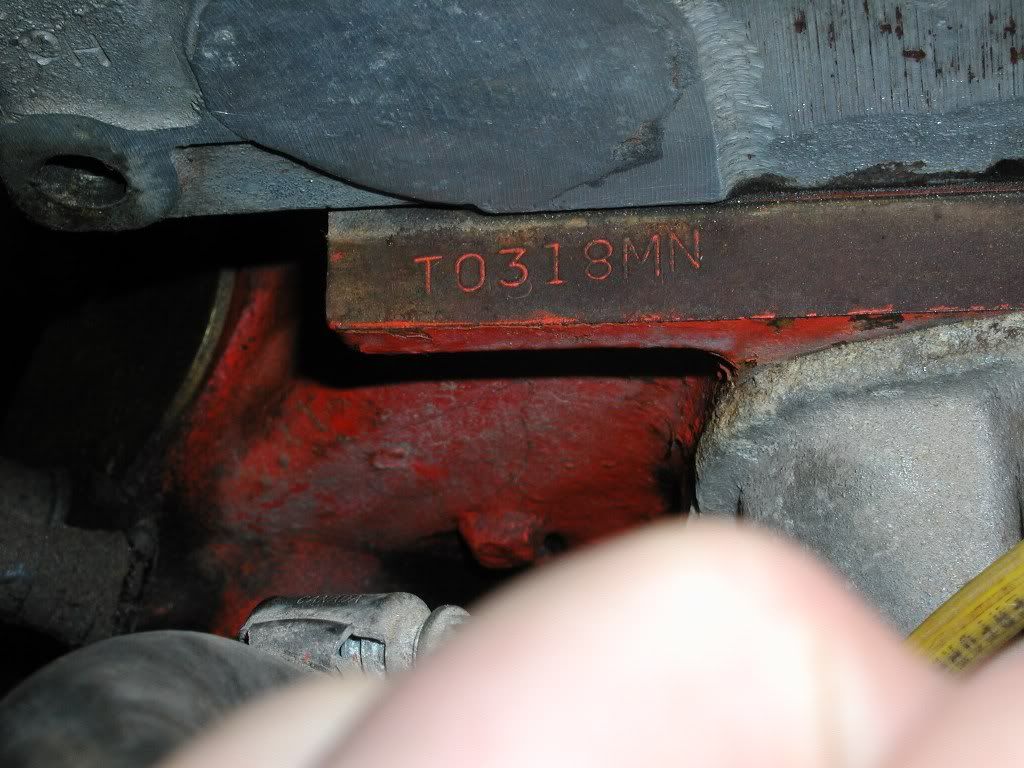

69 Post Sedan 01-20-2011 04:53 AM
Re: 512 MN Block - Legit or Re-stamp
I think it's fake. The numbers and letters aren't even close to the picture I have of a real MN block. Compare the &quot;T&quot;, &quot;0&quot; and especially the &quot;M&quot;. They are also too straight and too deep plus as Rich stated, the broach marks suck. [img]<<GRAEMLIN_URL>>/thumbsdown.gif[/img]
Kurt
http://i300.photobucket.com/albums/n...uff/COPO-9.jpg

talwell 01-20-2011 08:34 AM
<div class="ubbcode-block"><div class="ubbcode-header">Originally Posted By: 69 Post Sedan</div><div class="ubbcode-body">I think it's fake. The numbers and letters aren't even close to the picture I have of a real MN block. Compare the &quot;T&quot;, &quot;0&quot; and especially the &quot;M&quot;. They are also too straight and too deep plus as Rich stated, the broach marks suck. [img]<<GRAEMLIN_URL>>/thumbsdown.gif[/img]
Kurt
http://i300.photobucket.com/albums/n...uff/COPO-9.jpg </div></div>
In your known good &quot;MN&quot; block I notice that the &quot;0&quot; has straight sides with only the top and bottom edges being rounded off. In the eBay one, the entire number is rounded.
As well, all the fonts appear just a little off without even considering the VIN date issue.
Fast67VelleN2O 01-20-2011 01:20 PM
The center peak of the letter M on the ebay block comes all the way to the bottom. The center peak on the letter M on 69PostSedans's block doesn't.
