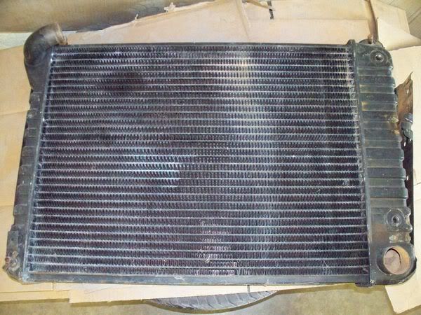

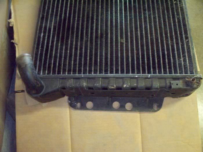

deuce-less 01-20-2011 09:20 PM
Re: Proper rad for L-78 nova
here is a pic of my assembly line &quot;freak&quot;, a late 69 production turbo 400 L-78 nova, born with curved neck radhttp://i617.photobucket.com/albums/t..._radiator1.jpghttp://i617.photobucket.com/albums/t..._radiator2.jpghttp://i617.photobucket.com/albums/t..._radiator3.jpghttp://i617.photobucket.com/albums/t..._radiator4.jpg
