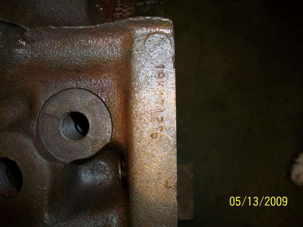

69 Post Sedan 01-28-2011 03:23 PM
Re: 69 Chevelle BBC Vin stamp
I have had blocks from both plants and they were just as you described. Baltimore VIN was on the pad and Kansas VIN was down by the oil filter.
But, as Phil stated....never say never.
Baltimore VIN
http://i300.photobucket.com/albums/n.../396Block2.jpg
Kansas VIN
http://i300.photobucket.com/albums/n...e/100_0971.jpg
