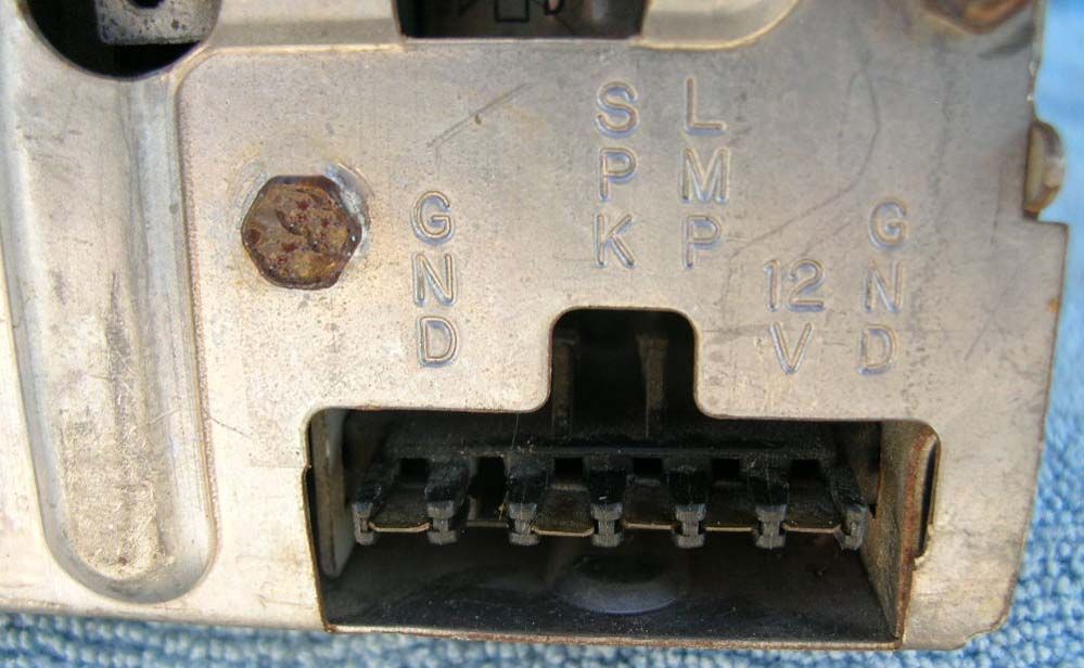

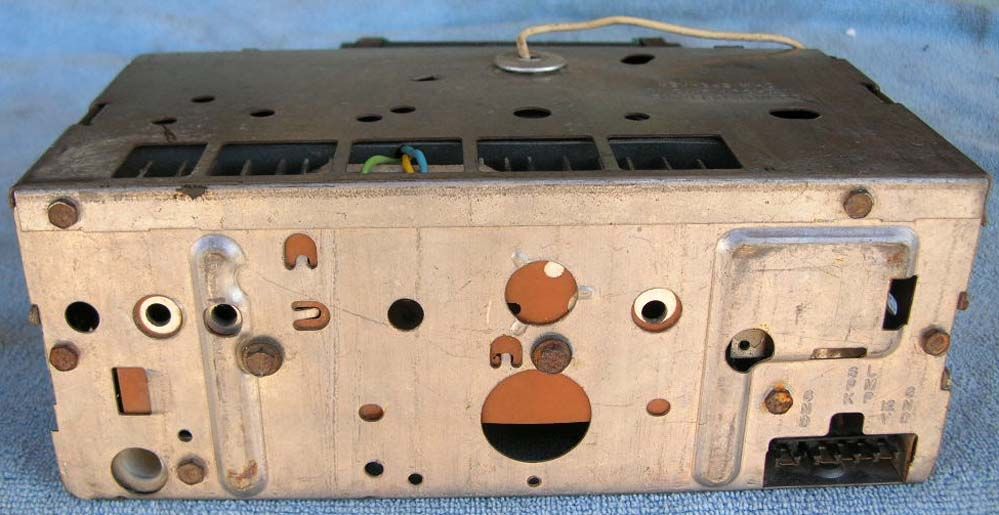

al8apex 07-05-2011 04:42 PM
Re: Installing a 1971 AM/FM Radio in a 1969 Camaro
here is a 70 radio plug:
http://i8.photobucket.com/albums/a26...v06/70radc.jpg
http://i8.photobucket.com/albums/a26...06/70radcu.jpg
can't remember what a 71 looks like
bergy 07-05-2011 05:18 PM
My '71 takes the same pig tail. They repro that one. Thanks Again - bergy
