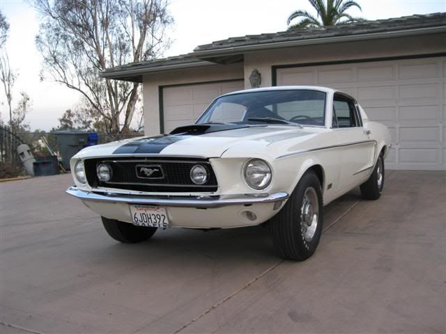

68.5 Cobra Jet
I finally finished the restoration of the R code Mustang. Wimbledon White
Black Standard Interior
Factory 4.30 Gears
4 Speed
Radio Delete
It was an honor to be selected for the month of May in the up coming 2012 428 Cobra Jet Registry Wall Calendar.
This car is 1 of 8 with the above specs known.

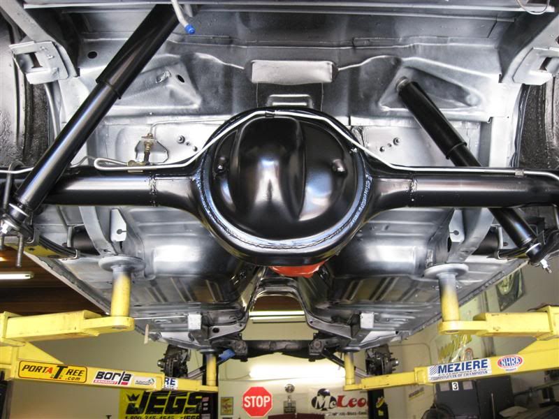

Sportyworty 11-25-2011 04:25 AM
Re: 68.5 Cobra Jet

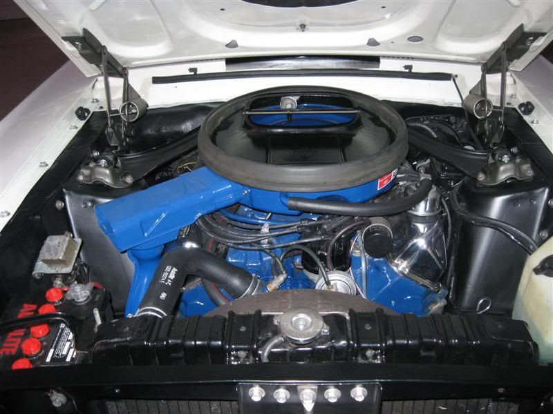

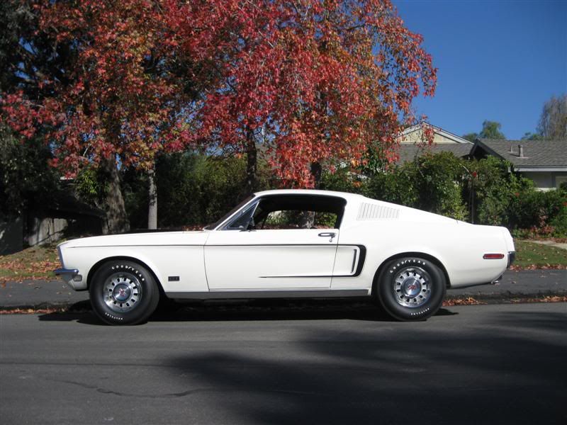

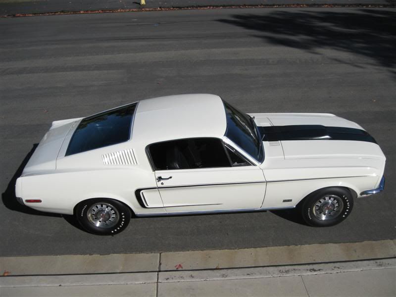

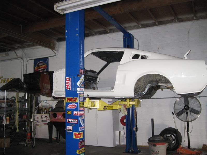

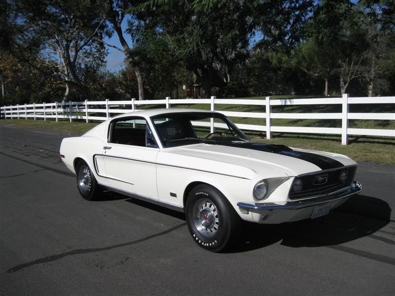

Thank you for the compliments. As some of you know it is a lot of work but very satisfying.

Sportyworty 11-25-2011 07:40 AM
Re: 68.5 Cobra Jet
She is not a Concours Gold candidate but very few reproduction parts were used or NOS for that matter. Even that battery is a real 69 dated Acid fill that was routed out. I like restoring and detailing original parts. The body was clean with the exception of the 4x4 holes in the fender aprons where it had Belanger fender well headers in the race years. I had to butt weld a section in there but did not disturb the original vins.
Old school CCH-300 Crane Cam. Not what most would use. Lots of duration and not so much lift. Sounds like a big gun though. With the light body, 4.30 gears and Ram Air who needs anything under 2500 rpm lol even though it is all over at about 5500. These long stroke 428's are fun on the street...no need to speed just saw away on the ol gear box and feel the thump in your chest. Perhaps a rocking chair would be fitting.
