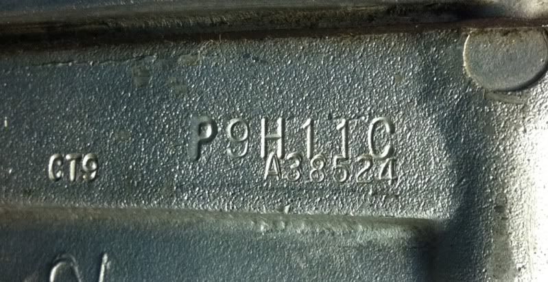

69 M22 stamps??
Can anyone make heads or tails out of this stamp under the build stamp?
http://img.photobucket.com/albums/v6...o/a5076108.jpg
Mr70 11-26-2011 12:23 AM
Re: 69 M22 stamps??
It's a Muncie service replacement Transmission for a Chevrolet.
C=Chevrolet
T=Transmission
9=1969 model year.
A38524=Stands for the Sequence number.
They started at #35000,and went to 44999.
They went back & reused sequence #'s if need be during every production year,and when they did,they designated it with the letter A first.

Nice piece. I don't see many Chevrolet service cases stamped with an assembly date.
-Matt
DarrenX33 11-26-2011 12:46 AM
Re: 69 M22 stamps??
Wow. Thanks Rick I appreciate that.
