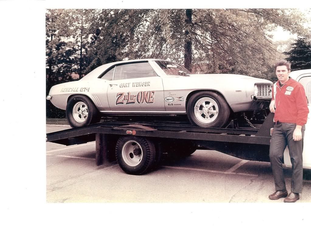

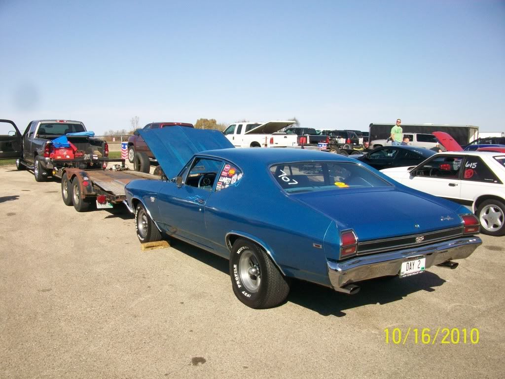

69 Post Sedan 12-10-2011 03:44 PM
Re: Day 2 tires--- what are you looking for?
I'm running L60-14's on 7&quot; rims. I'm not saying it's right but they seem to be fine. To me, that's what they did back in the day.
http://i300.photobucket.com/albums/n...e/100_4393.jpg
Here is a perfect example of what I'm talking about. How wide are those rims.....6&quot; maybe 7&quot;?
http://i300.photobucket.com/albums/n...es/4270011.jpg
Let a little air out of them and they'll hook!!!!
http://i300.photobucket.com/albums/n...nOct162010.jpg
Most cars ran 14&quot; rims back in the day, that's why it's so hard to find vintage 15&quot; these days. L60-14's were THEE tire to have in the rear. IMO
