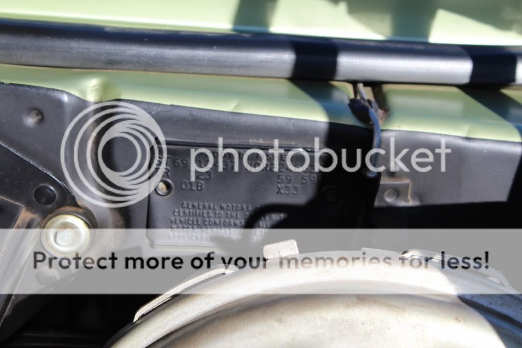

Can i have some feedback on this car - anyone know of it?
Do the dates and stamps and trim tag look good.
All info appreciated - buddy of mine is interested in the car.

any views on the stamp of the mtr and vin. does the trim tag look real?

Eddie
The picture of the pad is to poor, and has to much paint on it to make a call. The trim tag looks OK but may have been off the car at some time.
The asking price is too high for the quality of the resto I see in the photos.
Agree the spoiler and hood most likley added.

All in all a much better quality than the run of the mill e-bay cars. Agreed a better pic of the stamping is needed. Probably worth the money if you like it and want it badly enough.
