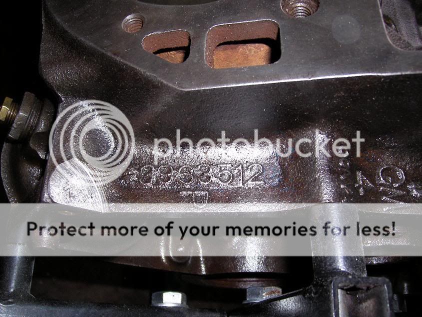

Carleen 01-12-2012 11:40 PM
Re: 1969 427 "512" Block Question
<div class="ubbcode-block"><div class="ubbcode-header">Originally Posted By: SuperNovaSS</div><div class="ubbcode-body">I just looked in, &quot;Chevrolet by the Numbers&quot; by Alan Colvin. He says the change was made Nov 17th, 1969. The date location was changed at the same time the distributor boss was changed from the high to the short tower design.
Jason </div></div>
Its not true.
http://i517.photobucket.com/albums/u331/Nikkewi/003.jpg
