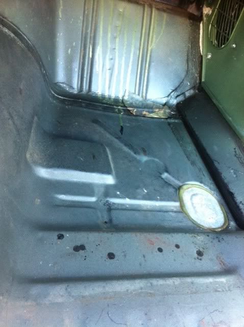

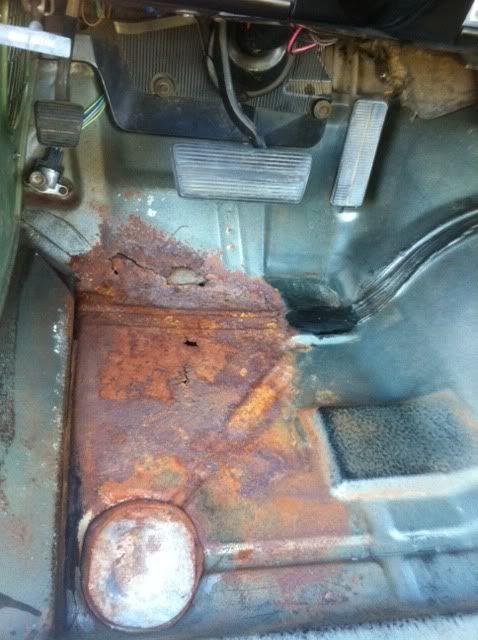

From my 29K original mile '69 Nova. Guess I should be thankful for the rest of the floors, but damn you wintery boots. Yet another reason why I hate the snow. Time to pull out the MIG...
http://i256.photobucket.com/albums/h...ova/photo4.jpg
http://i256.photobucket.com/albums/h...ova/photo2.jpg
http://i256.photobucket.com/albums/h...ova/photo8.jpg
that's red oxide primer in the rear. The floors are surprisingly green, and a dark green at that (for a Frost Green car)....

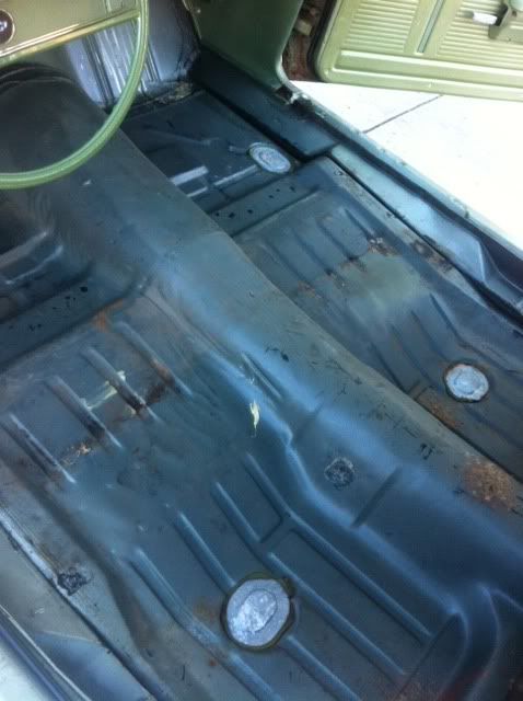

http://i256.photobucket.com/albums/h...ova/photo5.jpg
This car was always garaged, I believe. Despite other car rust issues, the bolts remain rust free.

WILMASBOYL78 01-25-2012 02:08 PM
Re: stupid snowy salty wet boots.....
Very common issue with Novas...especially if they have the rubber floor covering. They were very prone to water leaks in that area and the moisture would collect under the mat....the wet boots may have contributed...but I would check for water leaks while you are in the process...lower corner of windshield area was common spot...get out the hose!
The color of your floors looks just like our 31k mile 69 granny.
If that is the worst of any rust issues you are doing fine.
wilma
