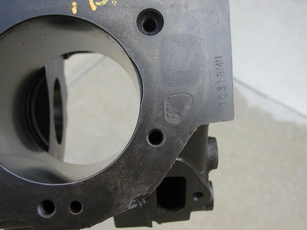

Can someone please tell me if this is a restamp
THANK YOU

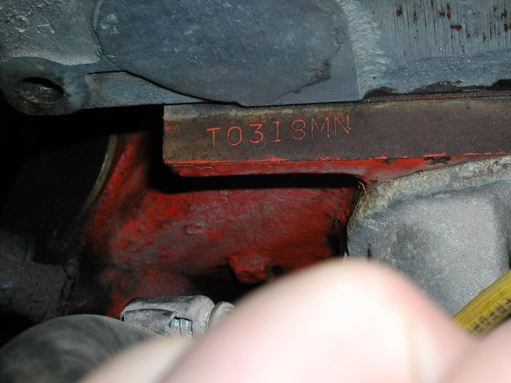

It's sure looks like a restamp to me. Look at the &quot;N&quot;....it's crooked compared to the &quot;M&quot;. Plus, it appears to have been tampered with with all of the pits (acid).
The letters are not as clean as an original. IMO
Kurt
http://i300.photobucket.com/albums/n...rts/COPO-9.jpg
http://i300.photobucket.com/albums/n...tMNStamp-4.jpg
jannes_z-28 03-29-2012 09:32 AM
Re: COPO BLOCK New Pics
I think that the MN is tampered with, could originally been LI.
BTW isn't 1231 an very early date for this engine?
Jan
Rixls6 03-29-2012 10:42 AM
Look at the difference in the depth of the center v of the &quot;M&quot; on the one being asked about compared to Kurt's. That alone would make me wary of a restamp.
Fast67VelleN2O 03-29-2012 01:20 PM
You can clearly see where there used to be a vin stamped onto the engine pad as well. Right to the right of the MN stamping. It looks like a bunch of pitting now, however, there was definetly a vin there at some point.
William 03-29-2012 01:25 PM
<div class="ubbcode-block"><div class="ubbcode-header">Originally Posted By: jannes_z-28</div><div class="ubbcode-body">BTW isn't 1231 an very early date for this engine?</div></div>
1231 would be the earliest known MN engine date. The first Yenko Camaros built have engines dated early January.

Charley Lillard 03-29-2012 04:37 PM
Did engines built 12-31 have the vins on the deck or by the oil filter ? Looks to me like a vin used to be there.
