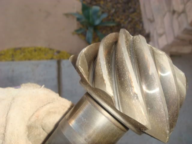

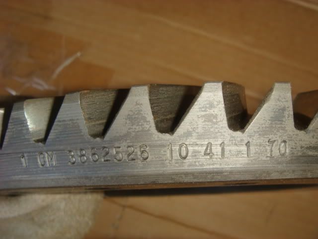

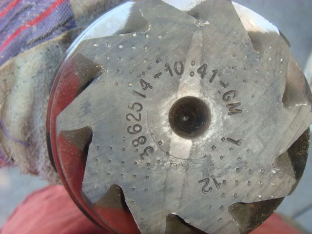

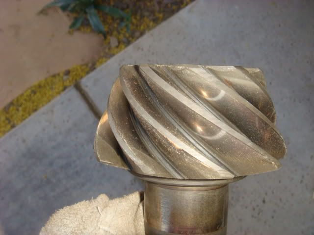

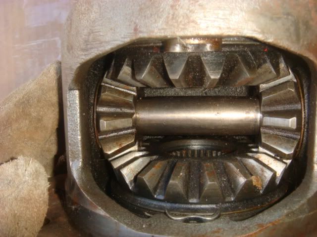

OK guys, finally got some pics of my 4.10 gears & posi unit. Any ideas what it dates out at? Looks to be GM? Thanks...
pics:
http://i256.photobucket.com/albums/h...R/DSC02407.jpg
http://i256.photobucket.com/albums/h...R/DSC02408.jpg
http://i256.photobucket.com/albums/h...R/DSC02409.jpg
http://i256.photobucket.com/albums/h...R/DSC02411.jpg
http://i256.photobucket.com/albums/h...R/DSC02414.jpg
http://i256.photobucket.com/albums/h...R/DSC02413.jpg
http://i256.photobucket.com/albums/h...R/DSC02412.jpg

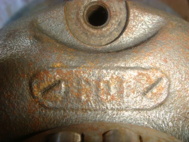

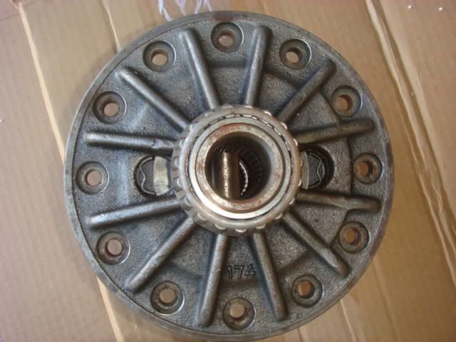

Posi:
http://i256.photobucket.com/albums/h...R/DSC02415.jpg
http://i256.photobucket.com/albums/h...R/DSC02416.jpg
http://i256.photobucket.com/albums/h...R/DSC02417.jpg
http://i256.photobucket.com/albums/h...R/DSC02418.jpg
Mr70 04-08-2012 03:39 PM
Re: 4.10 ring & pinion, revisited...GM?...pics
That planetary case was used on any Chevrolet vehicle w/4:10,4:56,4:88 during 1966-72.
Can't make out the date too well,but looks like it's upside down,and maybe I 69,for September 6th,1969.
The ring & pinion go together & were installed on any 1965-69 Chevrolet vehicle w/4:10,and all 1970-72 Chevelle/Elcamino/Camaro w/4:10 too.
Showing a date of January,1970 on it,it most likely came in one of the later,or was sold OTC back then.
Fast67VelleN2O 04-08-2012 04:21 PM
If you look closely, the pinion iis dated December of 1969.

iluv69s 04-08-2012 11:33 PM
I believe the posi would have a date stamped in the edge of the flange that the ring gear bolts to. Should be some single digit letters stamped there.
