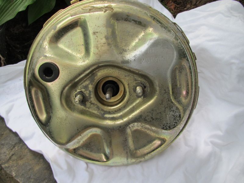

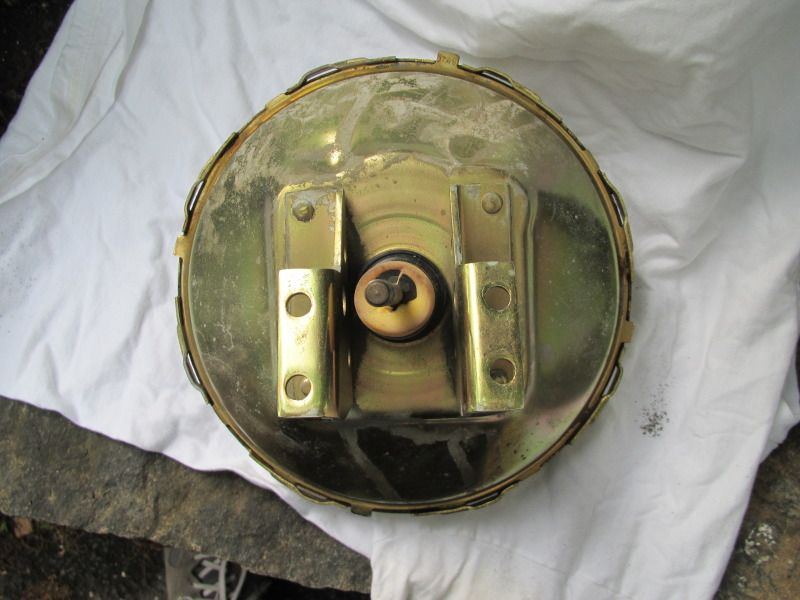

Can you guys tell me if this is an original booster or a reproduction.
Thanks,
Dave
http://img.photobucket.com/albums/v4...6/IMG_2276.jpg
http://img.photobucket.com/albums/v4...6/IMG_2277.jpg
http://img.photobucket.com/albums/v4...6/IMG_2278.jpg
enio45 05-31-2012 03:50 AM
Re: 1969 Camaro Power Brake Booster....
0749 is not a 69 camaro for sure!
not sure what it is and if it was a 69 camaro the Delco stamp should be on the other side upside down.
m22mike 05-31-2012 10:57 AM
Looks like a OE unit to me. Not all were stamped 180* and upside down. Some were not stamped all. EZ to spot a Chi-Neez one. half the cars restored now have the El cheepo ones installed.
Easiest way to tell is to compare the "Triangle shaped stamped in stiffeners. The repops are very sharp at the bottom with a distinct hard line, the OE ones have a nice smooth radius.
Next time you watching a auction on TV zero in on the under hood shots, you'll be amazed. [img]<<GRAEMLIN_URL>>/shocked.gif[/img]

I've also noticed that the &quot;DELCO MORAINE&quot; is very crisp on repos and somewhat less distinct on OE. I too have seen upright/right side &quot;D..M..&quot; stamps on correct OE boosters.

Check out the &quot;O&quot; in Delco. Repops have a rounder O.
Mr70 05-31-2012 02:12 PM
That's true,among other subtleties.
Vintage used an 0.
Todays Repro uses an O.

enio45 05-31-2012 02:31 PM
what is an 0749 booster......am i confused?? Thats not the date, correct??
MosportGreen66 05-31-2012 03:34 PM
Eddie - seems like its a 1967/1968 booster for a power assisted drum brake car? Was there even such thing?
