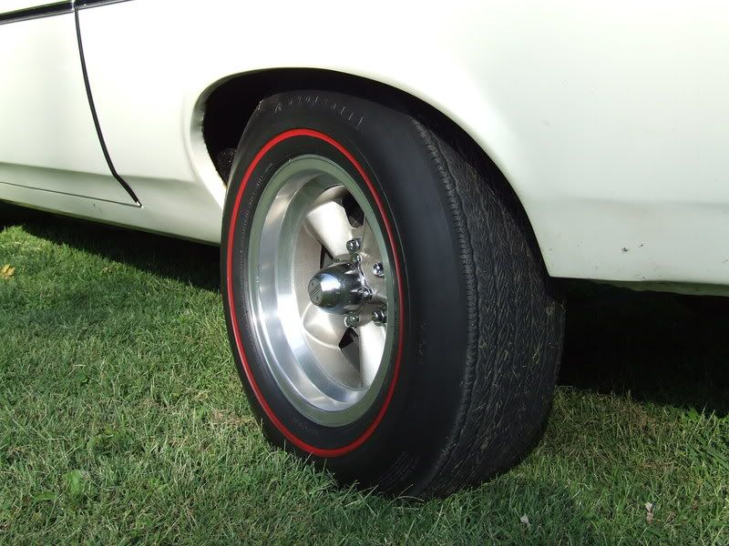

68l30 06-28-2012 10:33 PM
Re: Restoring Original American Racing Wheels
1 Attachment(s)
Pic..
mockingbird812 06-28-2012 11:34 PM
Whoa Big! Very snappy!!! [img]<<GRAEMLIN_URL>>/drool.gif[/img]

Salvatore 06-29-2012 02:26 AM
<div class="ubbcode-block"><div class="ubbcode-header">Originally Posted By: 68l30</div><div class="ubbcode-body">Pic..</div></div> Man that is a nice car Steve!
m22mike 06-29-2012 11:06 AM
Sam it's a beater... [img]<<GRAEMLIN_URL>>/naughty.gif[/img]
https://www.yenko.net/attachments/use...6-dscf8257.jpg
mockingbird812 06-29-2012 11:11 AM
[img]<<GRAEMLIN_URL>>/drool.gif[/img] I like this &quot;beater&quot;!!!!!

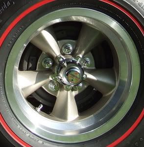

bergy 06-29-2012 11:13 AM
I prefer a higher polish on the machined surface - Ned recommended the polisher. Cast surface is lightly cleared so that the brake dust can be cleaned off. Car's not ready for them yet though.
https://www.yenko.net/attachments/use...-img_20961.jpg
