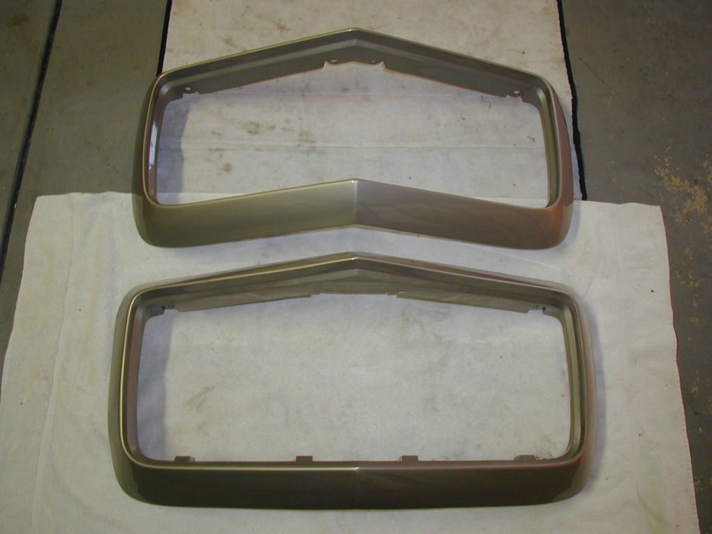

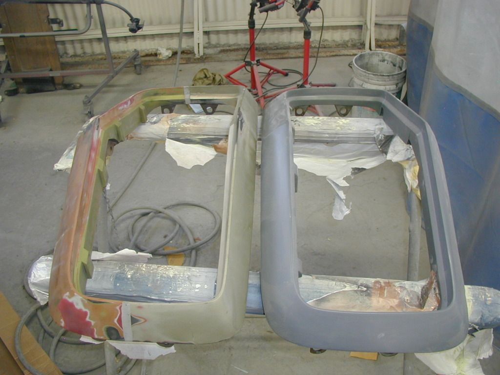

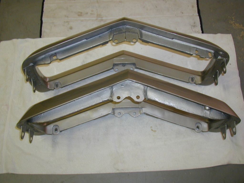

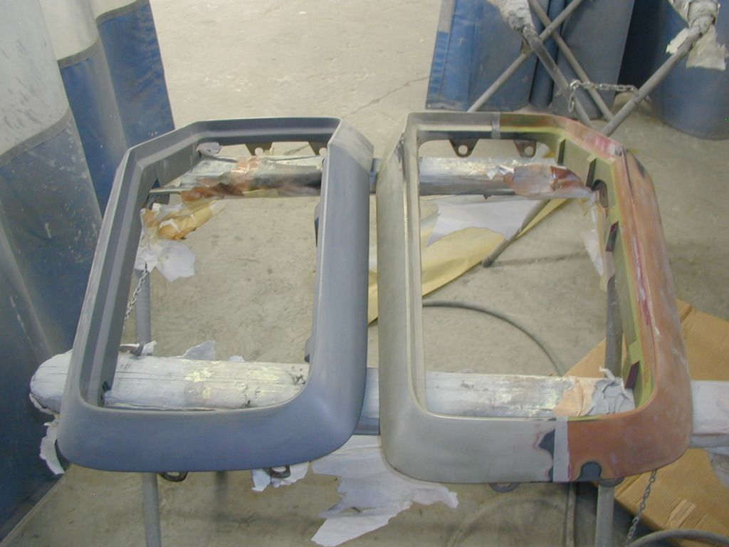

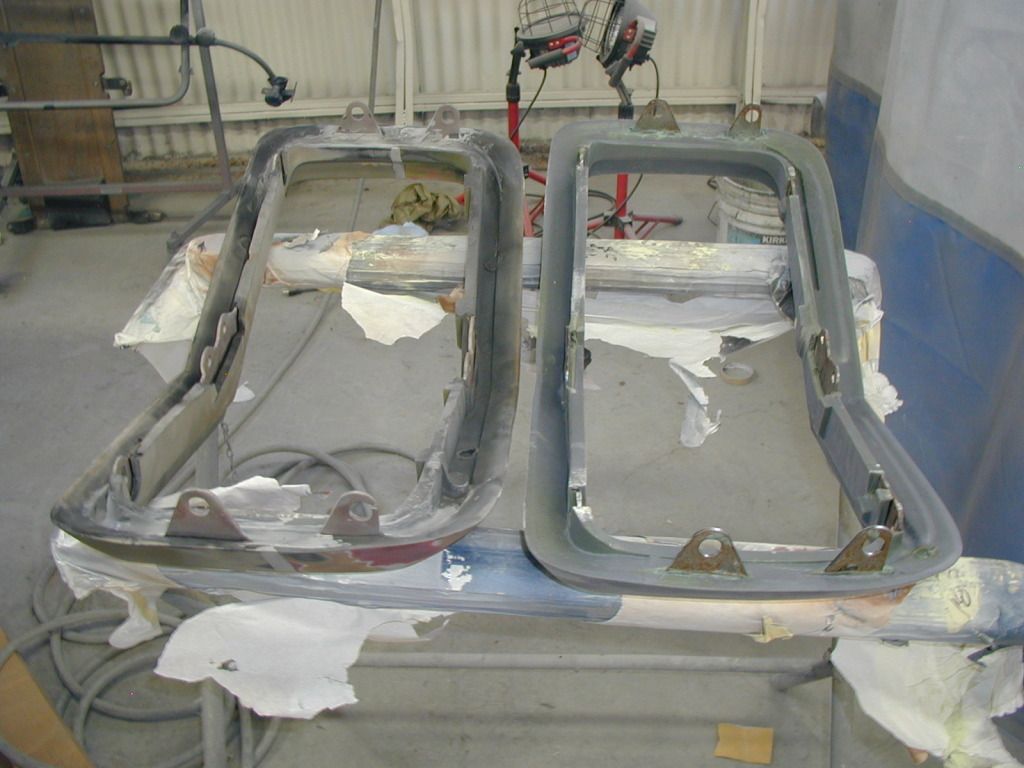

For one of my last restos, I spent a couple of years trying to get a NOS nose with no luck, so I purchased a repro out of frustration. Actually it took three repros before a decent one arrived. Still not happy with that one, I did a little experiment. Using the upper half of an RS nose from my 72 Z (which got bumped on the bottom) and the lower half of the RS nose from my 70 Z (which rusted out on the top for some reason), I created one good sort of OEM RS nose that is better than the repros. See my pics for some fun. Us car guys will try just about anything sometimes...... Charlie
