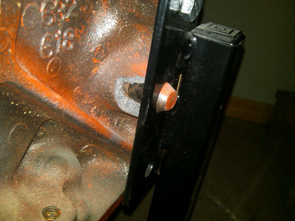

kind of urgent on this - it's a pic of a block from a car on ebay I am very interested in and getting ready to pull trigger on - long story, short - is there a chunk of metal missing from back of the block webbing? see bottom right corner of pic by black bar(engine stand):

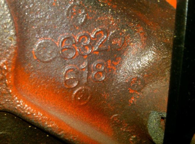

x77-69z28 12-10-2012 03:25 PM
Re: 1969 Z28 eBay block pic
That's what it looks like to me. Also I have never seen a block casting number like that before. Post the link, so we can look at the rest of the pics
Fast67VelleN2O 12-10-2012 03:28 PM
Hi,
That is a damaged block for sure, but it may be repairable depending on the extent of the damage. According to Jerry's report on that car, the engine is a restamp as is the transmission.
-Matt
Tracker1 12-10-2012 03:36 PM
NEW EMAIL from the owner (he did not volunteer this info, even when we agreed on a price):
"That happened by me when I got the engine from the guys. It bumped into the trailer while it was being loaded. I have the piece."

Fast67VelleN2O 12-10-2012 04:38 PM
Thats an oil passage so it would be an easy repair and hidden by the bell housing.
Tracker1 12-10-2012 04:54 PM
<div class="ubbcode-block"><div class="ubbcode-header">Originally Posted By: Fast67VelleN2O</div><div class="ubbcode-body">Thats an oil passage so it would be an easy repair and hidden by the bell housing. </div></div>
easy repair epoxy or easy repair weld?
NEW PIC FROM OWNER:
http://i962.photobucket.com/albums/a...1210-00189.jpg
Fast67VelleN2O 12-10-2012 05:08 PM
Oops, I was wrong, not an oil passage, was thinking it was another part of the block. Just the dowl pin hole. Easy weld repair in my opinion. Whoever would use epoxy there isn't very smart.
Tracker1 12-10-2012 05:32 PM
<div class="ubbcode-block"><div class="ubbcode-header">Originally Posted By: Fast67VelleN2O</div><div class="ubbcode-body">Hi,
-Matt </div></div>
According to the owner the transmission in the pic of the ebay auction is the trans that was out for re-build when Jerry came to look at the car in '09. The VIN down by the oil filter is not a re-stamp - seems clear to me it's the matching numbers block, even if the pad itself is a re-stamp...and Jerry has verified that VIN as a Z28 sooooo...
Stefano 12-10-2012 06:09 PM
The &quot;3&quot;s on the engine stamp have a flat head while the &quot;3&quot;s on trans have a round head.
