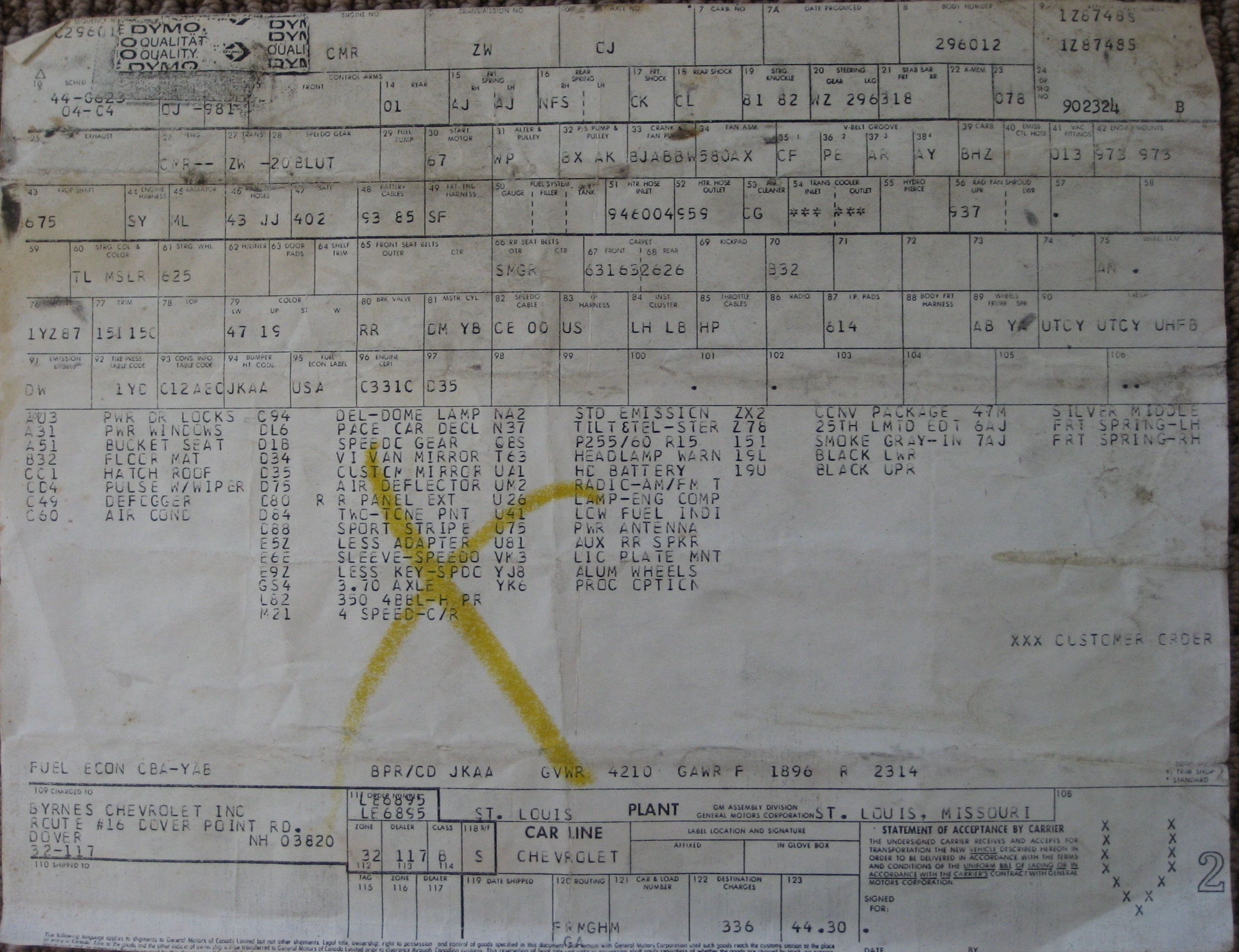

Hunt4cleanair 08-20-2013 05:20 PM
Re: Buildsheets
The manifest below is what I am referring to as the GMAD landscape style buildsheet introduced in 1973 at the St Louis assembly plant. These were glued to Corvette gas tanks during chassis buildup.
http://www.hunt4cleanair.net/Images/VIN_2324.jpg

Hunt4cleanair 08-21-2013 08:50 PM
Re: Buildsheets
Help me out here...what on the buildsheet tells us its a COPO? I see Albert lists 9566AA.
firstgenaddict 08-21-2013 09:48 PM
Re: Buildsheets
Engine Code Rear end Code are unique to COPO's.
bbbenny 08-22-2013 11:31 AM
Re: Buildsheets
Not to steal the thread. I have a broadcast sheet on my 69 COPO camaro. The only place on the sheet that shows anything, is in the bottom left of the sheet. By itself, is 9651BA. And my car is a automatic car.BBBenny
